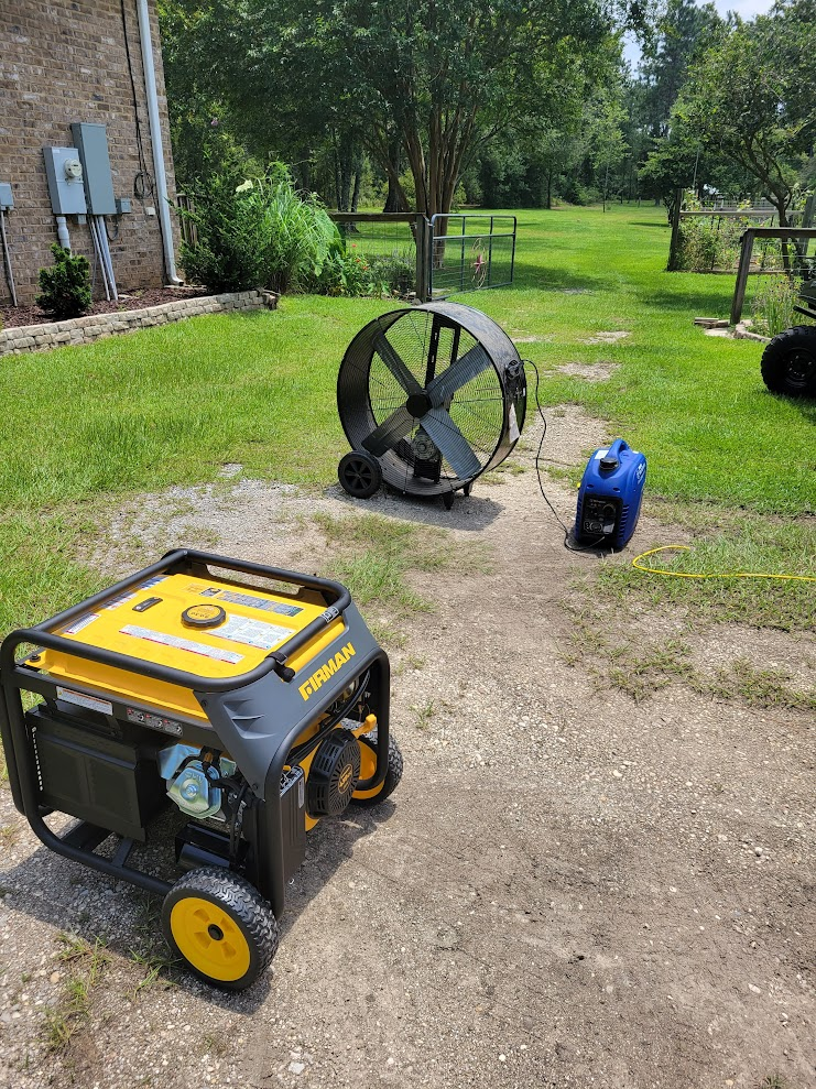

Agreed, I'd like a small load bank, but have not seen those in consumer/homeowner size.
I was contemplating the 1.5kw immersion heaters, but they'd be single use.
Instead, I recently bought 1.5kw small heaters. These are only $15 and I can use them in an emergency if need be to heat a small area. They have 3 settings and I measured them very close to 500w, 1000w and 1500w. We are in lower AL, so we don't see real low temps.
I'll probably run a fan across them as I'm using them for a generator load.

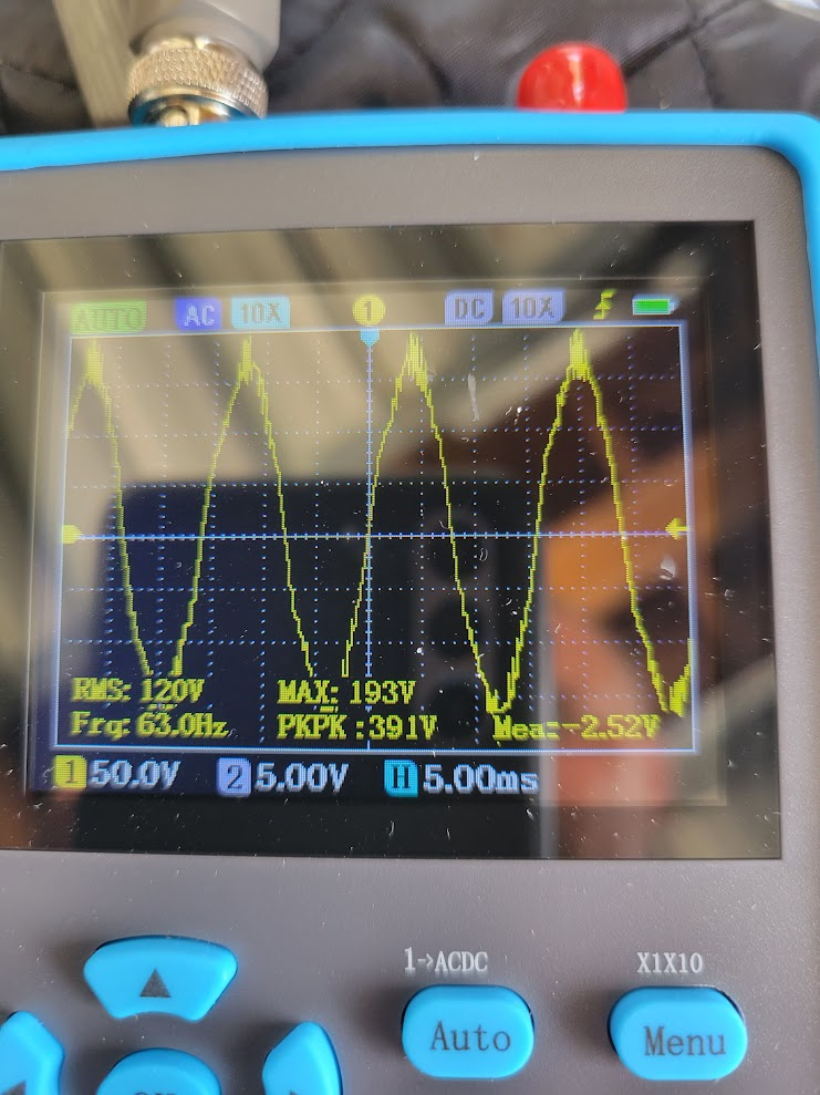

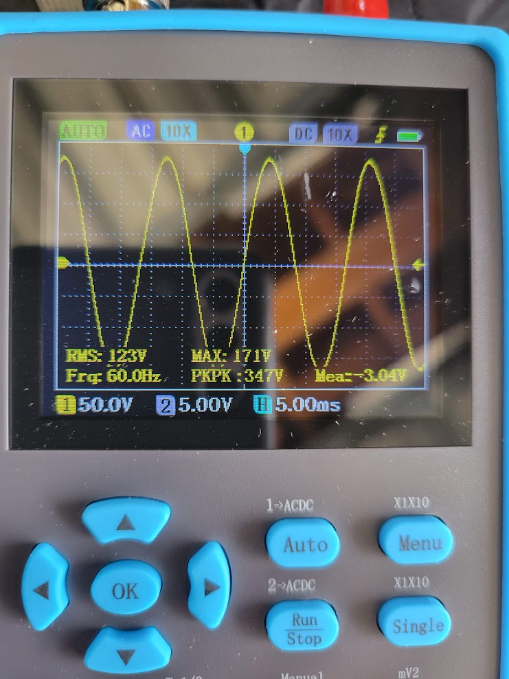

Testing last year pre-hurricane season, which is coming up again quick. Hoping to upgrade to a large inverter generator for cleaner power. I have a small inverter generator for overnight use, but do need a large unit to run the grinder pump and water heaters, etc,
Open frame conventional generator
Little inverter generator
