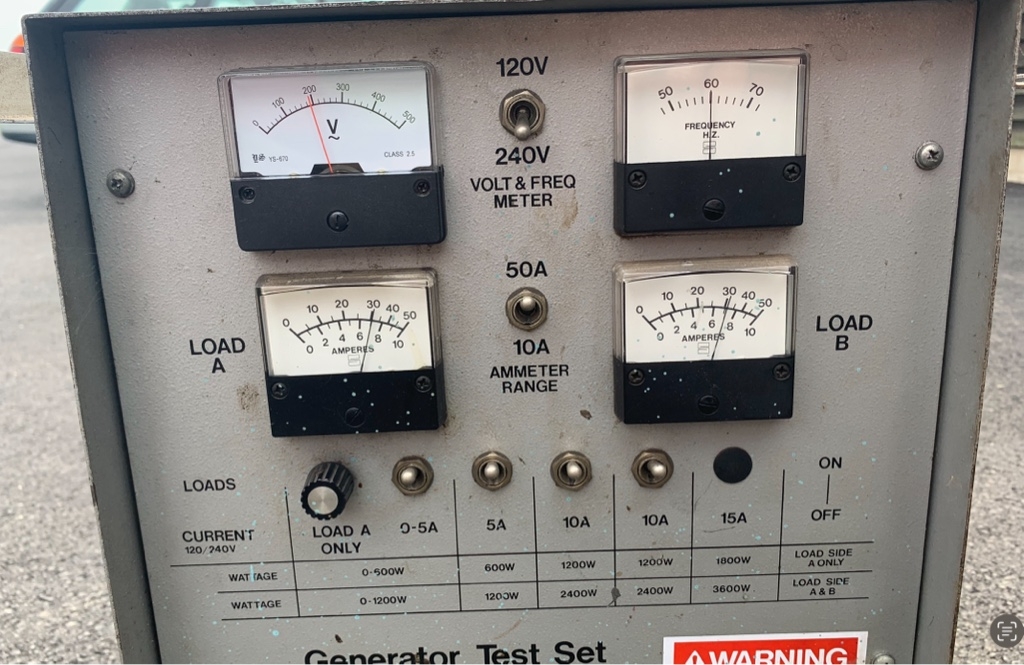

Understood, @ Load.
Perhaps also a large enough pail to sit a 30#'er into hot-water for the short test ?
Rgds, D.
That's a standard work around for blacksmiths on gas forges. They freeze up due to rapid use too. As long as it's warm not boiling your fine. Some use a torch or heater, but that's pretty dangerous. If it's just a short test like 5-10 minutes you probably won't need to bother with anything
/ Your last generator Maintenance Run
#7,915
Makes sense (not the torches etc....) . Increase in tank area (@ Cold Ambient) is one reason for dual-manifold tank setups, ie. on RVs, and IIRC, somebody built one on here for their small gen.
I understand some of the general thermodynamics, and have seen my HVAC buddy do same (water/pail) with refrigerant.
d seems to have found a good deal, and may have been working fine when pulled, but nothing beats actual operation and check of fundamentals....
Rgds, D.
