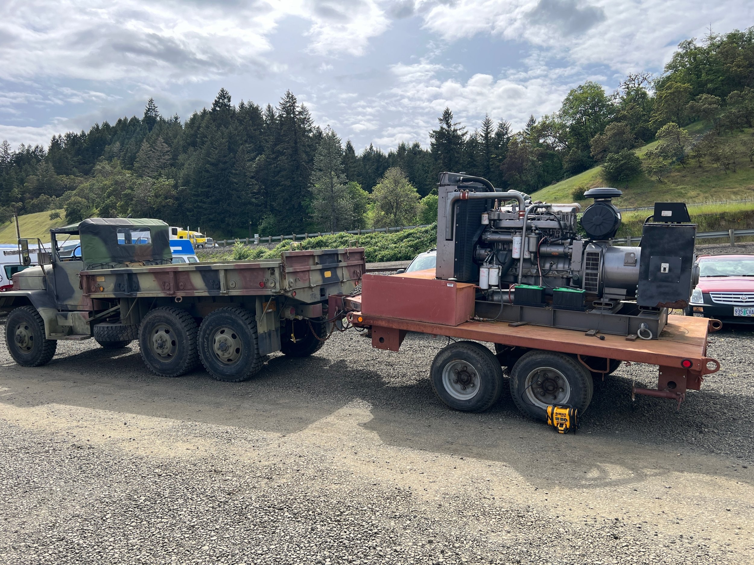

Yes, that trailer was quite a score as well.
That whole setup is heavy. The old deuce didn’t like pulling it up the hills very much!

Finally found a suitable back up power source for my machine shop. A local municipal agency sent this to auction and I picked it up for what I feel was a steal. 325KW, 3 phase. Total hours are just under 600.
We are right in the middle of forest fire country, so the planned outages are happening more and more. A few days without power really impacts us and our customers.
It’s supposed to rain like crazy this weekend, so I plan on getting this serviced and put thru some load testing.
All that power and look at the air compressor next to the tire!

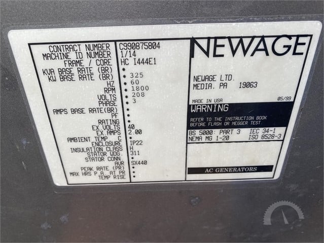

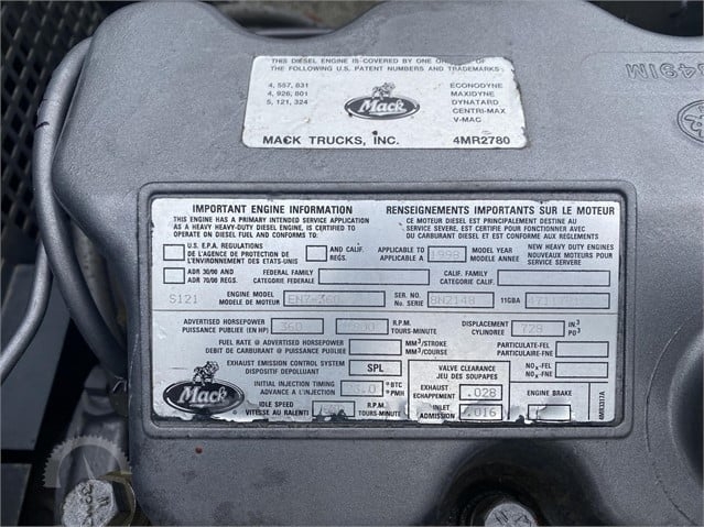

   / Your last generator Maintenance Run #6,678
Very nice but 325kw / 360hp doesn’t add up!
90cummins
Here are the tags from the engine and generator head. I'm only able to go with those #'s until I can somehow load test.
   / Your last generator Maintenance Run #6,679
90 carries those #'s better in his head than I do.... but I was initially thinking Peak Pwr, when I saw his comment....
Rgds, D.
It does seem likely it's 325KVA, which would bring it to about 260KW using a .8PF if I'm doing the math right?
#6,680
Thanks for the pics OR ! We like pictures.....
I'd have to start by looking up "Base Rate", as I don't play at these power levels..... poked around a bit just now.... not sure if that term is in current (pun-intended) use..... might have to wait for one of the Commercial guys like CM to drift by for a historical perspective......
W/O a calculator, you math looks about right.....
(from when I went looking,.... a cold-start on a 500 KVA.... don't show this to your Sierra Club friends !)
https://electrical-engineering-portal.com/important-generator-set-rating-considerations
Rgds, D.
