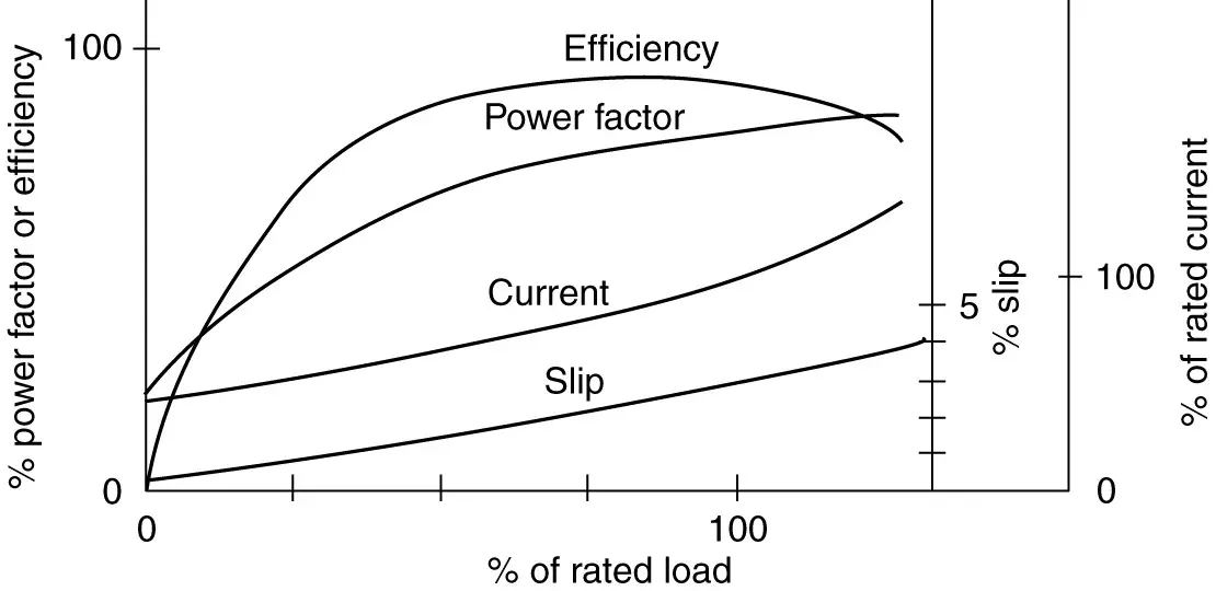

I'm an electrical engineer, so while I lack the practical experience of your BIL, I can back what he's saying with good theory. The efficiency of a three-phase motor remains pretty flat (and pretty good) down to below 50% of rated load. So, if your compressor is creating a load of at least 7 hp, the 15 hp and 10 hp motor will have similar current draw when driving that load. Current is linearly proportional to load, when efficiency remains flat.
However, if you were spinning that compressor on a 10 hp motor at half voltage, then perhaps it requires less than 7 hp, at which the efficiency begins to drop on the 15 hp motor, causing it to draw more current than a 10 hp motor.
