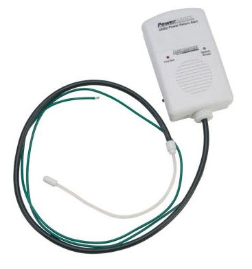

Well, I had a forced 'maintenance' run yesterday. We had quite a wind/rain storm and we lost power for about 8 hours. It was nice that the power went out during the daylight so I took the opportunity to have the wifey do the switch over using the mechanical interlock on the service panel, turning on the electric start Honda gen, and flipping certain breakers back on for gen power. We enjoyed a semi-roughing evening by the fire and TV and limited lighting. My only issue is that I have to call the neighbors each time and ask them to let me know when the power is back on because I don't have a way to tell or be alerted otherwise. So, my gen got a good work out and wife is more prepared for when I am gone! :thumbsup:
   / Your last generator Maintenance Run #749
You need one of these!
PowerBack Utility Power Return Alert, Reliance Controls Model # THP108 ~$30
I have one and it works fantastic.
