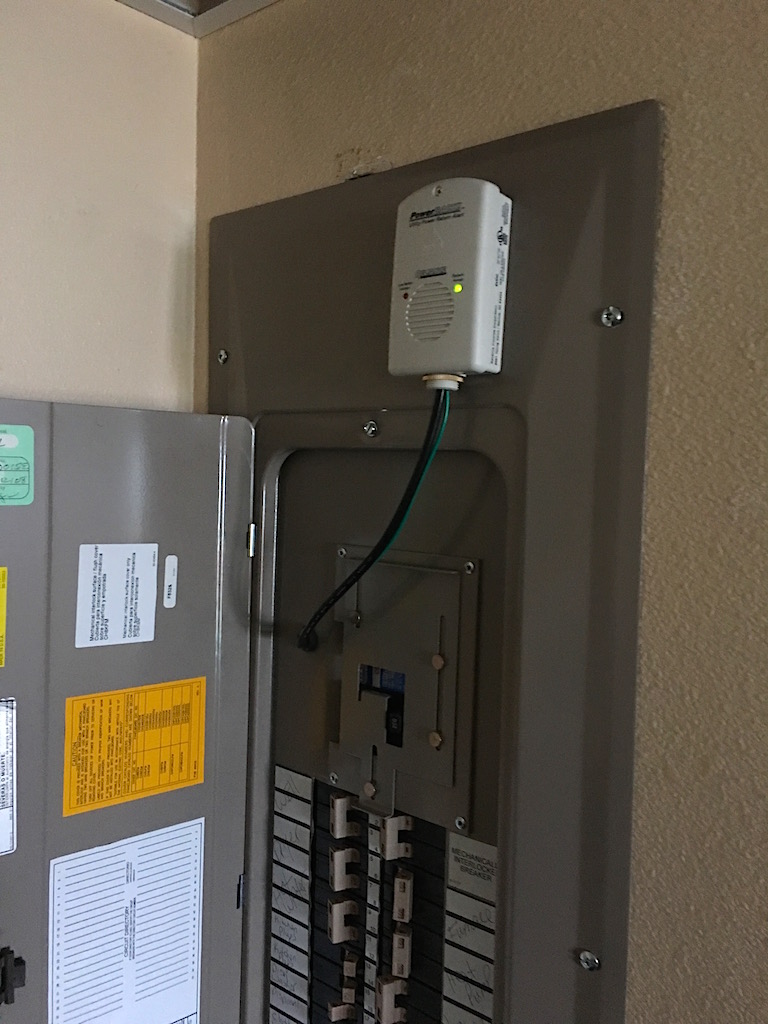

Okay, update and timing is everything! We lost power again this afternoon. Another big wind/rain storm. I asked the better half to again learn how to go 'off the grid' switching over to generator power and she is getting it. I think the third time will be the charm. Anyways, also took the opportunity to install the 'Power on indicator alarm' while the power was out. About 12 hours now and the generator is purring, we got lights and refrigerator and TV, propane fire heat, a warm comforter, and each other. Hoping the alarm will be audible one floor above.
Here is a picture of alarm. Had to drill a hole through the cover panel. Fashioned up a grommet. Not sure if that is code. I can still shut and latch the access door but might make a tweak there to help it close better.

Now I just have to wait for the power to come on to see if the alarm works and I can hear it!

Should have used a 90 on the bottom of the indicator unit and went straight into panel. Can't have the cord jammed under the door.

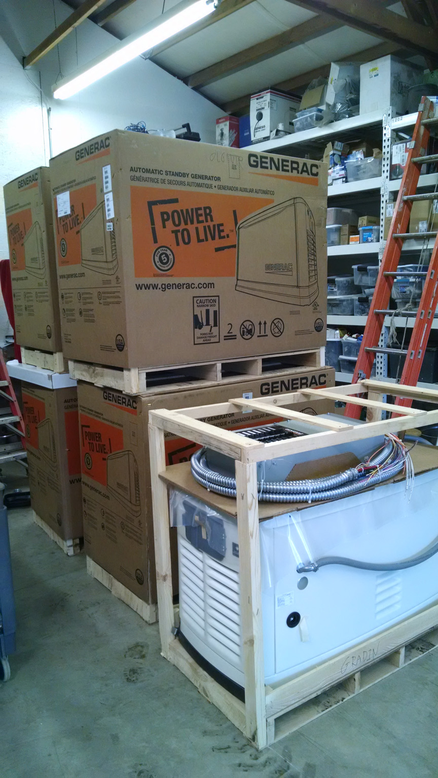

Spring is here.....IMG_20160310_094338755.jpg... first load. 4 more on the way.
now it needs to stop raining so i can start some installs
You sure are getting good use out of your Honda !
That alarm looks like it has just a sensor wire, and a ground wire - correct ?

Spring is here.....View attachment 460844... first load. 4 more on the way.

Yep! Alarm worked. Yep just a sensor wrapped around one of the incoming hots and a ground attached to the ground bar. Power came on again late this morning. Problem is I couldn't hear it upstairs. Looks like I am now in the market for a baby monitor! Thought I was done with such gadgets. :eek: :laughing:
I probably will eventually hard mount the sensor with an elbow as suggested but I was impatient.

It's not a ground wire, it's a neutral conductor.
