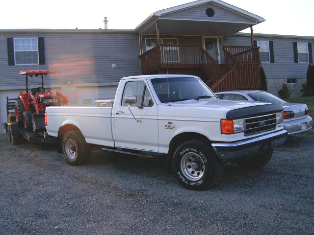

A lot of 10 y/o trucks around here don't look anywhere near that good !
Rgds, D.
Thank you.
I spray under the truck with oil every year (for the past 20 years that I have owned it).
Still in great shape. No rust and it runs in the salt and calcium they put on our roads in the winter.
