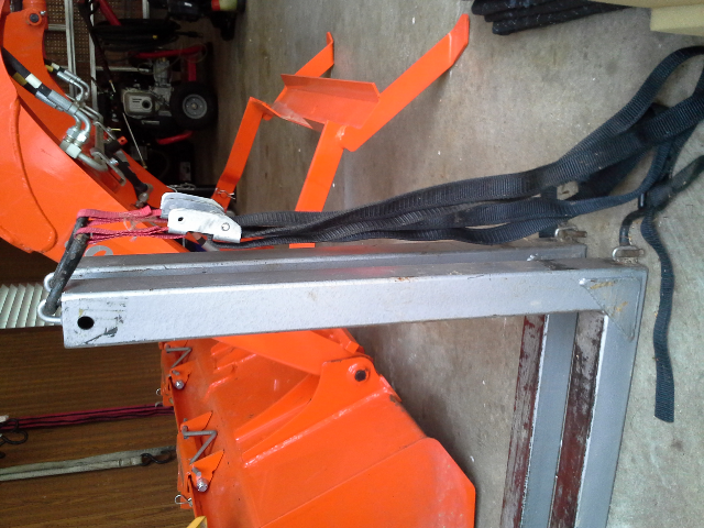

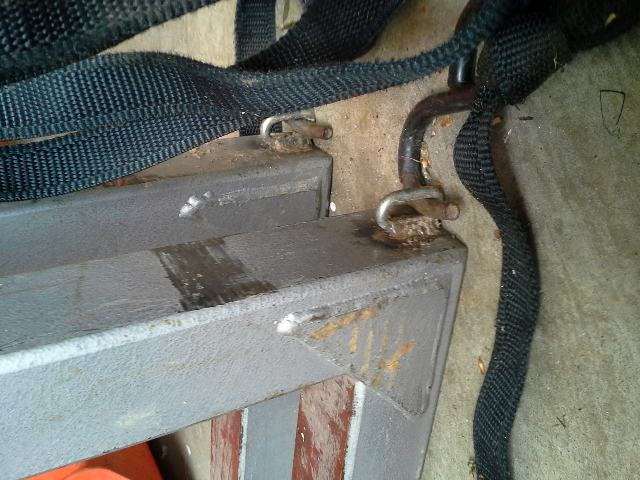

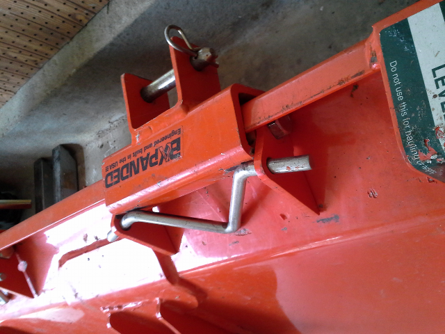

I welded one link of chain on the bottom of my bxpanded forks. I run a tie down from there around the bucket and to the one at the top that comes on them. They are sturdy, I have used them to hook a chain on to pull tractor out when stuck.

TJbeck93 - Thanks for the pictures, especially of the clamping mechanism. I like your idea of welding a link on the forks - I'm going to have to bribe my neighbor into a a wee bit of welding.

As a separate issue I did receive a reply from Harry to my questions:
1) Have you established a per fork weight capacity?
The forks are stronger than the loader. We never heard of a bent fork or bucket. We rate the forks at 600 lbs per pair, at 12 from the base.
2) Is there an easy way to service the clamping mechanism/spring holding the forks to the bucket lip? Please excuse the question but I have heard of people occasionally losing the spring out of the clamps. If I am mistaken please accept my apologies.
There is a very easy adjustment if the clips get loose.
3) Would you be willing to provide a width measurement for the clamps? My reason for asking is that one of my bucket hooks is attached just to the inside of the level indicator and I would like to know how much that will offset my placement of the forks.
The clamps are approximately 7 wide. The outside edge of the fork would be about 3 from the hook. The bracket will fit outboard of the level indicator.
4) I know of one gentleman who had issues with Kubota having changed the bucket lip design on his bx25 and as a result you were gracious enough to work with him on providing a solution. Is there a way to determine in advance if this is going to be an issue? Or have you been able to make adjustments to your clamps so that Kubota's changes are not problematic?
The bucket aberrations have not shown up on any of the BXs except the BX25. It shouldn't be an issue on the BX2350.
I am going to go ahead and place an order with Harry for a set of forks. From all reports it sounds like he has an awesome product that will fit my current and future need. I do greatly appreciate everyone's input and all of the good ideas and products that have been suggested.
