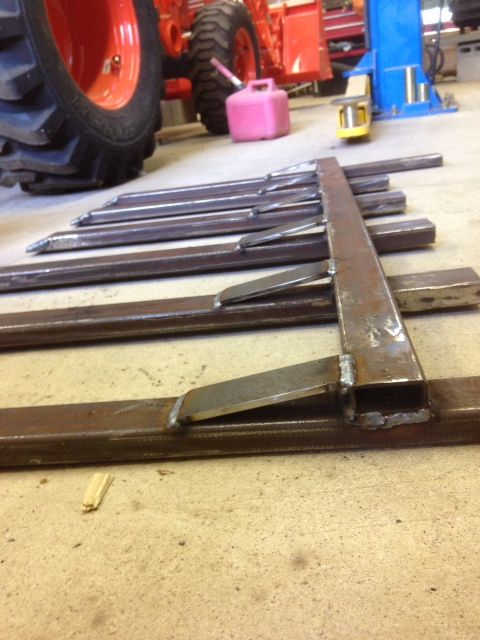

A note about placing a clamp outboard of the level indicator.
I found that on mine the clamp is a VERY tight fit between the indicator and bucket edge. It did just fit in there, but then the v-bar thing would not fit in. I was able to just cut off a short piece of one side of the v-bar end and get it to fit past the level indicator and into the clamp.

Thanks for the advice. Very timely as well - it made me go double check my bucket hook locations and double check my thinking. I was going to follow your example and purchase 4 forks so that I could place two outboard of the loader arms and two inboard when moving brush. Its a good thing I checked before placing an order. Turns out I put one of the bucket hooks to the outside of the level indicator and there is no way a fork clamp is going to fit there now. So I placed and order for 3 forks and we'll see how that goes.

Hmmm. I don't have any finished pics of my setup but here they are nearly complete. I added a 3/4 round bar that the bucket edge sits under and 2 top braces with 5/8 bolts that just screw down into the bucket. I decided against tools and welded some rod to the top of the bolts so I can install these in seconds by hand.

Man that looks like it will work very nicely once you get them finished up!
