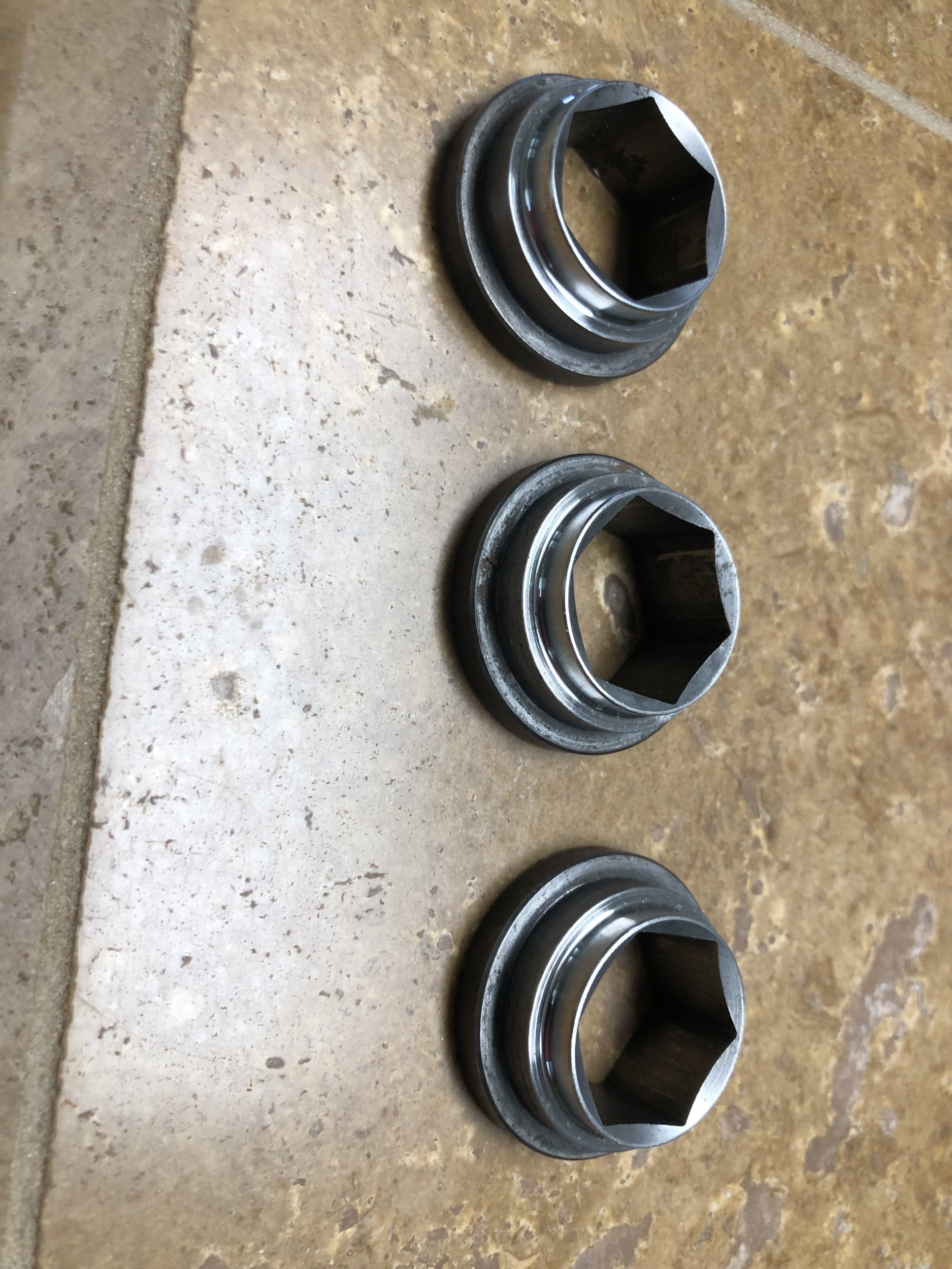

One more pic to clarify:
SOLD
I have an extra set of these machined down blade adaptors IF anyone is looking to put the older good Pro Deck 1-1/8” center hole blades on their newer ACS side discharge deck ?
Go back to post #38 & 39 of this thread for gonnasellit info & pix
——— SOLD ———

I’m running the older pro deck hi lift blades with modified boss adaptors like mentioned in previous post to fit 1-1/8” CH
