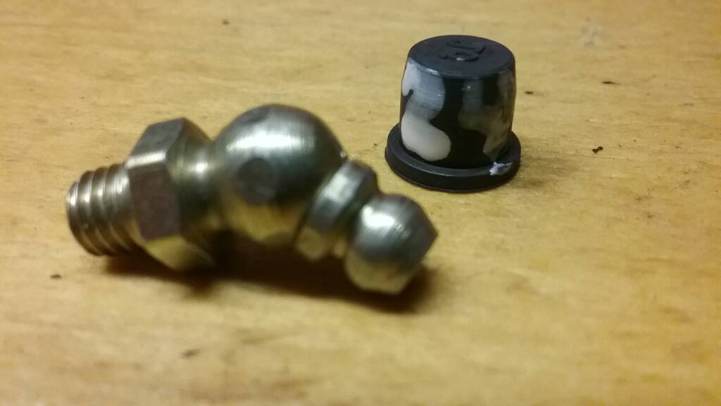

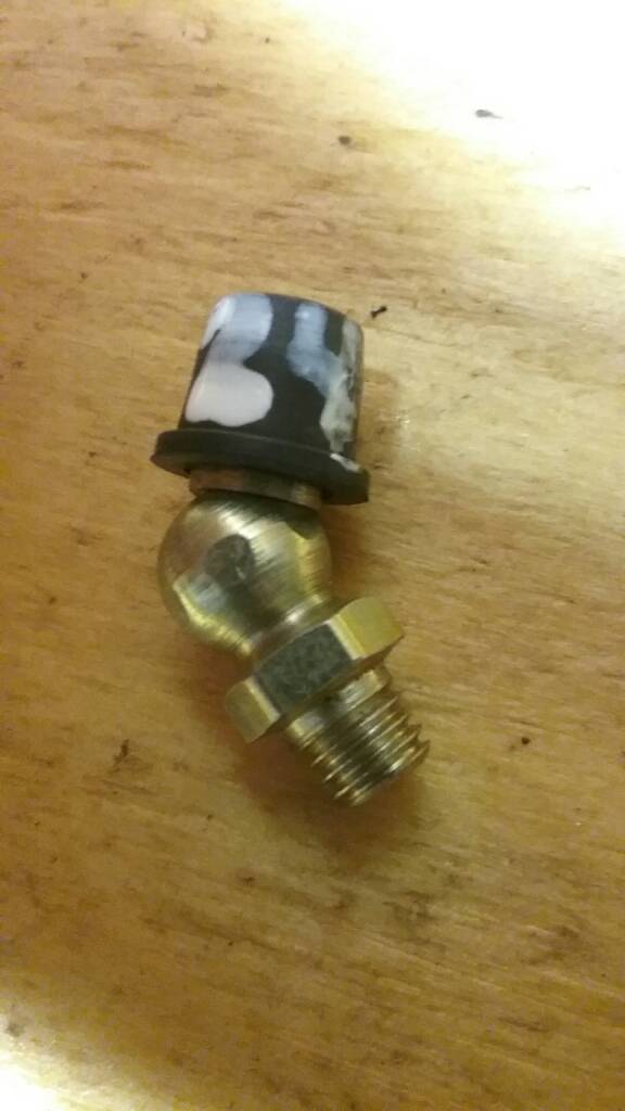

I ordered 200 of these locking rubber zerk fitting caps from eBay...
They lock on, can't fall off. My thought is it keeps dirt out.

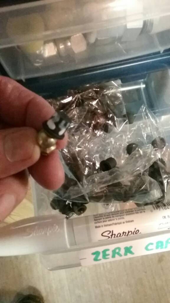

Then I bought a white paint Sharpie pen. It's hard to keep track of each piece of equipment but, say, a tractor has 32 grease fittings. I write 1 through 32 on 32 caps. Then near one zerk I write 32. As I lube it I know when I haven't overlooked one.

My thoughts on this is that the ball on the end of the grease zerk is there to keep the dirt out. One swipe with the gloved that I'm wearing and it's clean enough to grease.
The thought of pulling off a cap and replacing it every time I had to grease... I have better things to do with my time.
The numbering idea is a good one. I've greased my own equipment enough that I have most of the locations memorized. I would just take a felt pen and write the numbers close to each grease zerk.
So if you have 32 zerks, what keeps you from quitting at say 30 if you forget about the last 2?

Yep, put those rubber caps on every zerk on the tractor, loader and BH. Then I liked them so much, put them on the finish mower zerks too. Very nice at keeping all the dirt/dust off, ready to grease!
OH, I also wash AND wax the tractor!

I like the idea as well. I did buy the yellow covers that helps me locate some of the hidden zerks on both my tractor and my lawnmower. As mentioned, the zerks themselves are made to keep the dirt out, so that feature is redundant, i.e. no real benefit.
I will note however, that the zerk covers don't last very long before they no longer snap on, and I tend to lose them sometimes while doing my grease chores. But they're cheap, so that's not really a worry.
