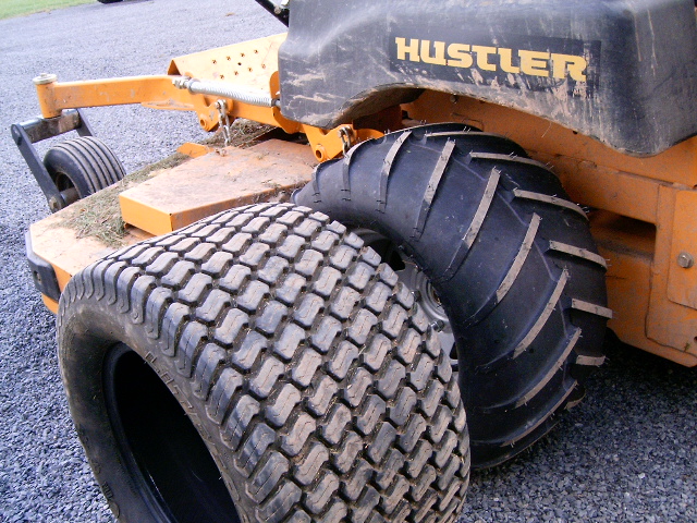

I went from a turf tire on my Hustler Super Z to bar tires (Chevron AT 101) and it made a HUGE difference in traction/control on hills.
The turfs were awful.

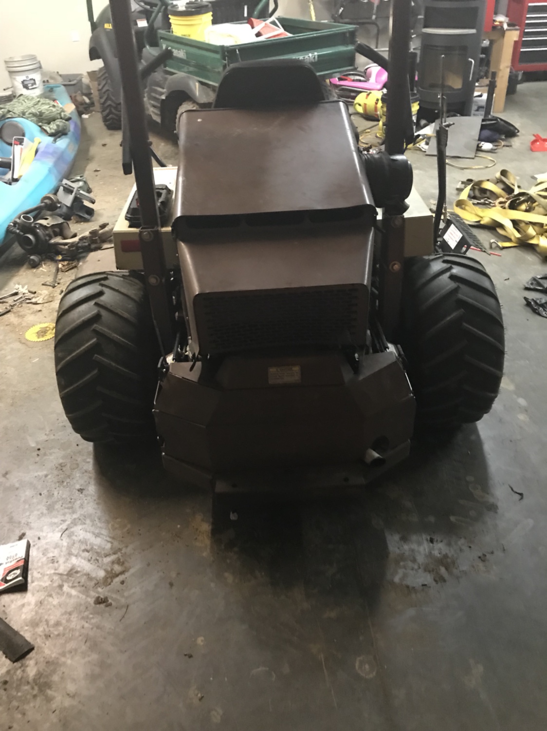

Take the turfs off and throw them in the pond where they belong. Maybe the fish can use them. I have bar tires on mine and it makes a huge difference. IMG_1803.JPG
