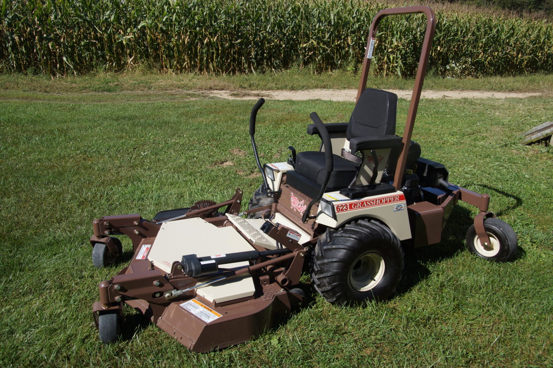

ZZZ2017 Grasshopper Front Mount.JPGThis is the second season for bar tires on my Grasshopper. When I bought the machine it had bar tires on but the dealer said he would switch them for turf if I so desired. Decided to stick with the bars and now look back and realize for my lawn that was a mistake. No matter how careful I turn it can tear up the lawn and they leave indentations on the lawn where it is moderately soft.
Just a note on the Grasshopper, roughest riding mower I have ever ridden. Had a Ferris for 12 yrs and that machine really spoiled me. What the Grasshopper needs is a suspension seat but they are costly. Otherwise they are well built and give a quality cut.
