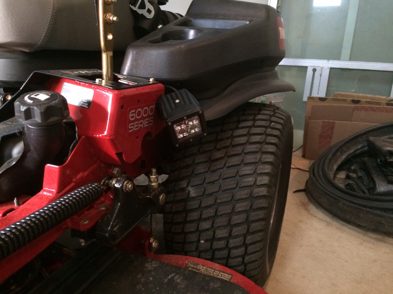

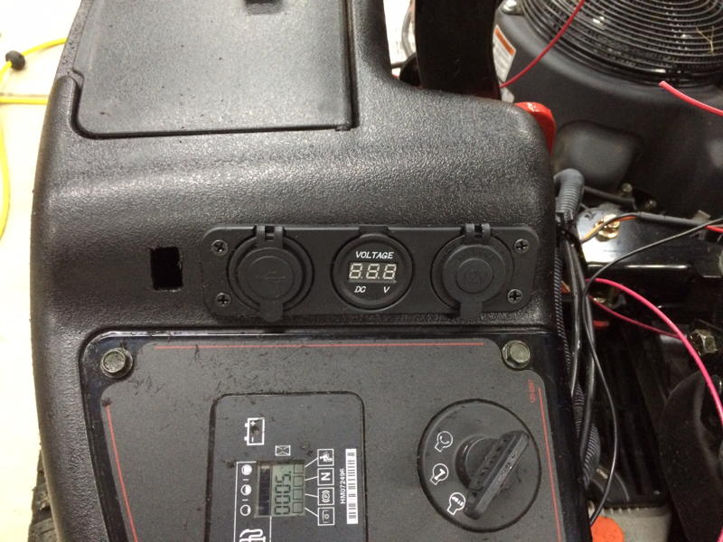

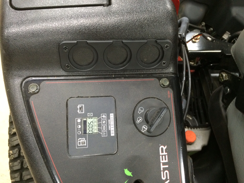

After exploring various forums on the Internet, I was not able to find a whole lot of posts where people were customizing their zero turn mowers. Of course, there is always 4Shorts on this forum who can (and does) customize just about everything and I will probably borrow from him once again with his zero turn customized rear bumper/hitch. But other than Paul, it gets pretty thin. When you search the lawn care sites, it's all about making money - which I completely understand! But for me, investing in a high end commercial zero turn mower is all about time, enjoyment and never wanting to buy another mower!! So ....., after many months of research, I landed on a Toro Z Master 6000 series commercial mower. I mow about 5 acres and sometimes up to 10 acres depending on a share-the-work program I have with my neighbor since we jointly own some nice property along side our lake that we use for recreation.
Now, on to the mods. The first question my wife asked me was "why do you want to mod your brand new mower?" She actually should have known better since I've done a bunch of mods to my Kubota Grand L3540HST. For me, it's all about making the machine MINE! Adding those extra features and conveniences that really turns a utility machine made for the masses into a one-of-a-kind, personalized machine made just for me. AND ....., like I said above, I plan on owning this machine for many, many years to come.
So, where to start? For me, it's lights and electrical accessories. I started getting things mounted and tested this morning, but I'm still waiting on my side lights to arrive before I complete all the wiring. Here's a few pics to show what I'm up to.

Well Thomas you brought me out of hiding because I had to tell you just how cool your install is. Love it. Looks oem. Nice looking ztr as well. Looking forward to seeing more of your mods. As for modding stuff. I can't resist. There's always an improvement to be made with everything.
Have a great weekend my friend.
Paul

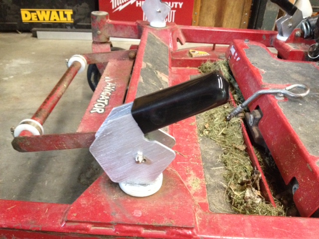

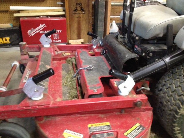

The deck height on my Exmark Navigator was hard to adjust consisting of pulling a hairpin cotter and moving to an adjacent hole on each of four adjusting posts while supporting the weight of the deck. I made the four pair of adjusting cam/handles out of 1/8" aluminum on my CNC router. The stepped cam lobes provide a range of four deck heights with a UHMW washer under to ease adjustment. This hand adjustment of each of the four corners pales in comparison to single point adjustment on many mowers but is much better than the stock method. Adjustment consists of grabbing the black handle and rotating the cam to the desired position. (times four places) Dropping one side of the deck temporarily for mowing along a curb, for example, is a fairly easy process.
npalen - that is one heck of an engineering effort to overcome a challenging factory design. Boy, they must have thought people only adjust their deck height once or twice a season! I'm glad the new designs have made the whole deck height adjustment a lot easier. Although mine is a mechanical approach with a single pin, many of the new machines have a dial that allows you to dial in your desired cutting height and away you go! Nice job on this mod!!

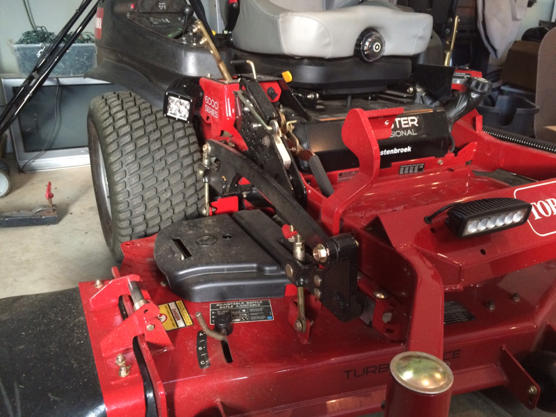

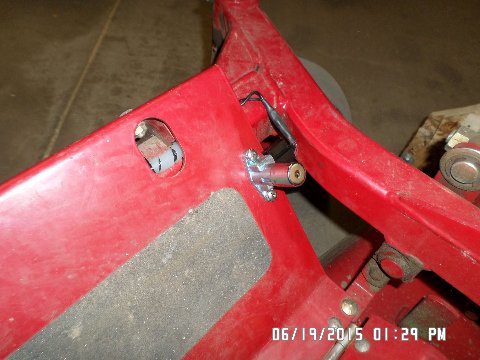

The side lights came in today and I was able to get them mounted. For the starboard side, there was a hole already there from the factory - not sure what for, but the location seems perfect. I went ahead and drilled out a hole on the port side in the same location to get both sides mounted up. The next step will be to wire everything up and start using these new accessories. My next post will be of pics with everything functional, including some pics at night to show how the lights are working.

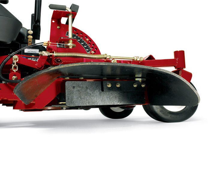

Ed - It's actually a very good suggestion. Fortunately for me, Toro has an answer with an optional accessory that accomplishes the same effect. Here is the description and picture from the Toro website
Operator-Controlled Discharge Chute
Landscape friendly rubber discharge chute provides complete control of clippings. with three discharge settings, from wide open to blocked, the OCDC will put the clippings where you want them and not in beds, streets, etc. The integral design allows the discharge chute to remain in place and on the machine, reducing the risk of personal injury and property damage.

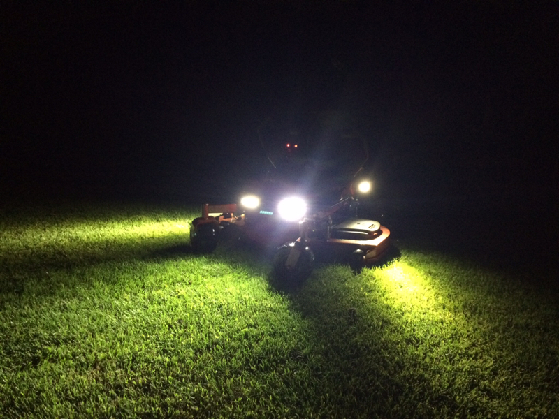

Everything is wired up and functional. My neighbor came by this evening while I was finishing up the wiring and commented that he may want to copy my mods for his JD zero turn because he often gets chased off his lawn by the darkness. I told him that I was more than willing to help! Here's an initial picture I took. More to come when it gets darker outside.

Spent about 30 minutes last night giving the new lights a good work out. This will definitely be a game changer for me, especially during the late summer and fall when I often find myself getting home from work after the sun has gone down. In the past, the lawn would get overgrown and I'd spend the weekend mowing (usually twice) to deal with the extra long grass. Now I'll be able to keep up with the lawn work, even in the dark. Some additional pics from last night .....
