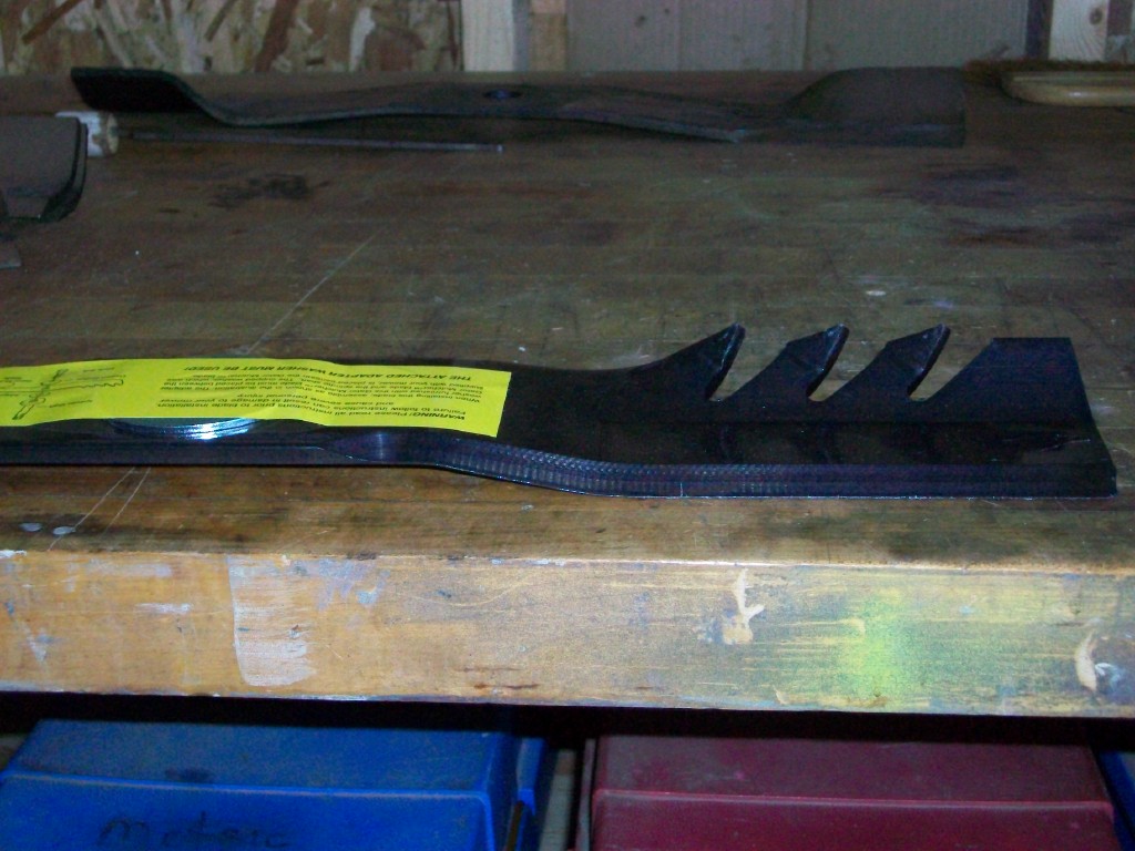

If they are the ones I'm thinking of, the teeth are twisted towards the outer end of the blade, which is just the opposite of what you want. You want the teeth to be twisted towards the blades center so they will throw the clippings in towards the center of the blade where they can be re-cut over and over, not thrown out towards the front of the deck into the airstream where they get cut once and thrown on out the chute. The Oregon Gator mulching blades (namely- the G5 and G6's) are the way to go. They are 3" wide, .250" thick, and are high lift and made from very tough steel (thick doesn't always mean strong or durable, especially in the cheaper blades sold at Lowe's), and they have carbide infused into the bottom edge of the cutting edge on the blade. They can be sharpened from the top side easily with a hand file though. They are not meant to be used with a full on mulch kit though, and that comes directly from Oregon's public rep. I mow for a living, so I have tried a lot of different blades and know many more guys who have tried other blades still.
These are oregon G6's for my Z950A Deere-
