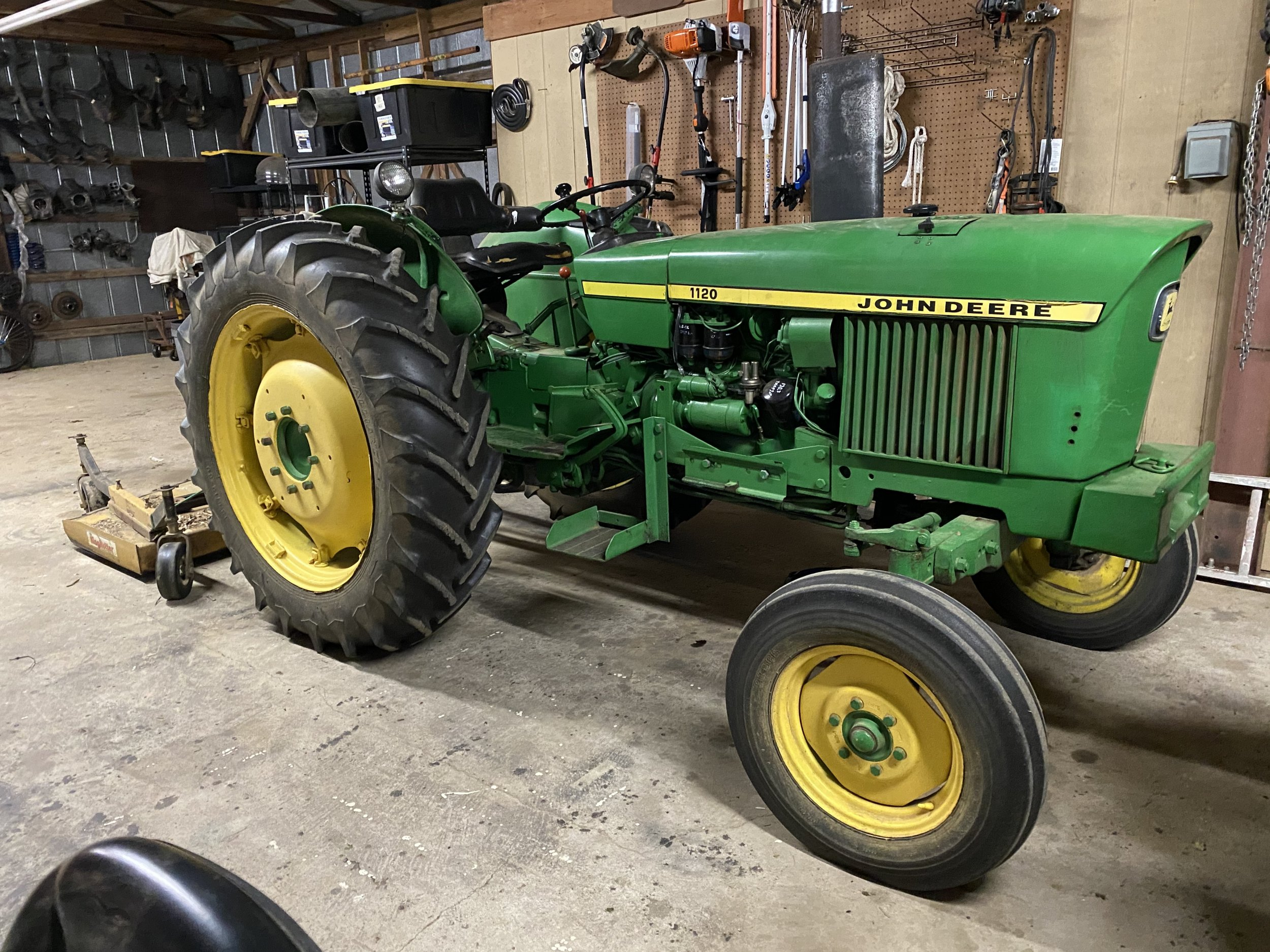

I have a reasonably smooth 10 acre pecan orchard I mow once every couple weeks or so.
I’m thinking of replacing my old John Deere 1120/6 ft finish mower with either a 72” zero turn or a hst tractor with 6ft finish mower and loader.

It’s an older mature orchard with some space.
I’m mowing with a 6 foot finish mower currently
Nice orchard & tractor and I agree the ground in the photo looks pretty smooth!
