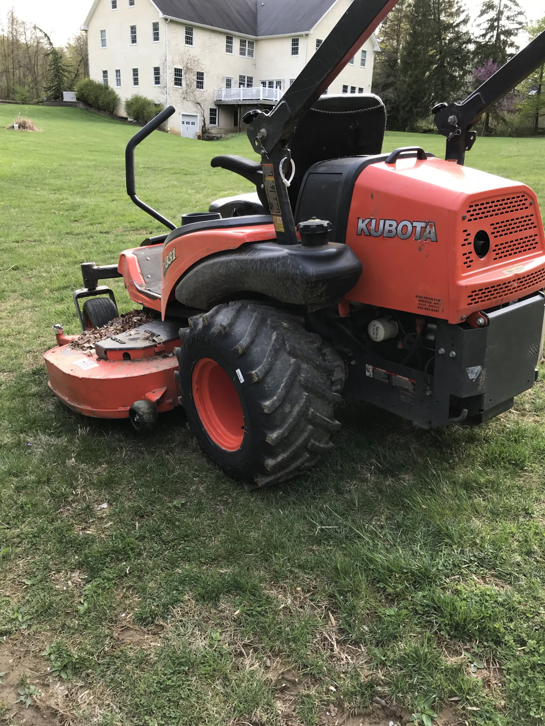

I tried a very similar tire to the Carlisle AT101’s for 2 years and I had to take them off. The were Carlisle Power Traction? Something like that.
NO DOUBT they get better traction, BUT if you aren’t careful, you can tear up poor quality or shallow rooted lawn grass. I basically have one huge customer and the resident in charge of grounds is of course an “expert” and carefully watches and checks everything. Even though the lawn quality is suspect, you have to treat it like a country club. Lol
He tells me he doesn’t like the tires and in certain spots, turf tearing does occur. Hes not incorrect, but real fussy.
They would be great if you are a homeowner and don’t care and the traction is worth the higher incidence of tearing. They are also safer on bad hills.
Turf tires spin out much more than AT101s, but its more of a “smear” or a “burn”, whereas I found the AT101 bar-type tires actually rip the lawn and leave a dirt mark if you’re not extra careful.
I have become so good at running the ZD331, that Carlisle turfs are all I need. I use the F3860 on the psycho slopes now anyway.

Boy am I glad I'm not heating that 'barn' in the winter. Bet your fuel bills are huge.
Thank the Lord for natural gas (for the time being) and 2x6 walls with R-19 insulation
Even my stand by generator is NG. I’d make my toaster NG if they offered it….lol
