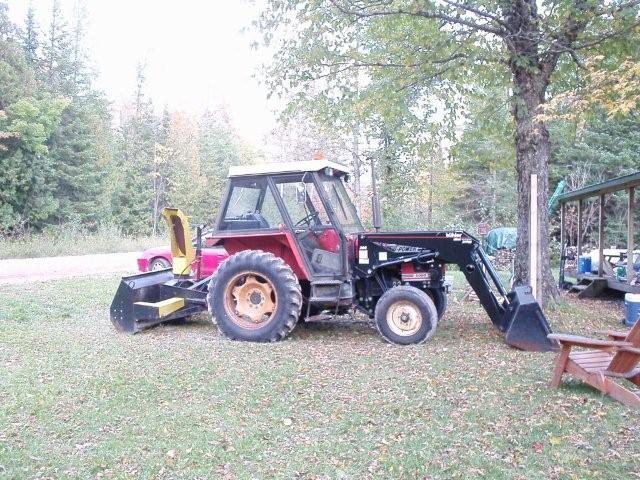

The Agri-Power 5000 from Menards (Zetor 5011) is a decent tractor. I got mine as shown last year for $6,500 with 1,300 hours. Considering what I got versus the price, I feel I made out like a bandit. Hope you feel the same.

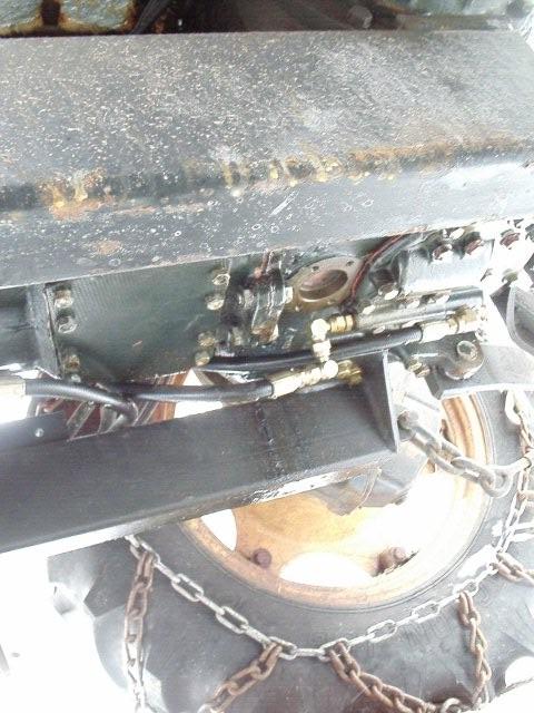

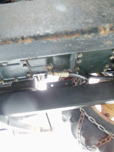

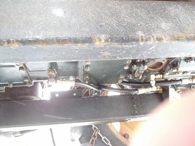

I picked up this tractor real cheap. It came to a neighbor for repairs, but the owner didn't like the price, so I picked t up for $900 with the loader, a box blade, and a set of chains. After a week of work and all new fluids and filters, it runs like a top. The hour meter says 1426, but it doesn't work anymore. I think it's just a broken cable. Could you post a pic of your loader hookup? I don't see anything the screams where it run hoses.
/ Zetor 5211 control levers #9
The hydraulic hoses for the loader are taken from the underneath the tractor.

Thanks for crawling under and taking pics for me. There is a lot more to the 'Z' than I thought. I have no idea about the cold start button. Are you talking about the hand pump right by the injector pump? My tractor has the 3 cylinder diesel and I don't think there is any glow plugs or
I noticed on your tractor you have two hoses coming out from the pump cover, and the third from the drain plug. Is the drain plug hose your return and the other two your 'power' lines? Just scratching my head a little here.

Don't know about the mechanics behind the hydraulic oil lines. However, the hydraulic pump is located next to the draw bar pivot pin. That is where the two hoses were tapped in to, as per a Zetor mechanic. On my tractor, the drawbar pivot pin was removed to facilitate assembly.
