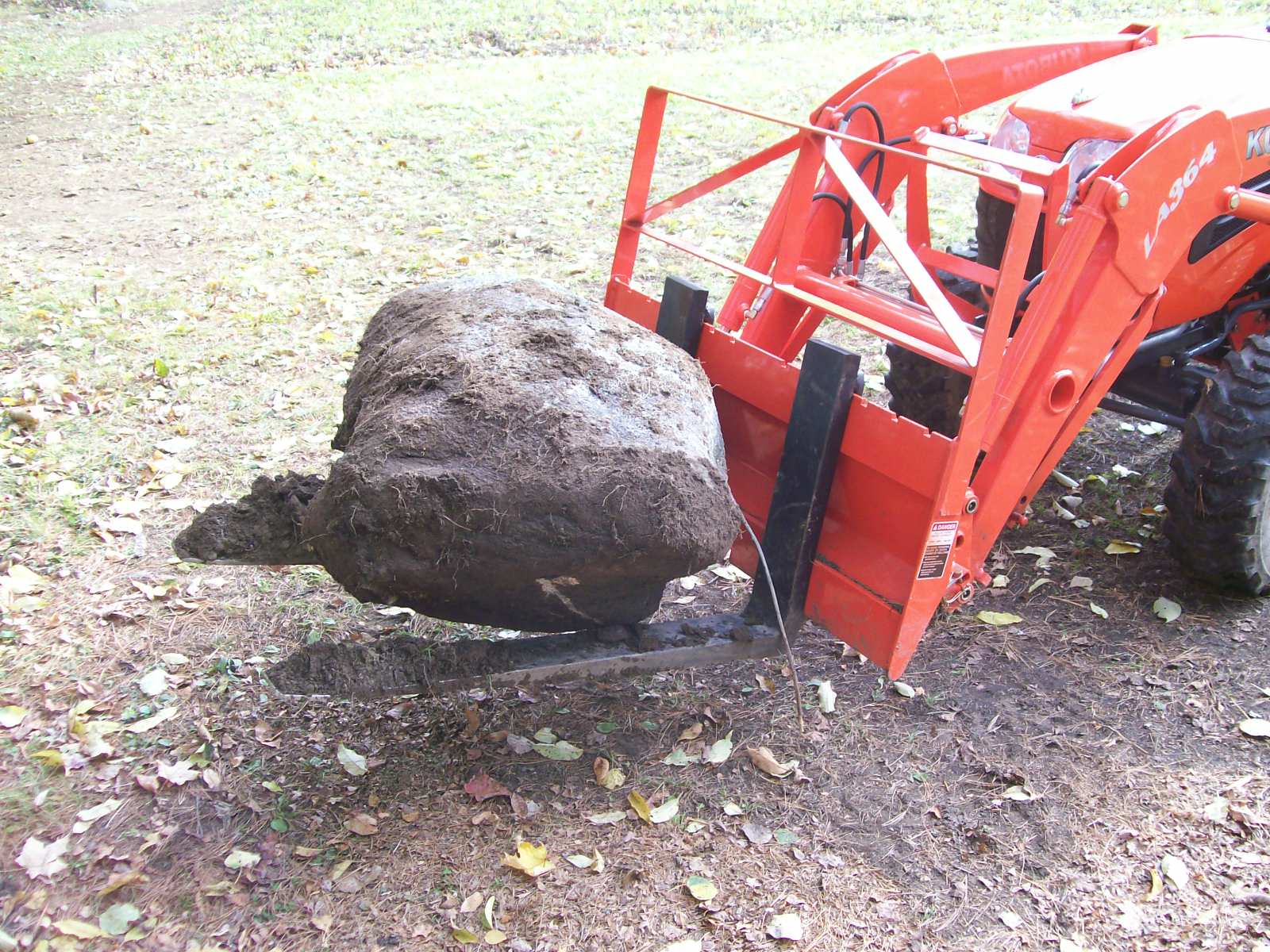

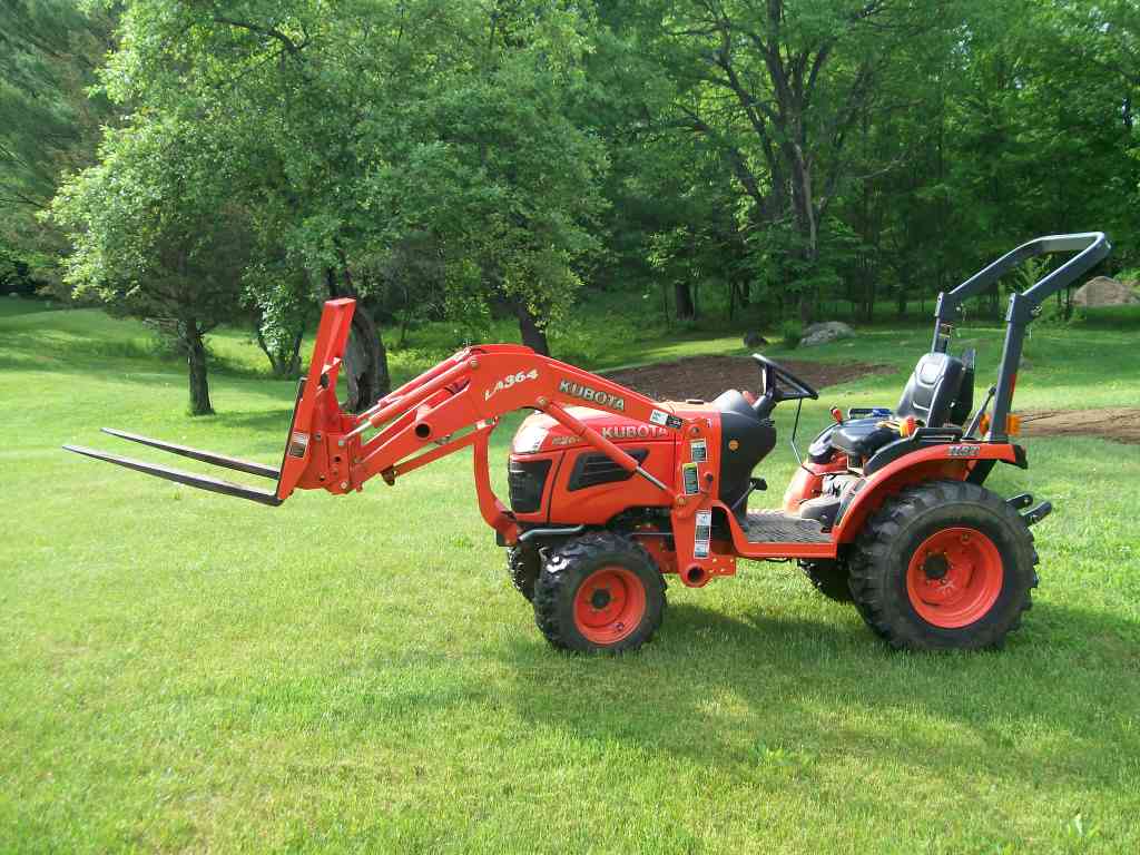

I'm pretty sure that you won't have any trouble fitting the Kubota QH to your loader. I have that set up on my B2620, and it works OK. The pin holes don't line up as well as they should on mine so getting the forks on, and off usually takes a bit of "encouragement" that I haven't addressed yet. I don't think it is as nice, or quick to use as the JD arrangement, but it sure is faster than taking out all the pins manually each time. I would be really happy with mine if those bottom pins would slide in like they are supposed to.

Chuck is your unit bent? I have the same set up and its real easy to get on and off although the JD may be a better QA design.
   / B2320 w/ LA504 Quick Attach And Kubota Forks #11
On my 2920, the bottom holes in the quick attach are slightly off after the top hooks are in and I lift the loader arms a little bit. The bucket/forks "tip down" so the hole is about an 1/8th of an inch off. Lifting up on the bottom forward edge of the bucket or forks slightly allows me to slide the pins right in. I can lift with one hand (wiggle is more like it) and slide the pin in with my other hand.
Been that way since I got mine. A couple of lines of weld along the bottom of each side of the quick hitch to bump it out a tad would probably even things right out, but it's not to hard to get the pins in as it is now. Knowing me and welding, I'd be doing a lot of grinding to get everything evened out.

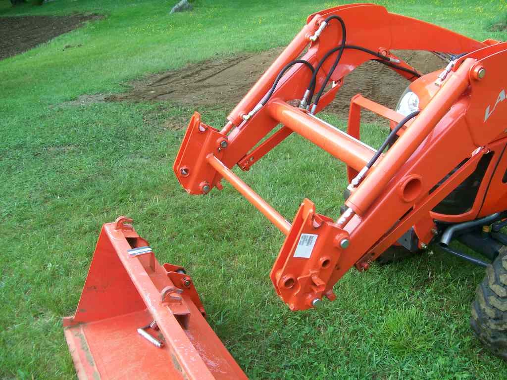

I've searched the internet high and low for pictorial proof that the LA504-QA actually fit on the B2320's LA304. Having found none, I measured the pin sizes and spacing, and verified they matched, took the risk and ordered the QA.
And so for future searchers, here is an actual picture of it installed on my B2320.

As iointerrupt says, the LA504 QA fits the B2320 loader, (I have it on my B2320 also). However, be aware that it may take a little prep work for some attachments. For me, the bucket attached easily. But initially the pins would not fit into the pallet fork frame. I had to do some minor grinding (with the Dremel) on the QA tabs that the attachments rest against to get the fork frame bushings and QA bushings to line up so the pins would fit. Had to do this on both sides. My pallet forks (for Kubota QA) are not Kubota brand but others had the same problem with Kubota attachments.

You don't need anything but the quick attach (and the pins that come with it). The quick attach sits in-between the bucket and the loader arms (obviously), but it all just pins together. No modifications is required to the bucket or arms.
See this thread http://www.tractorbynet.com/forums/kubota-buying-pricing/198139-la364-loader-quick-coupler.html (post #3). You pull the 4 pins out of the bucket (2 each side), then attach the quick attach to the loader arms with the 4 pins. Then you put 2 stationary pins in the top pin holes of the bucket. The quick attach has hooks that hook onto those pine. Then you slide in the lower pins, which ties in the bottom of the quick attach.
I probably didn't provide the best description, but the picture in that post should help.
Hope that helps!
   / B2320 w/ LA504 Quick Attach And Kubota Forks #19
Actually, if you look at that picture, you can see the top pins are installed "permanent" in the bucket and there are no bottom pins in the bucket. One of the bottom pins that slide in after you hook into the top pin is sitting in the bucket. It is just a pin with a rod welded to it so you can pull it out easily.
