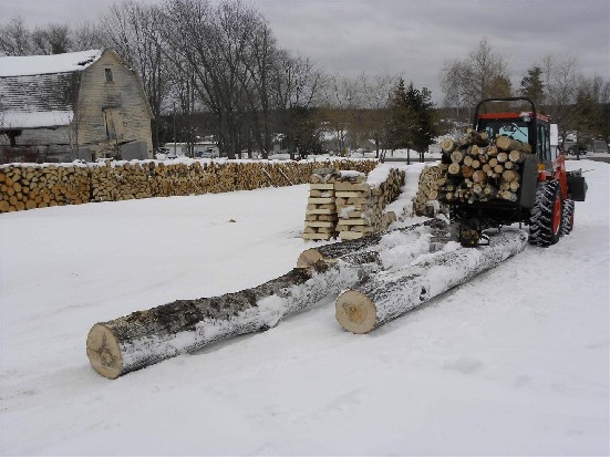

Attachments Utilized: -Half Cord 3-Pt Hitch Box -Bush Whacker -Snow Blower -Wood Splitter -3-Pt-Hitch Road Grader -KL402 Front End Loader This tractor was much lower in price than my past Kubota and just as good in design. It holds a cord of wood on the tractor (1/2 front + 1/2 rear) and then easily drags another cord in 7/8 gear from a mile back. The DS4510 is "tough" and the engine is fuel efficient. It nearly matches a bulldozer in performance when landscaping with the strong bucket and hydraulics and the 8 speed mechanical shuttle is perfectly designed for speed and pushing power. With all 4 tires loaded the traction is phenomenal. It digs/pushes out 15" stumps, mows, blows, splits wood at idle speed, finish landscapes; and all with ease. I had some initial electrical problems (Intermittent Kill Solenoid (replaced) and Ignition Switch (WD-40 fixed) but now it starts at -30C (-22F) without block heater assistance. The DS Series Kioti comes without cab. My "Sims Cab" is the only weak point of this tractor. The bucket visibility is poor and it's defroster capabilities are poor with hot air outlets only located on the heater behind the joystick. In my experience the local Kioti dealer is far ahead of the 3 Kubota dealers I've tried many times to buy from. In summary, buy a Kioti with factory cab (my neighbor has a perfect DK-35 Kioti with factory cab that I use regularly) and it will be a great addition to your family. If you can't afford the DK then the DS series is the next best thing. It's a great tractor.

This DS4510 is very well designed with loader matching the tractor perfectly. Though the loader is a little slow, it has tremendous power. The loaded Ag tires dig in well and it will pull two 25" logs 30' long out my mile wood road in 6/8 gear (shuttle shift transmission). For a 45 HP tractor it's the best buy I could find after searching for 2 years and the dealer is excellent. Not arrogant like all the Kubota dealers I've talked to. I owned a 27 HP Kubota for 21 years and this tractor is an equal match, a better buy and the dealers win the prize.
