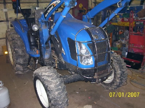

It has been a great tractor with no major issues, very dependable and comfortable. Factory headlights are some of the best on this size tractor, I have used a friends Kubota 4 years newer than my tractor and was amazed how poor the headlights performed. I also really like the 4 cylinders performance and sound level compared to the 3 cylinder Kubota. The view from the seat is excellent, you can see the entire bucket without standing or leaning left and right. I am not just trying to bash Kubota I think their hydro tranny is much quieter than mine, and although I like the location of my bucket joystick compared to the non cab Kubota location, the Kubota's is smooth and the action plus ability to do 2 actions at once with speed is nice. I also think New Hollands high/low range setup with high/low speed button on the joystick and toggle on the right hand fender control panel an excellent setup for many tasks. I purchased my tractor with the skid steer style quick change plate to be able to swap between my bucket, forks and plow and would highly recommend this setup. It opens up a huge array of attachments to be easily put on your tractor and the difference in money is minimal.
Pros: Great visibility, lighting, engine and ease of use
Cons: transmission noisy, bucket joystick action should be smoother
