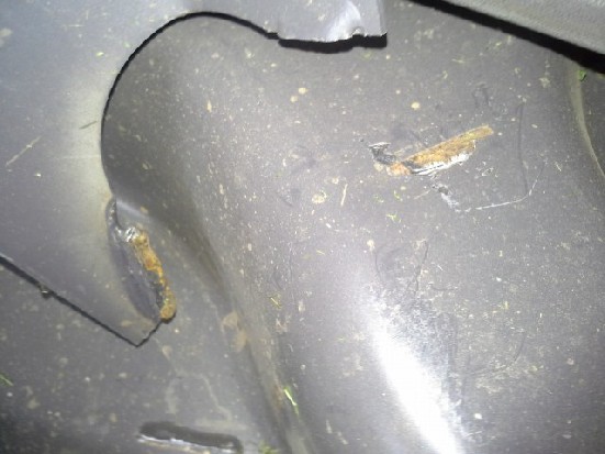

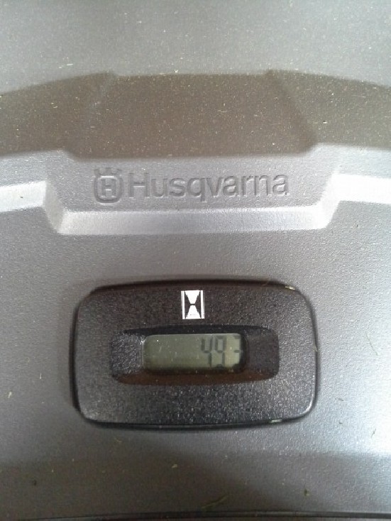

I decided to buy a new riding mower to mow my 2 acre yard so I went and looked at a few and ended up buying a Husqvarna YTH 2348 with a bagger. I took delivery of it May 27-28th when it got delivered I went over the normal things: oil, tire pressure, made sure the deck was level, etc. No issues at all. Here it is May 2014 I'm mowing my lawn for the 2nd time this year, going into a left turn and I hear a metallic noise. I stop and look, 3/4 of the mower deck is hanging out of the right-hand side. I set the parking brake, went to get off and belt flew off and whacked my foot, did the chicken dance for a few, took the mower into the garage and noticed the deck brackets broke off the mower deck. After closer inspection, I noticed cold welds they didn't even penetrate the mower deck, I also noticed there was no belt guard in the mower. It's missing pt#532 19 43-20, they call it belt keeper engine. Call Sears, they say call Husqvarna, I did, sent them pics and also I went to the hosp. due to my left foot x-rays shows fractured foot now I'm in a cast for 6-8 weeks. Husqvarna agrees that the welds are bad and want to refund my money for the mower. Okay, what about medical expenses? Nope they want me to sign a liability form excusing them and Sears from any liability. To me, this is poor customer relations. I've owned Husqvarna products for over 25 years and never had any issues what so ever. Seems to me, now they have cheapened their products and have no quality control on inspection. Never again will I buy another one of there products. After doing some research, there is over 200 complaints on their mowers, between axles breaking, hydro no longer works, axle mounts breaking off, the frame mower deck brackets breaking off etc., etc.
Pros: Strong running Briggs engine.
Cons: Poor quality, poor construction and welds.
