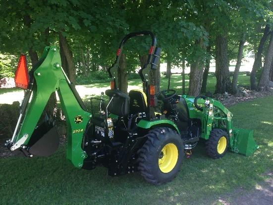

Awesome tractor, but I wish the 270A fit on a 2025R! The added hydraulics of a 2032R would be really nice with the convince of the 270A. Has an annoying rattle from a heat shield. That is my only complaint so far. I would likely have gone with the greater hp if I could do it again. All about the hydraulics and available fluid for implements and faster loader times. My advice is if you plan to do more loader and any backhoe work go with at least a 2025R and avoid the 1 family. If you are mostly mowing and once in a while moving mulch or topsoil the one would be okay. I believe the 2025r is really the smallest you want for a couple acres and small backhoe work. You will always want more power so buy the most hp you can afford and that will fit where you need to store it. As for the 270A, I love the mounting system. So easy. And surprisingly powerful.
