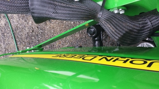

My First Year
Model Year: 2016
I've had my 3038E a little over a year. These are my issues: First, the brake sensor broke. Not a big deal. Second, it would over heat every time I mowed the 7-acre field. It only took a few min to spray it clean. Third, the hydraulics would start to get more and more slack. Forth, the seat sensor would shut the tractor down at the worst and most dangerous times ... and the final last straw is when my rock shaft housing broke and John Deere said it was my fault but couldn't tell me how I could have done it. They didn't even come look at it. They had the dealership send them a picture..
Pros: It's green
Cons: Overpriced
Photo Uploads:

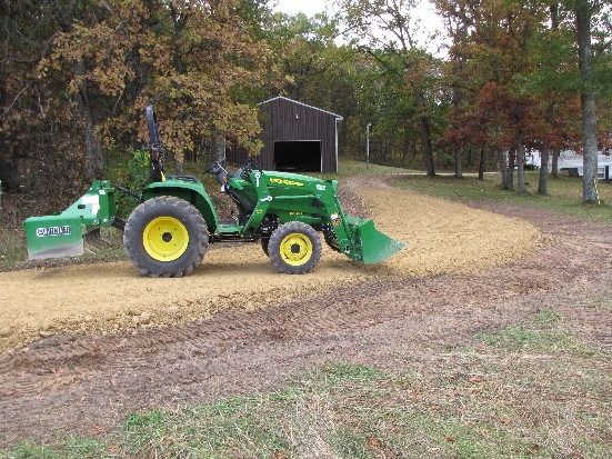

5.00 star(s)
Anonymous Poster
3038E John Deere
JD 3038E
Model Year: 2013
I've had my 3038E for 4 years and it has exceeded my expectations. I use it to plow snow, grade the driveway, and general yard work. It starts perfectly all year round. I have removable forks on my loader and I can haul more than a pickup truck's load of brush and a full bucket of class 5 gravel is no problem. This tractor is fabulous! I've had zero problems. I got a tremendous deal with John Deere, too! 5 years with zero interest. It is stil a great tractor after 4 years.
Pros: Powerful, easy to operate, comfortable
Cons: None! Awesome machine!
Photo Uploads:

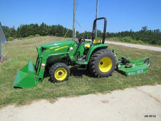

4.00 star(s)
Anonymous Poster
3038E John Deere
3038E
Model Year: 2015
A good tractor but the "E" is definitely for economy. Upgrading from a 790, that was a solid machine, you can see the differences. The fuel level indicator on the hood makes it tough to watch the fuel level. The front hydraulics bleed off when sitting. The exhaust is a killer, hitting the grill guard mount and shoved directly into the drivers face. You would think a John Deere recall is in order...
Pros: It's still a John Deere
Cons: Exhaust fumes/fuel gauge,rear hydraulic clearance

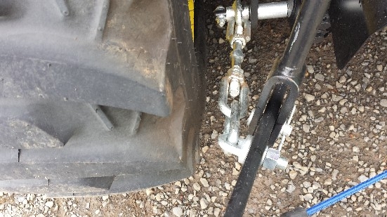

5.00 star(s)
RLong
3038E John Deere
John Deere 3038E
Model Year: 2013
My first tractor was a JD 2520. It was a good tractor and never let me down, but I wanted a little more power, especially off the rear PTO. The 2520 had features that were very nice (cruise control, etc.), but I seldom, or never used them. I wanted a more basic tractor, with a little more power. I didn't want to break the bank getting a different tractor. After much research and gleaning all the reviews I could find on-line, I decided to get the JD 3038E. It was a basic tractor with more power. I have to admit I missed a few of the bells & whistles that were on the 2520. Mostly the four-wheel drive indicator and the loader bucket indicator. Now that I have a little over 100 hours on the tractor, I feel I made a good choice for me. I've used the tractor with my JD 655 tiller and it tills new ground much faster than the 2520. I also have a Frontier 1164, 64" wide snow blower. Once again, the 2520 worked with this snow blower, but there were times I had to go slow when I encountered a deep snow bank. I can clear snow now twice as fast as I could before. I do slow down a little when I get to deep snow banks, but not much. I used the 3038E with a box blade and front end loader to rebuild on trouble spot in my son's driveway. Five 22 ton dump truck loads of rock, spread and contoured in a couple of days. I am very happy with this tractor. It's not the tractor for everyone, but it sure does what I want it to do for me.
Pros: Price, power, good fuel economy, easy to maneuver, good parking brake, beefier 3 point hitch.
Cons: No 4-wheel drive indicator.
Photo Uploads:

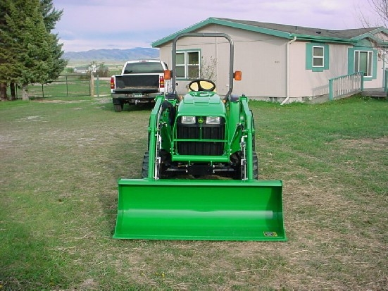

4.00 star(s)
onebear876
3038E John Deere
John Deere 3038E
Model Year: 2013
After looking at several brands, I bought the JD 3038E in a package deal with no interest for five years. It starts and runs great and is easy to operate. I have some steep hills to mow with four year old brush on most. I have to take it slow and easy on the steep slops and can not mow if it is wet or even damp. Ag tires may have been a better choice. I can drive it into the garage, but would still liked folding ROPS. After only 20 hours, I am still learning what I can and should not do on my hills. Overall, I love my green machine.
Pros: Easy to start and operate, comfortable, good on fuel, good power.
Cons: Traction not what I had hoped on steep slops, ROPS does not fold.
Photo Uploads:
