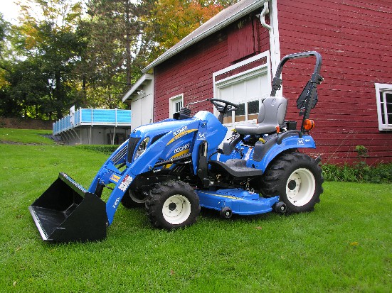

Bought this tractor used from dealer. Implements purchased with the tractor are a NH front mounted 63" snowblower, NH front mount 60" rotary broom, 72" Woods 3-point finish mower, Woods 60" 3-point brush cutter and NH 60" belly mower deck. What I like: "Big tractor" features, Hi/Lo range HST, powerful hydraulics, rear & mid PTO, 12VDC power outlet, engine jacket heater, tight turning radius, strong 3 cylinder Shibaura diesel engine, manual PTO engagement lever-no electric clutch-and a roomy, open operator station. What I don't like: Very hard to start in cold weather. Loud, growling hydrostatic transmission. Cheap, fragile, plastic instrument switches. Excessive engine vibration over 2,600 rpm, poor quality electrical system & components, exposed HST/hydraulic oil filter next to the mid PTO on the rear axle. With less than 2 hours of operation and 174 total hours on the tractor, the PTO selector lever is stuck, the HST range lever is becoming hard to shift. The Sensitrak automatic 4WD is problematic and inconsistent, and one of the 4-way flashers is irregularly working and the battery has been replaced. I don't think this tractor will make for a good long-term investment. New Holland's quality has fallen significantly in the sub-compact & compact tractor market. My overall impression of this tractor is that it's cheap and under built. My dealer, however, is excellent and has taken very good care of me. I'll let the dealer go over the tractor and try to correct the above deficiencies before I pass final judgement as to whether I keep this tractor or get rid of it.

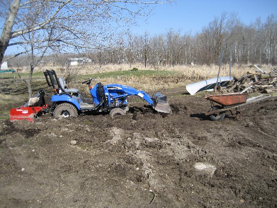

I have been using the tractor with a 54" tiller, 64" snow blower, 48" box blade, and the factory 48" loader, also a 60" finish mower. The tractor has performed flawlessly! I did the first service myself and nothing was too difficult to do, which is great--knowing you can work on the tractor yourself without hauling it in to the shop. It continues to surprise especially when working the 64" snowblower, it moves a ton of snow quickly!
