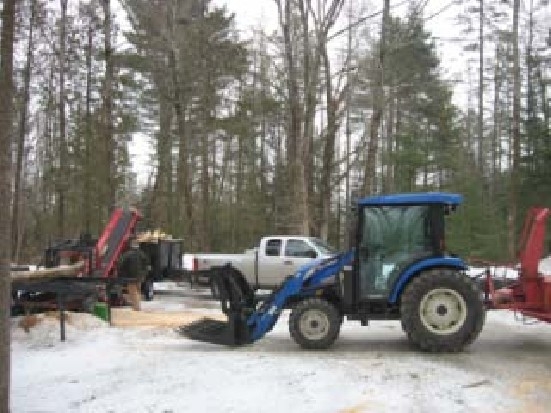

    Traded in the New Holland Boomer 3050 For a New Holland T4.75
    Today was the big day here on the Farm. I've had my NH Boomer 3050 with CVT (On The Left) for over a year now and it has run flawlessly, but now have much larger property in acreage to maintain so...
