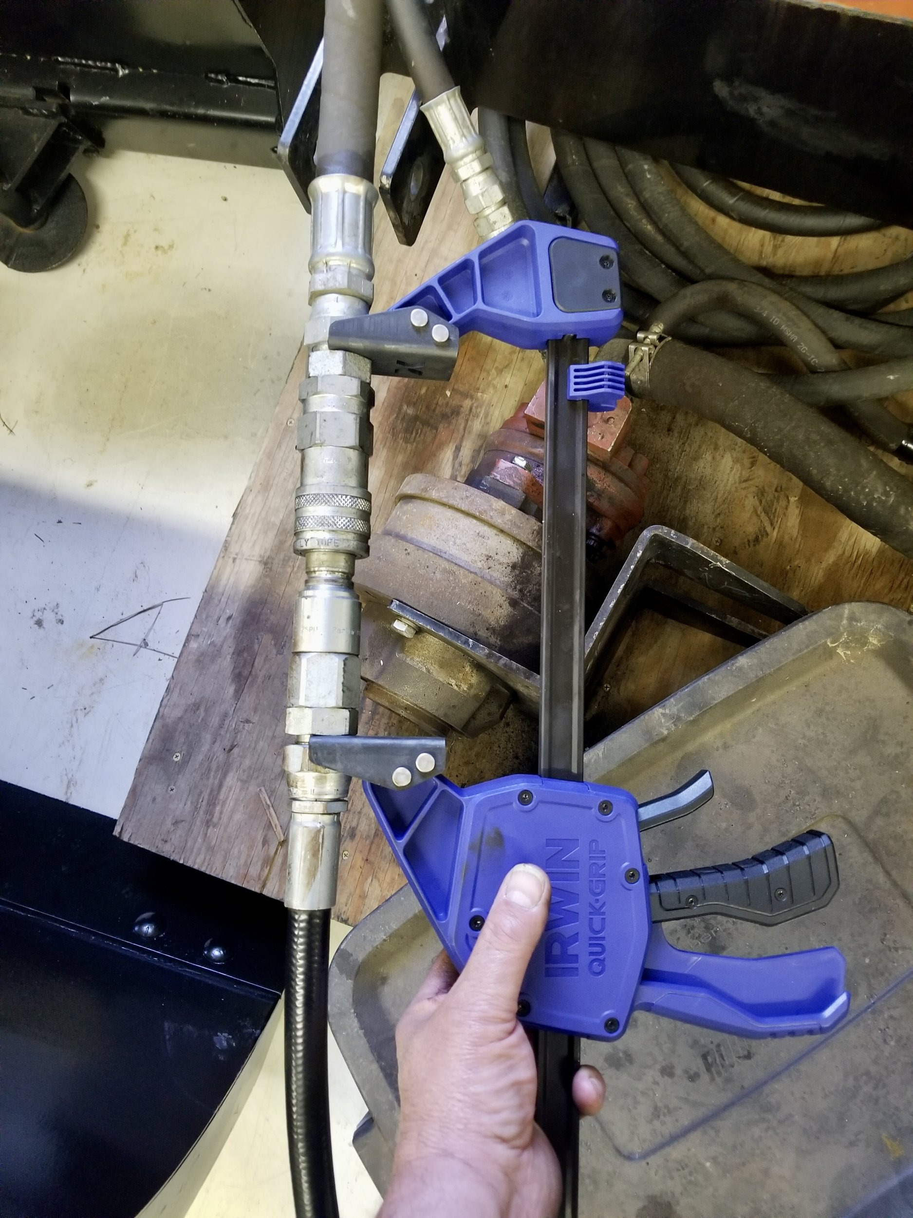

Been using them for thirty years. Many pros and cons but are my preferred QC for loader 3rd function.
Many tools available to help making connections.

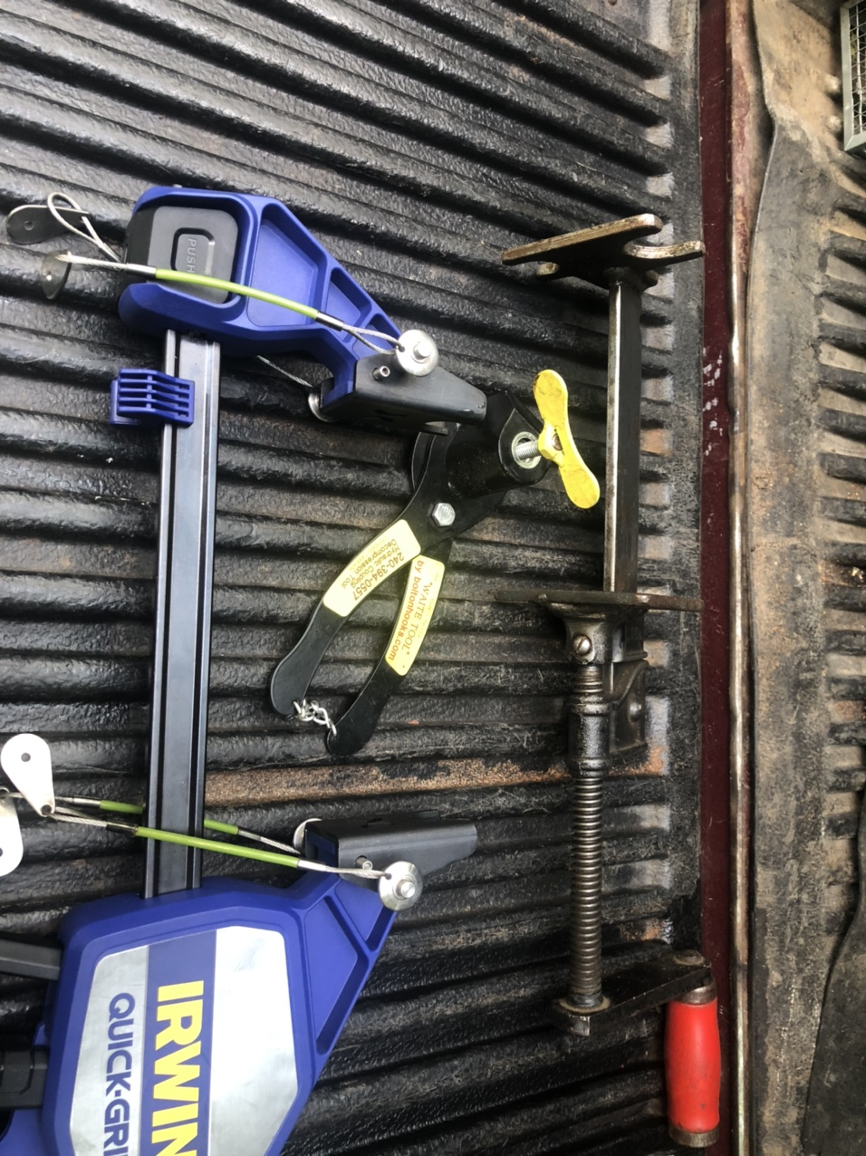

This is about Xboom coupler QC Mate
Available as a complete tool for about $100.

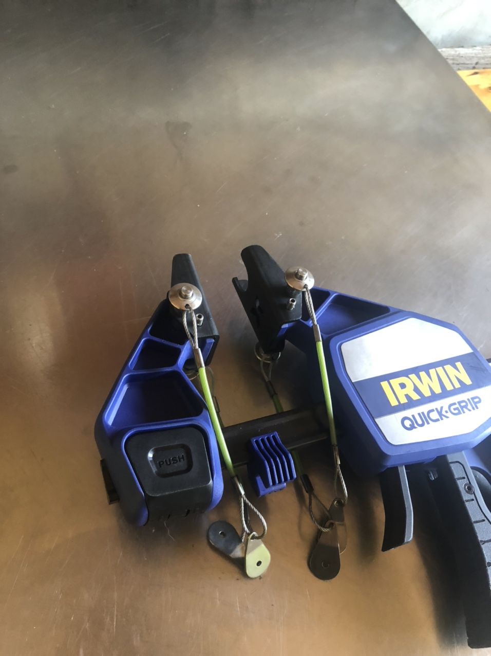

Or now can buy just the specialty jaws and use your clamp.
1/2” Jaws $26 with no pins.
Clamp $28
Easy to drill four holes for 3/16” pins or bolts.
Came with good instructions how to use and precautions to take.
Makes easy work on making connections.
The Irwin clamp is their HD quick-grip capable of 600# clamp force. Impressive. Have several of their medium duty models but this one is much stronger.
The jaws could be cut from 1.5” square tubing 2.5” long. Xboom makes a variety of sizes. There is a little interference on the back flanges and bulkhead fittings. Nothing a little grinding will not fix.
Making jaws well within most farming folks skills.
Overall a well made tool. Technique remedies most connection problems but sometimes pressure does become a problem. Age adds other issues. Some days swapping out attachments several times. Older suppose to be smarter too.

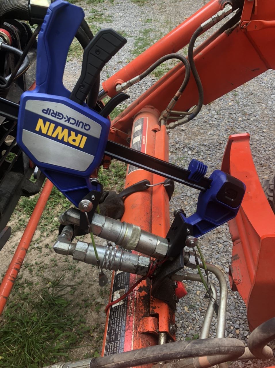

I have an XBoom QC Mate. Am happy with it -- if you can build it yourself with just the adapter plates, that's great. Without it, connecting my grapple with 1/2 flat face coupling is a pain. So much easier with the clamp!

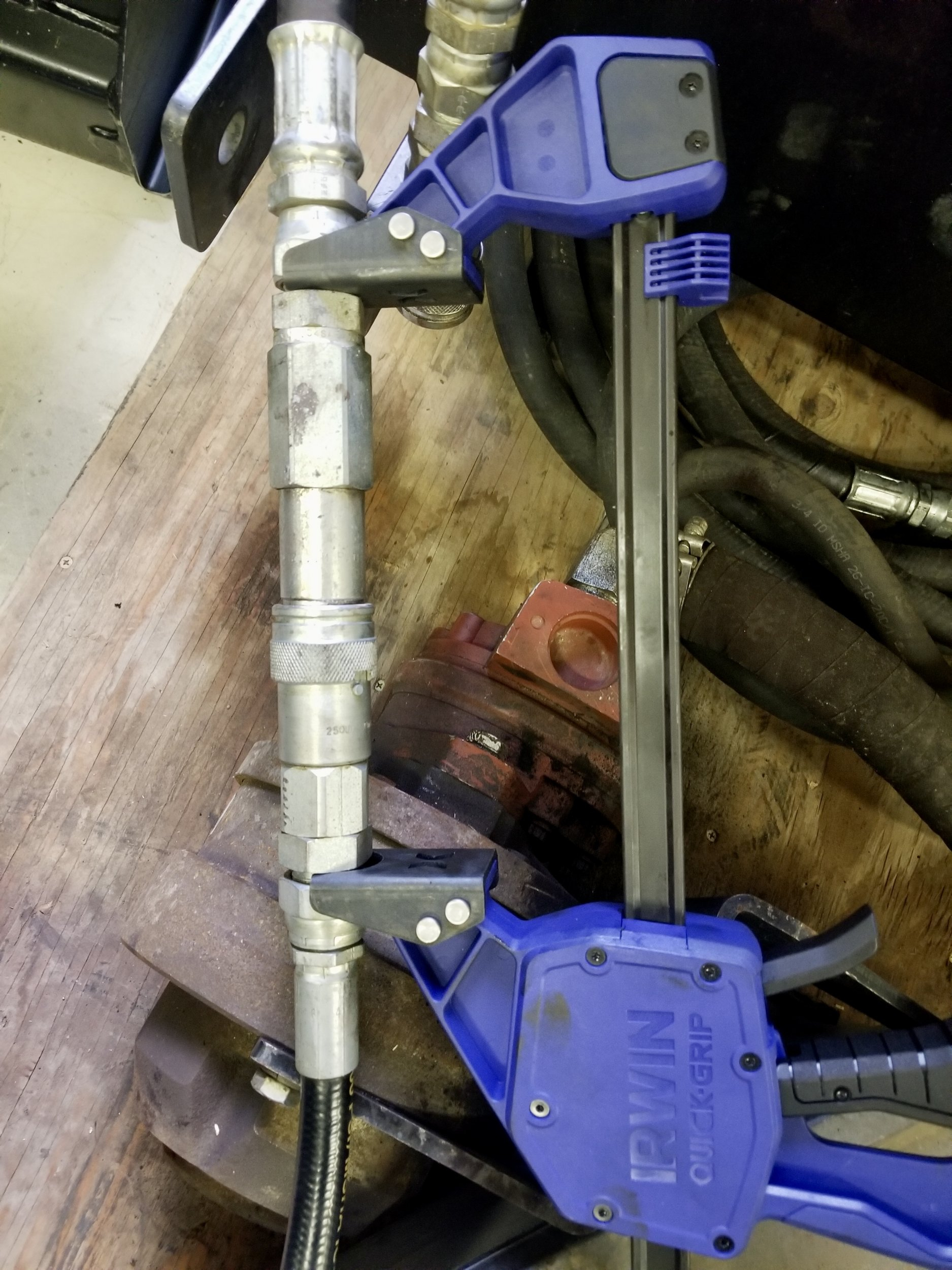

smokeydog, i want to thank you. I received the tool, and ive never had an easier time clicking the hoses together. Mine are larger 1” flat face couplers. Have beed a pain in butt for 10 years. Never knew this tool existed.
   / Flat Face Hydraulic QC
View attachment 753416View attachment 753417
Thanks for the positive feedback. Good that it worked for you.
Only wish it was more compact to fit into tractor tool box. Welded a hanger hook on the ROPS for the screw clamp on one tractor. Don’t transport equipment as much so keeping in the tractor shed not bad now.

Week of daily gully washers. About a hour of showers with 1-2” of rain and strong winds from heat of the day energy. Cleaning up tree spoils, limbs and grading gravel gullies had me switching FEL implements several times with a hot tractor and hot outside temps. The X-boom clamp had no problems making multiple connections under pressure. Very satisfying click of accomplishment with minimal exertion. Works a little better with the bigger tractor with more room.
