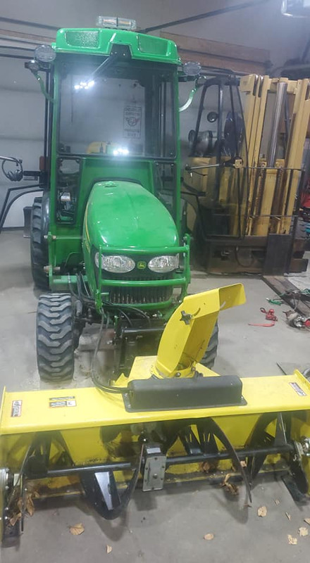

I sold a very nice little Massey gc2400 that would throw snow 80'. This bigger more powerful JD throws it about 10'. I tried loading the blower heavy with a good row from the rear blade first, going faster, slower, nothing makes much of a difference. There is about 4-6" of fresh snow, not real wet, not super cold. The massey would hit the top of trees, this one barely clears 10' out. I am wound out, and even bogged the engine a little when it loaded up well.
I wish I had never sold the Massey, but it funded the cab and blower for the JD, which I have far more attachments for.
I see the clearance between the fan and housing has quite a big gap, close to 3/4" but not worn, just gap. The blower is like new. I am thinking about doing the rubber flap mod.
Has anyone done this? Do the rubber flaps go on the leading or trailing edge?
Was it worth it?

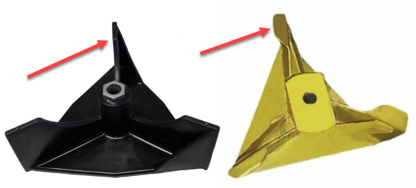

I had the same problem with my 54-inch blower. I swapped the impeller for the steel one and it was like night and day. It's all about the shape of the blades on the impeller. Other than being made of plastic, the blades on the OEM impeller are completely flat. The blades on the steel impeller are curved on the ends like a scoop. Literally every tractor mounted snow blower I've ever seen, whether front mount or rear mount has an impeller with scoop-like blades.
The black impeller below is the plastic one.

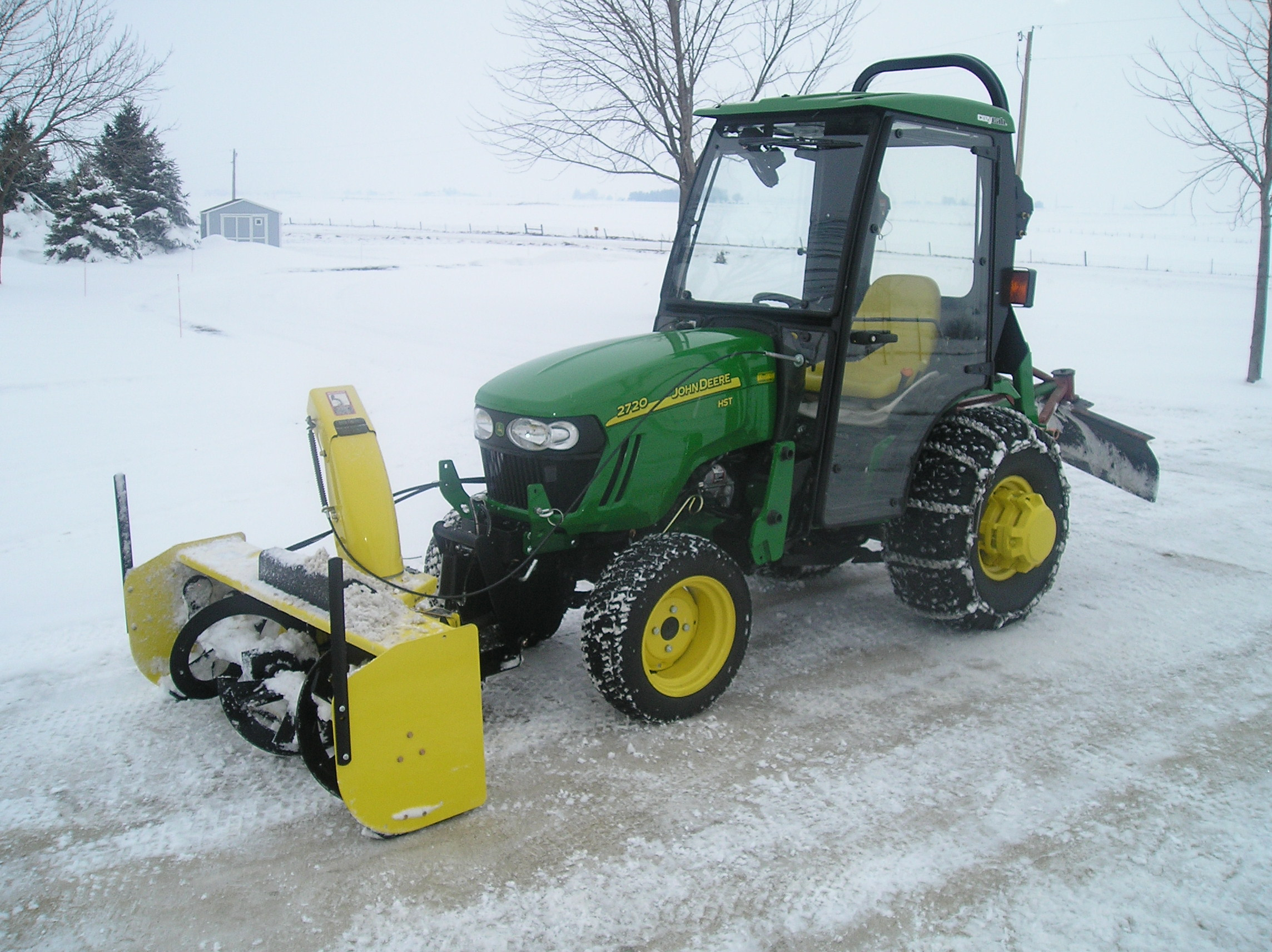

I have had the same 54" snowblower on my 2720 for 10 years and have never been disappointed with how far it throws snow. Slight changes in moisture content, density and volume will determine distance thrown. But for the price of the thing, it should throw snow into the next county. ;)
However, it does vibrate more than I like at pto speed so I usually throttle down a little to smooth it out.
