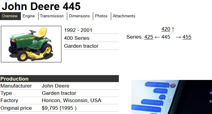

Is this the gas engine garden tractor with a Kawasaki 22 HP engine?
If it is this forum may not have the best experts for a gas engine

It’s a 2000 JD 445 22hp Kawasaki, mid PTO, 54” deck, 47” snow blower front quick hitch, rear three point hitch. Just a pensioner trying what I can to avoid paying 120.00 an hour for a so called expert to fix it for me . Thanks for your advice.
