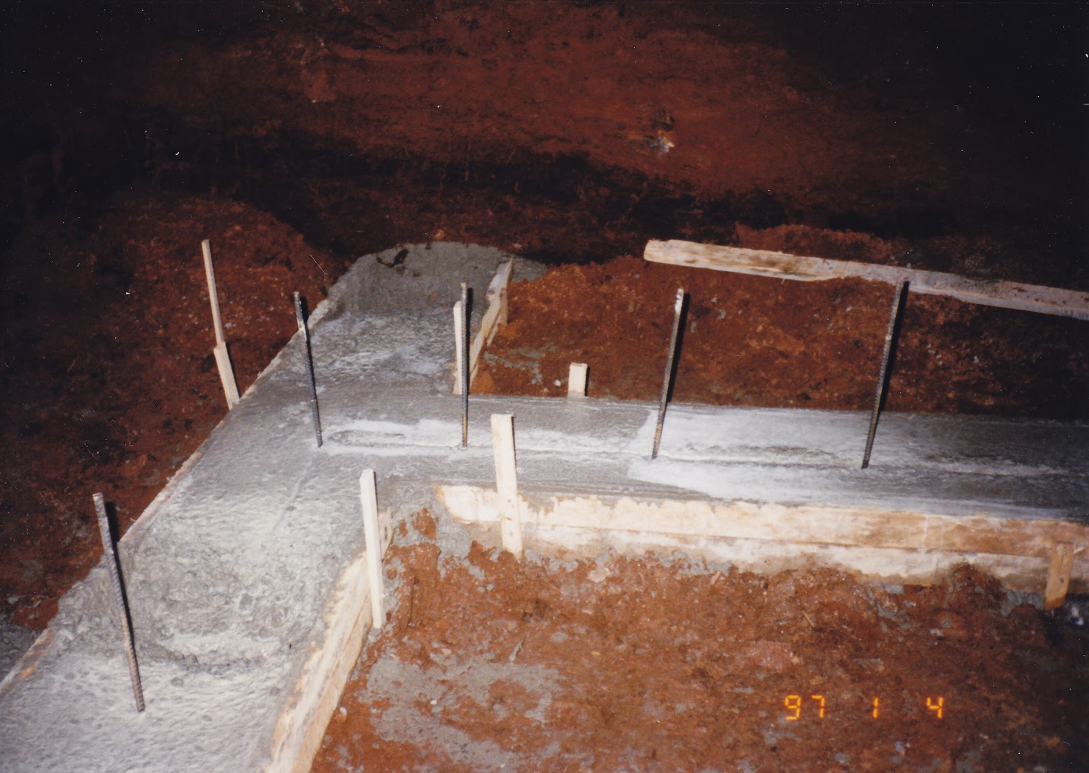

19970103 - footers were dug and poured

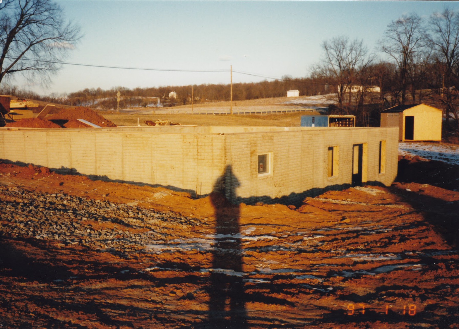

19970108 wall forms installed
19970115 Basement walls poured.
19970117 Lumber arrived for the first deck.
Excavation and foundation were subbed out.
19970118 installing seal plates on top of walls.

The excavator cracked a wall while backfilling. The walls have 1/2” rebar both ways every 2 ft. I put a crack filler in the crack and it has never been an issue.
No settling at all. The entire basement is one big concrete box.

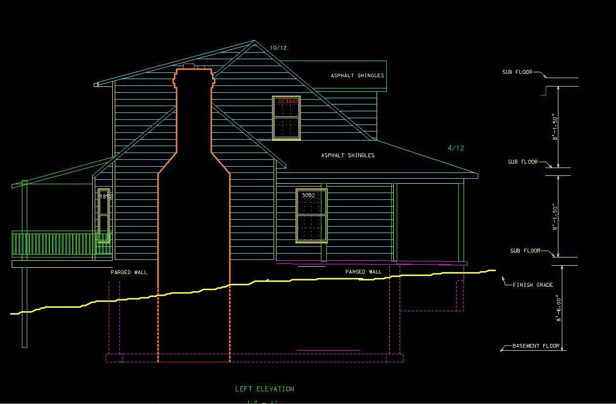

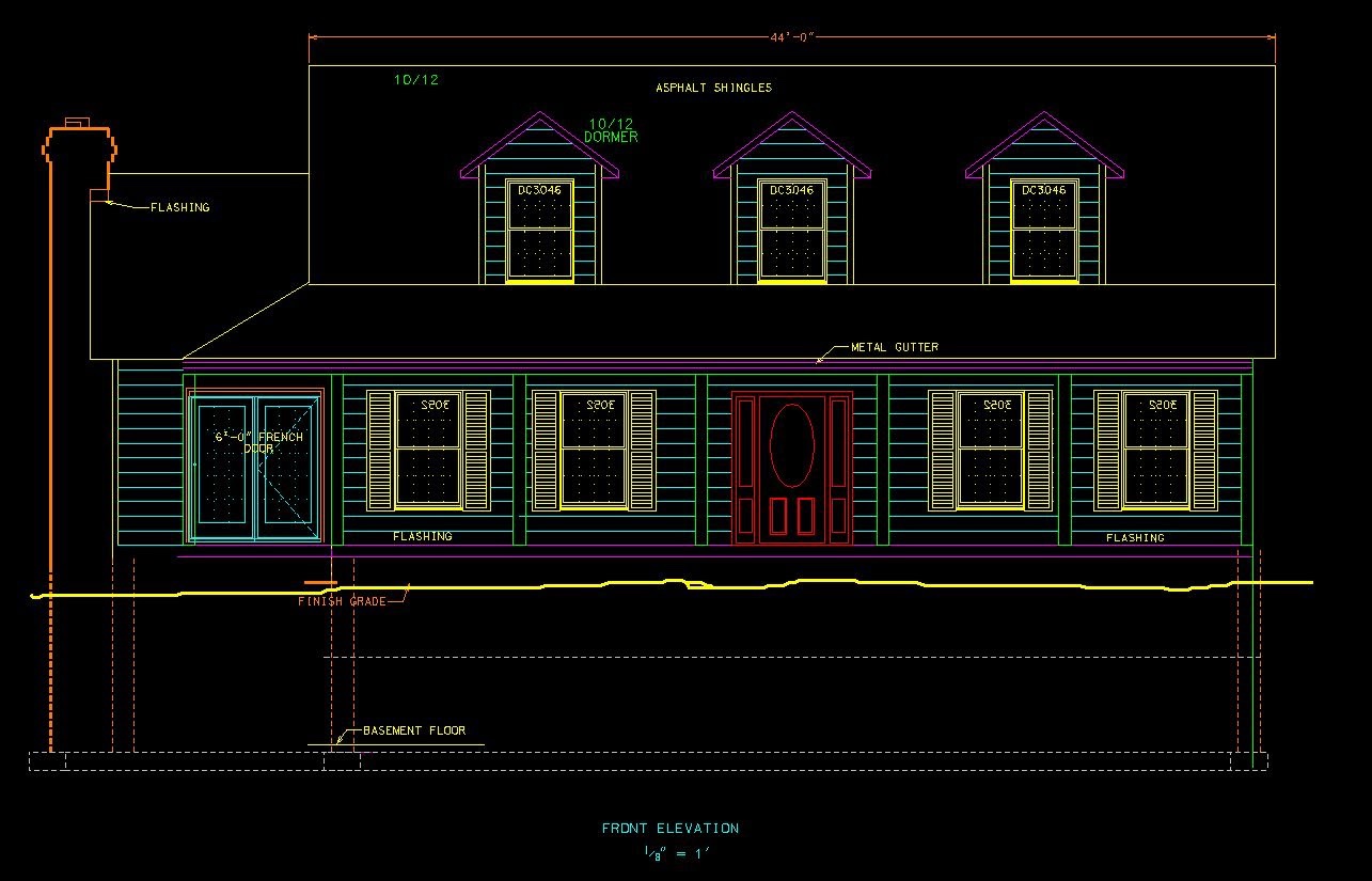

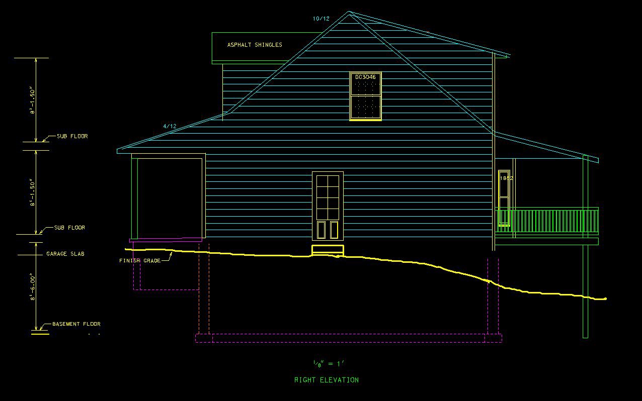

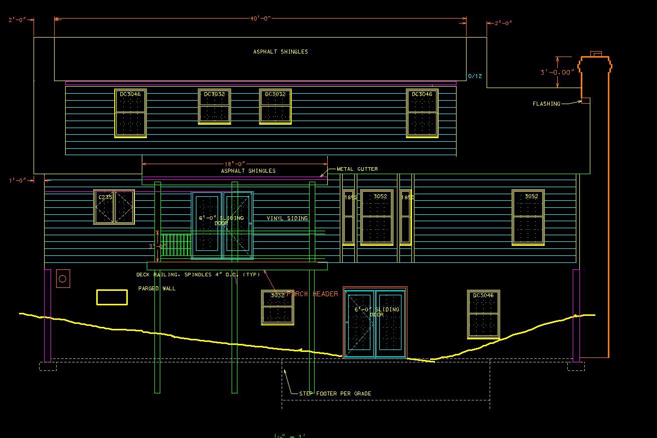

I designed the house. I first designed a much larger one, with 2 story front porch and 3rd level in the attic. I basically cut 1 level off.
Here are 4 elevation views. I planned the garage extension which I started in 2002.
Original design was shed dormer in upstairs back ending 2 ft from each end. I ended up running it all the way to the ends.

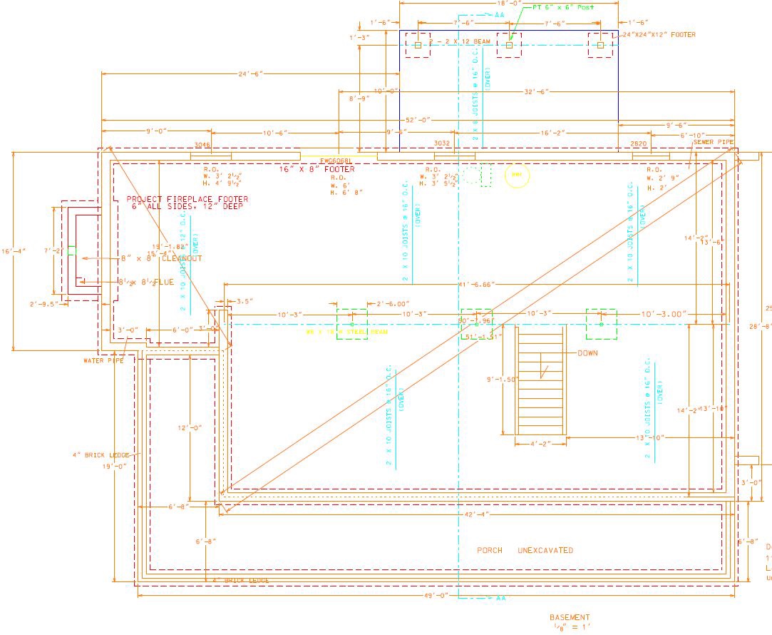

Original floor plans:
Basement:

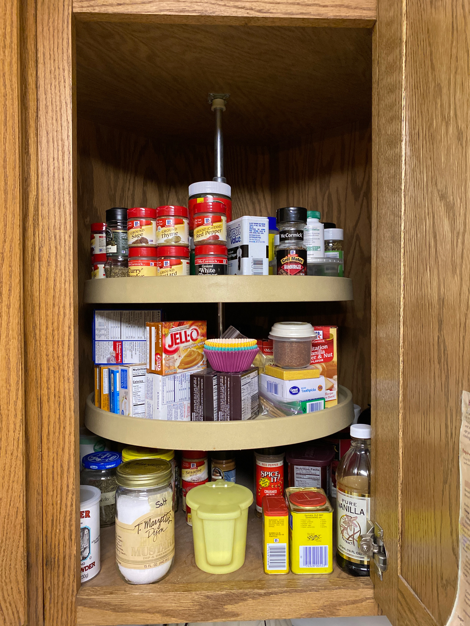

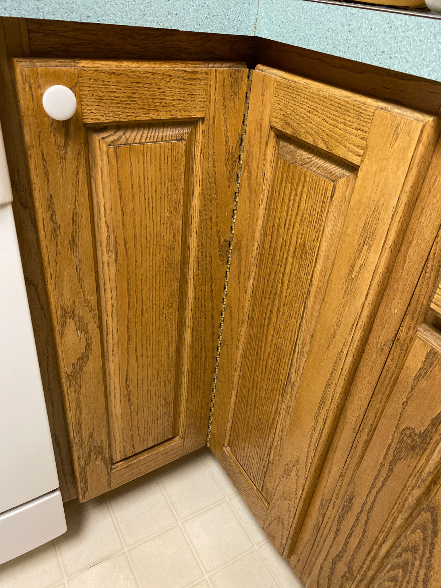

I see a lot of kitchen cabinets boxed out a foot at the top. I made mine go to the 8 ft ceiling for extra storage.
Lazy Susan in wall corner, piano hinged door for base corner.
   / This day in 1997, of my house build #19
I already reported up to the 18th, it’s hard to wait to report the next thing. Lol
