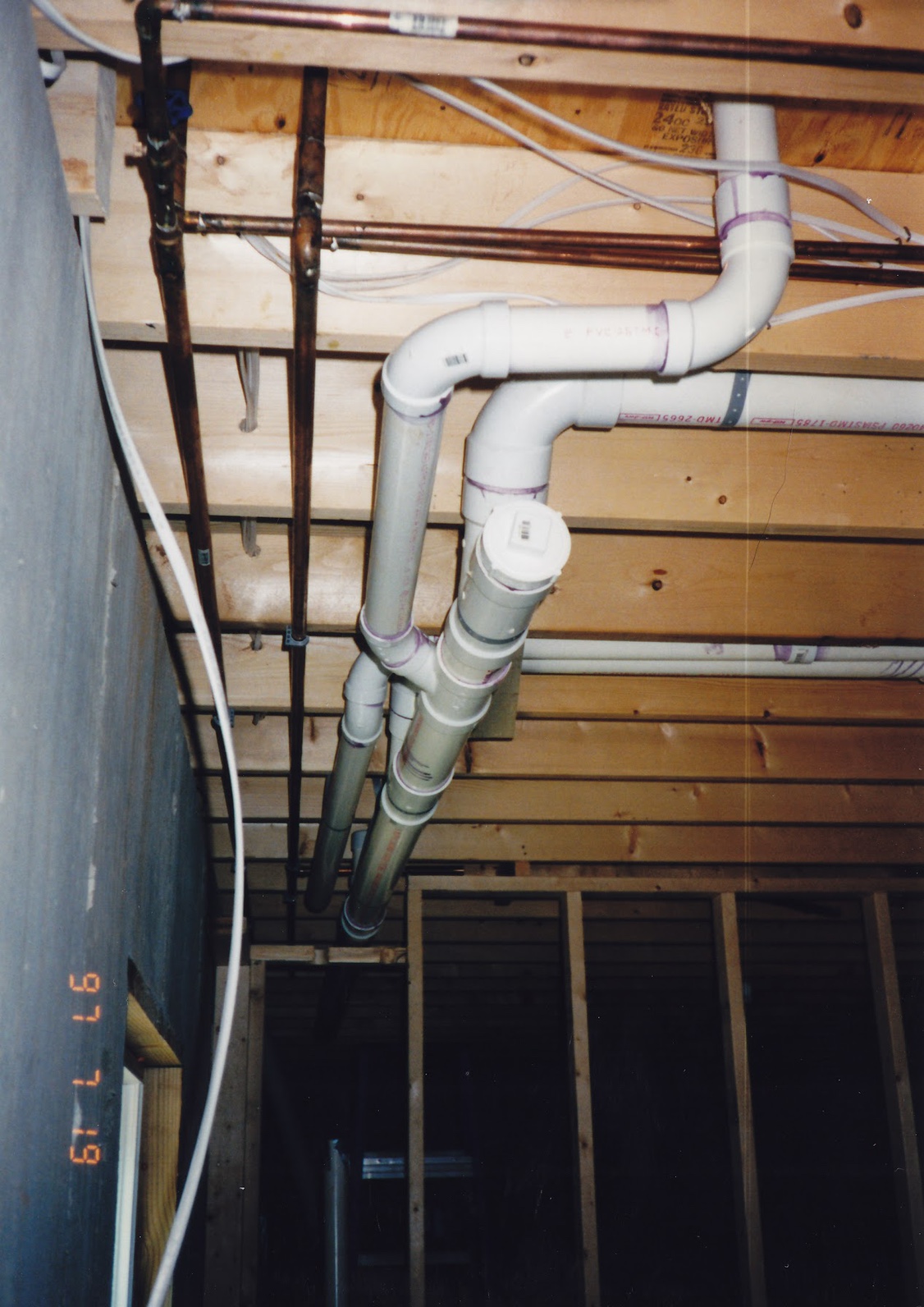

Basement overhead DWV. Did not get any pictures of under slab piping.

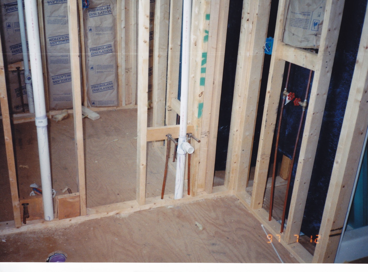

Upstairs back to back baths. One regret was not using ball valves for shut offs. I didn’t know better then, used what I was used to. First time I needed to shut water off to the shower valve, these shutoff valves leaked like crazy. Had to cut hole in drywall, cut them out, and put in ball valves.

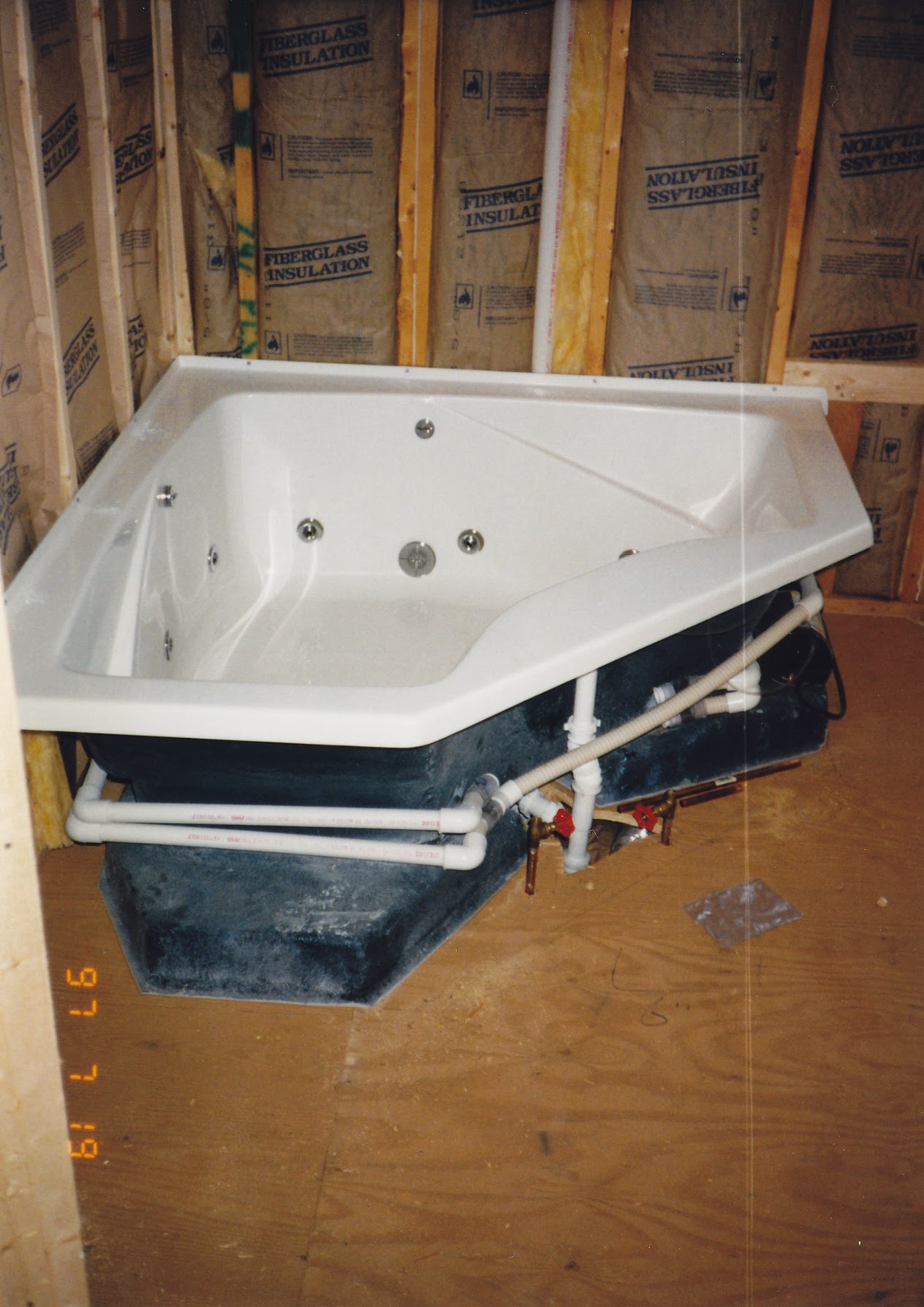

Master soaking tub.

Is there an access panel for those valves? Jon

Yes, but to replace them I needed a bigger opening. Still haven’t taped the drywall from that job.

Does the tub get used, or when was the last time anybody used it? I read that they are used 3 times by most people. I've taken out quite a few for clients that want big walk in showers and never used their jetted tub a single time.

It gets used occasionally.
