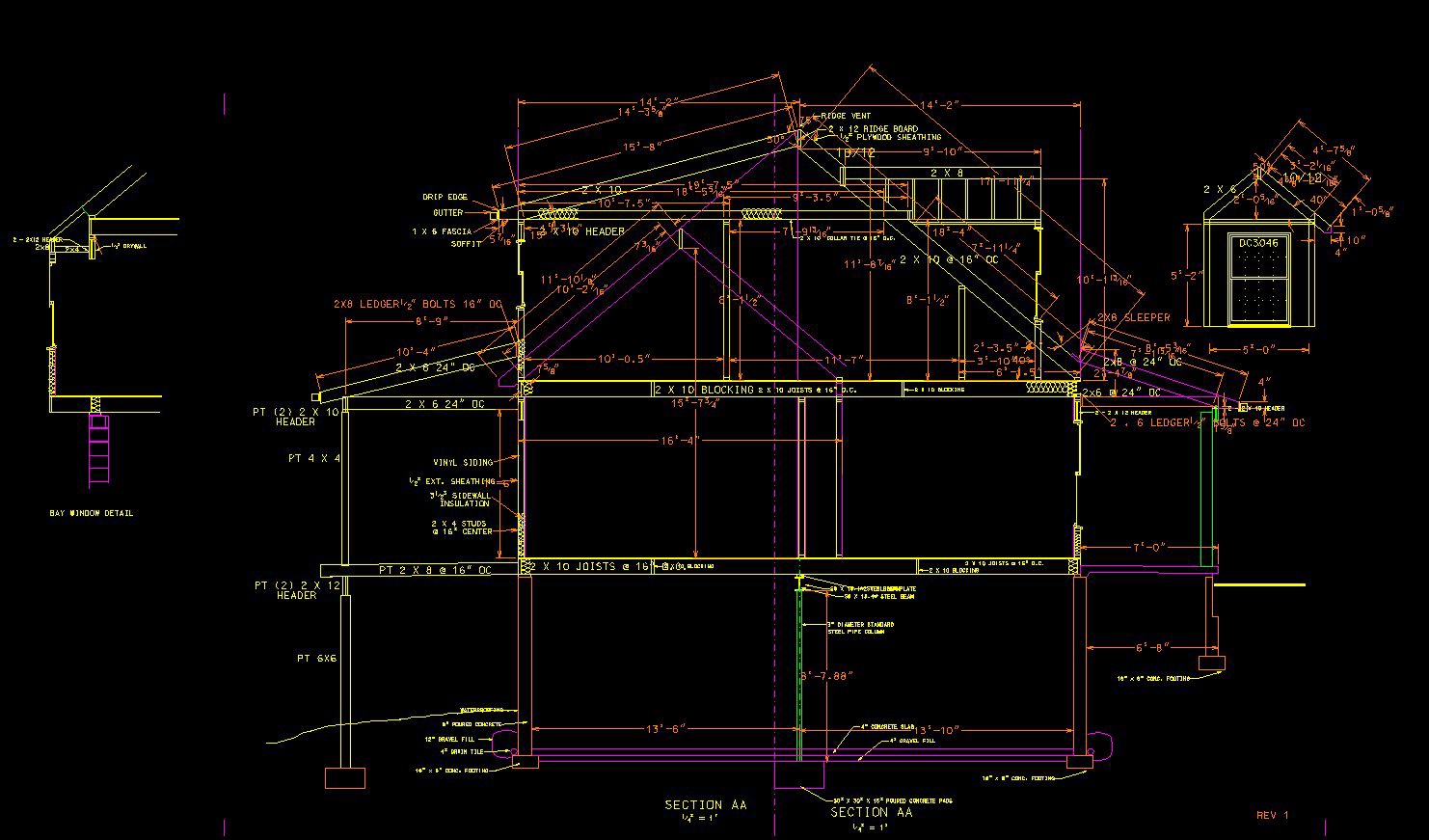

Cross section

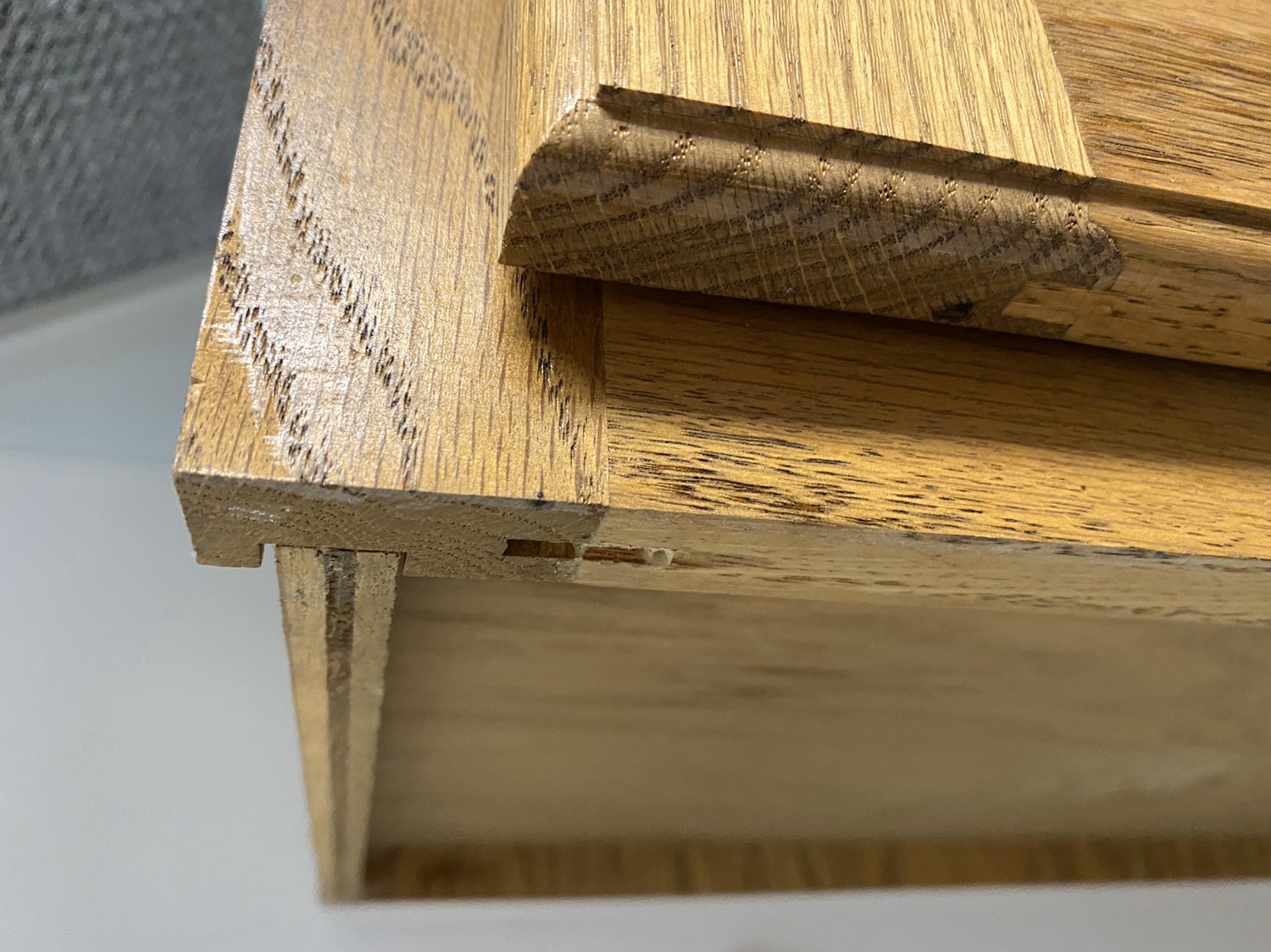

While waiting for my last house to sell back in 1996, I bought a shaper and built my kitchen cabinets. Solid oak fronts, solid oak raised panel doors, oak vener sides and backs.
I can not find a single picture of the cabinets being made.
Sides, tops and bottoms recessed into the face. Wall cabinets used 1/2” sides, base used 3/4”. Used biscuits joining the face pieces together.
Doors used rail and stiles.
All cabinets designed using CAD software.

I would have kept whole house about a ft higher in elevation, and pushed more dirt up around. Not a big deal. I still got gravity to septic under the footer.
Would have insulated under basement slab.
Would have paid more attention to taping tyvek, I m sure some seams were not taped. Same with windows, I know most of them are not taped.
Would have added more insulation to attic..
cape cod, so some drywall is on bottom of 2x10 roof rafters. Wish that was spray foamed. Had lots of air infiltration at open ends of rafters, between rafters and insulation. I went in later and blocked the ends up to the insulation baffles that let air under roof deck, above the insulation.
I glued and nailed subfloor, wish I had screwed it. Just a time thing. Floors squeak, I want to go back and screw if/ when I replace flooring.
Would have placed house further back on lot.
There痴 plenty more, lol. Not much internet back then, I learned a lot since then.

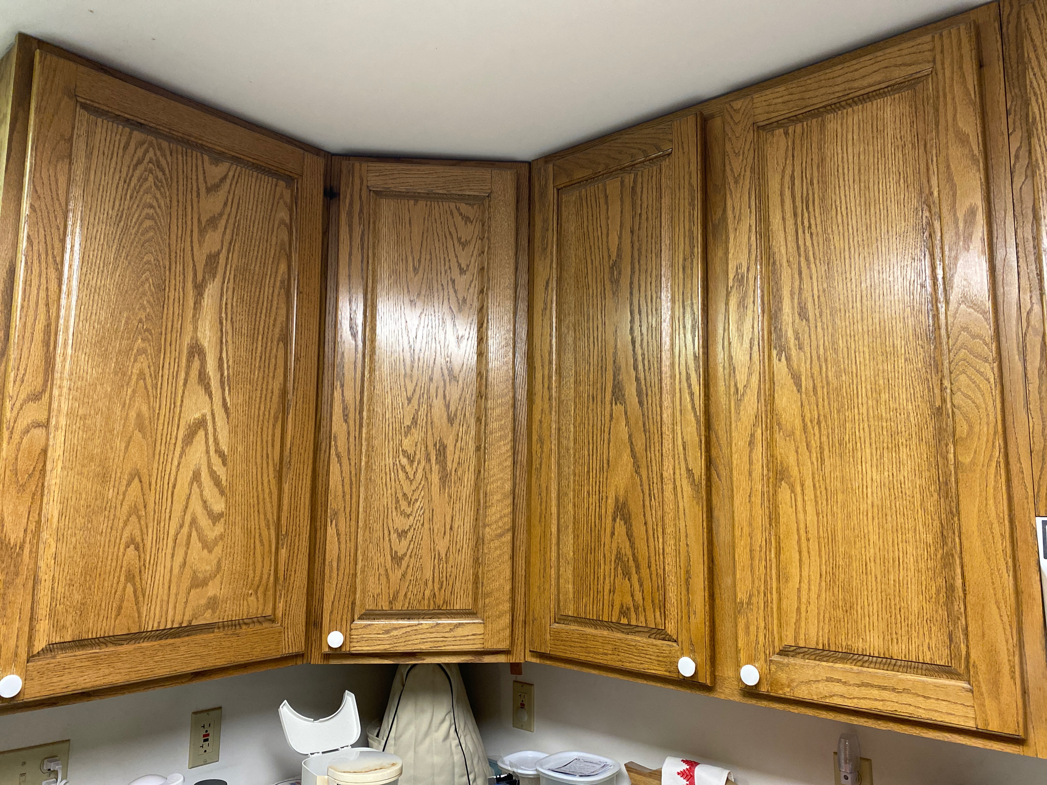

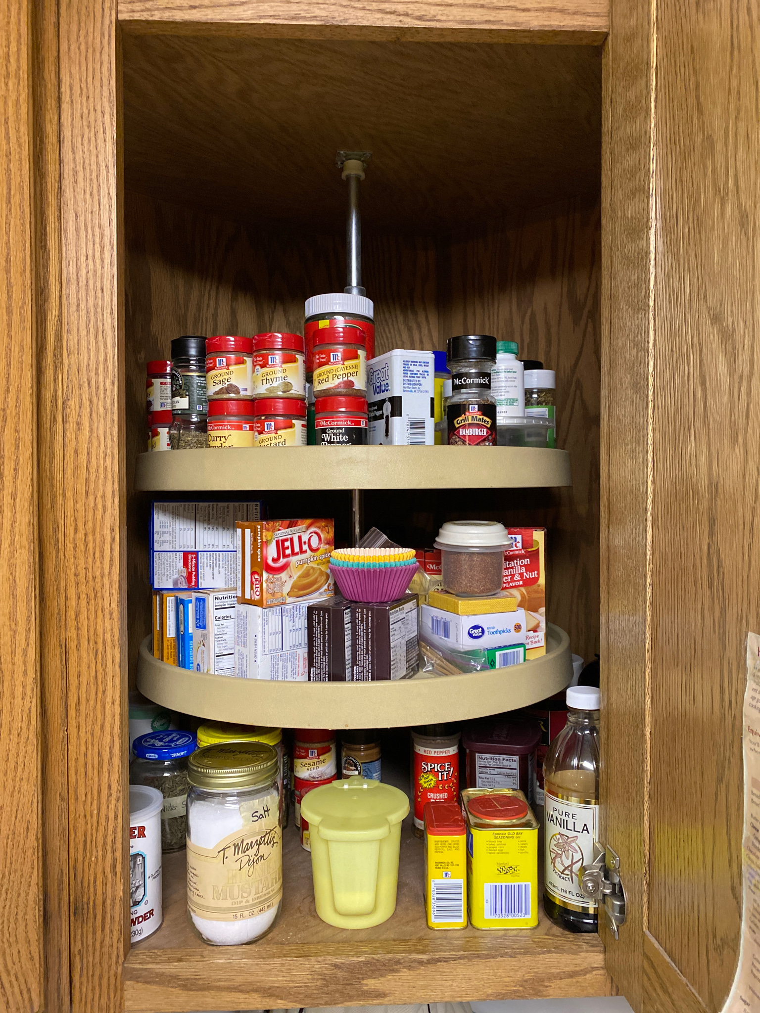

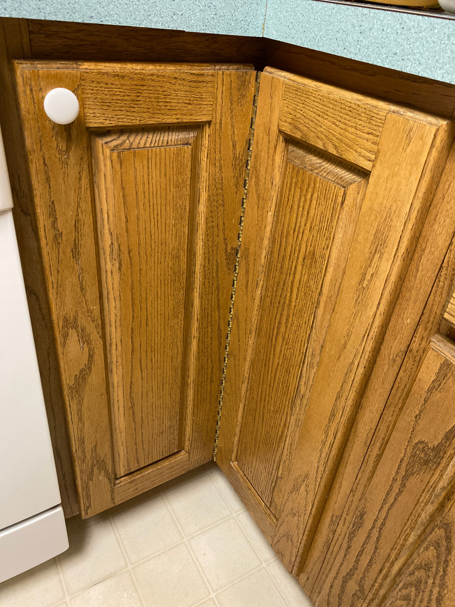

I already reported up to the 18th, it’s hard to wait to report the next thing. Lol
I see a lot of kitchen cabinets boxed out a foot at the top. I made mine go to the 8 ft ceiling for extra storage.
Lazy Susan in wall corner, piano hinged door for base corner.

When my dad built his house in 1981, he built in the 1' bulkhead over where the cabinets would go... then due to tight finances, thru together some plywood and 2x4 shelves until 1992 or 1993 when he could afford the oak cabinets my mom wanted... and tore out the bulkhead to, like you, make use of the extra storage space. And built a small rolling step ladder so my 5-foot-nothing mom could reach the top shelf!
