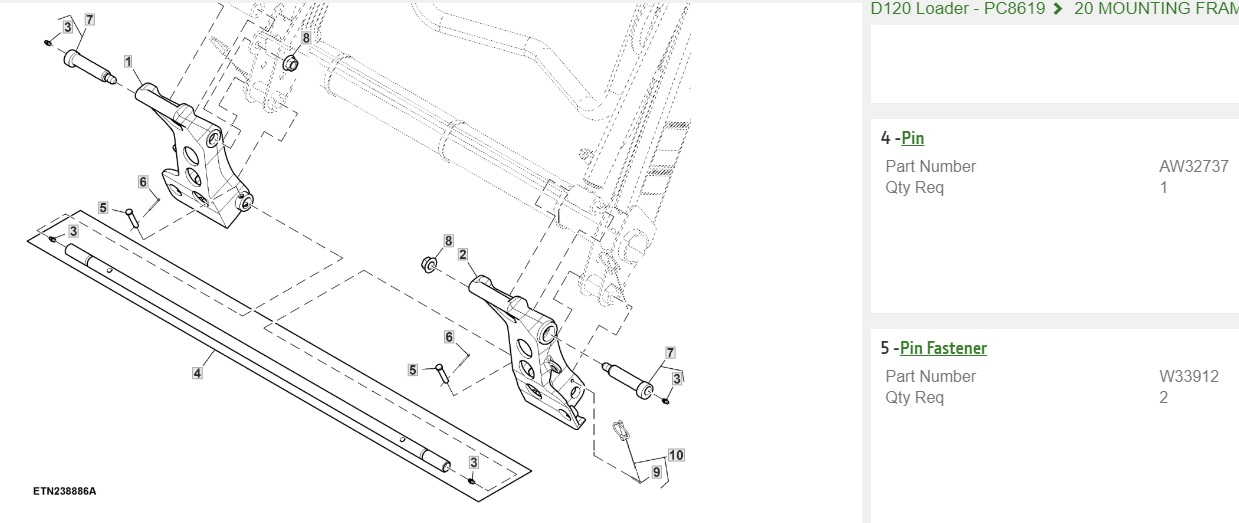

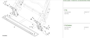

Likely this is the D120 FEL on the 1025R. The small pipe is only to keep the two brackets and tilt cylinders in time with each other, rather than one moving without the other making hooking onto the bucket difficult.
Here is the schematic of that timing bar key #4 showing the pins key #5 (mine is a single pin that is a 1/4" bolt that I put lock nut on to secure it). Is not the torsion tube up between the loader arms.
