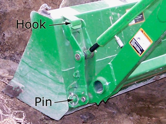

Hi all! Been a couple of years since I posted on here. Hope y’all are doing well.
I’ve noticed on my 2018 1025r that when I switch attachments on my loader arms, one seems dead or dragging compared to the other one. It was slight at first but now it is making putting an attachment on a bit annoying.
Anyone else have this experience? Suggestions on how to fix this?

One side has air instead of fluid in the cylinder. Easy fix. Run the loader down and hold it in bypass and it will expel the trapped air.

Not clear on your problem. What John Deere attachment system do you have?
Is it this style?
/ 1025r loader arms not working together #7
DK35vince hit the nail on the head, I think. The shear pin has broken and needs to be replaced.

First I've ever heard of that. Wonder, why did they use a shear pin in the torque tube? May be an excellent idea, just never heard of it before. I guess if you had a failure of some kind and it caused twist on the torque tube it would simply shear a pin rather than twist the tube??
/ 1025r loader arms not working together #11
I think it's a pretty good idea.
Just an "incidental" little pipe only intended to time the 2 sides as your attachment will do the hard work. Iirc it's maybe a 3/8 bolt that shears and a very simple fix.

Likely this is the D120 FEL on the 1025R. The small pipe is only to keep the two brackets and tilt cylinders in time with each other, rather than one moving without the other making hooking onto the bucket difficult.
Here is the schematic of that timing bar key #4 showing the pins key #5 (mine is a single pin that is a 1/4" bolt that I put lock nut on to secure it). Is not the torsion tube up between the loader arms.
