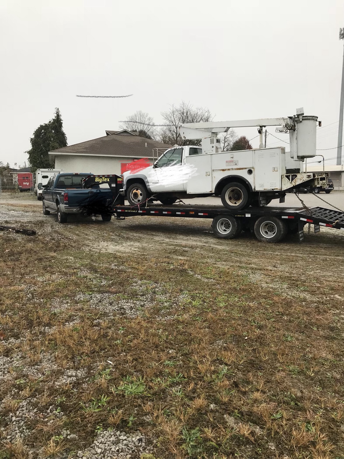

Can you just drive all the way to the front of the BP and chain down and be on your way? IMG_0520.JPG

I don't find it any more difficult to hook up to a GN.
But I understand that some people might have physical limitations that make it difficult.
