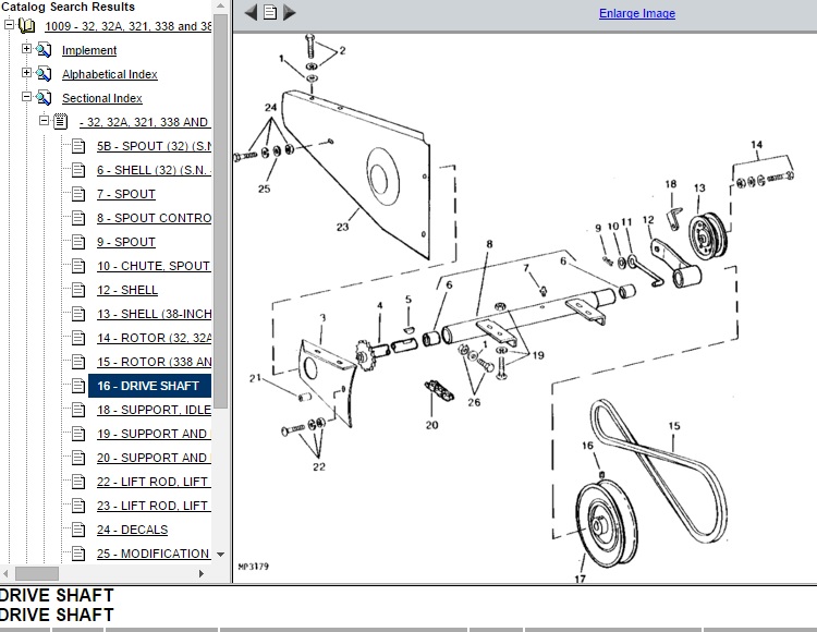

A pic or two of what you are faced with will help.
I believe the 338 is a snow thrower, not a snowblower. (just that there is an auger and a separate blower/fan for the snowblower).
But if that is the case, the rotor/auger also blows out the snow.
And there is a twist in the belt. Here is a schematic from jdparts.com

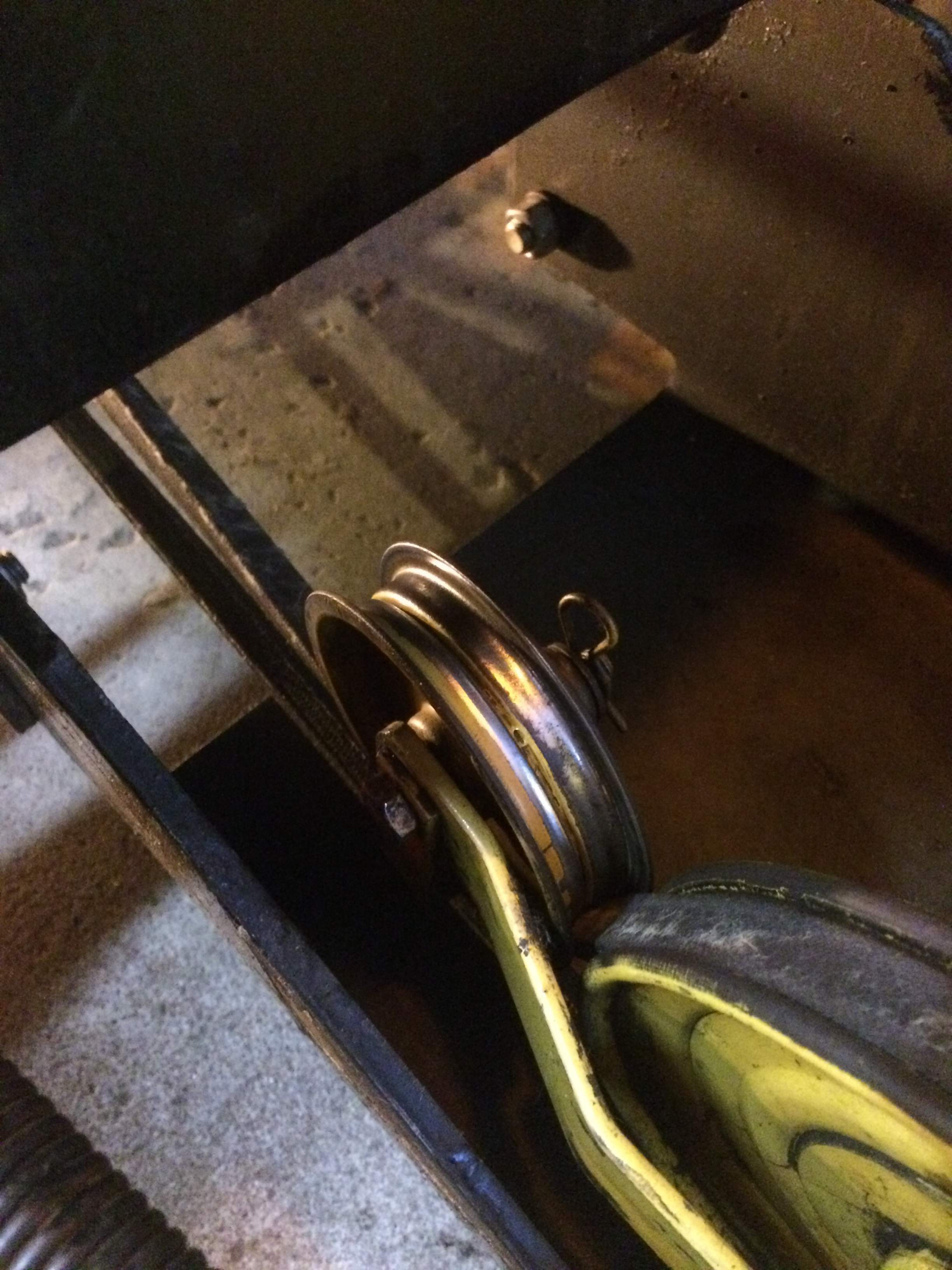

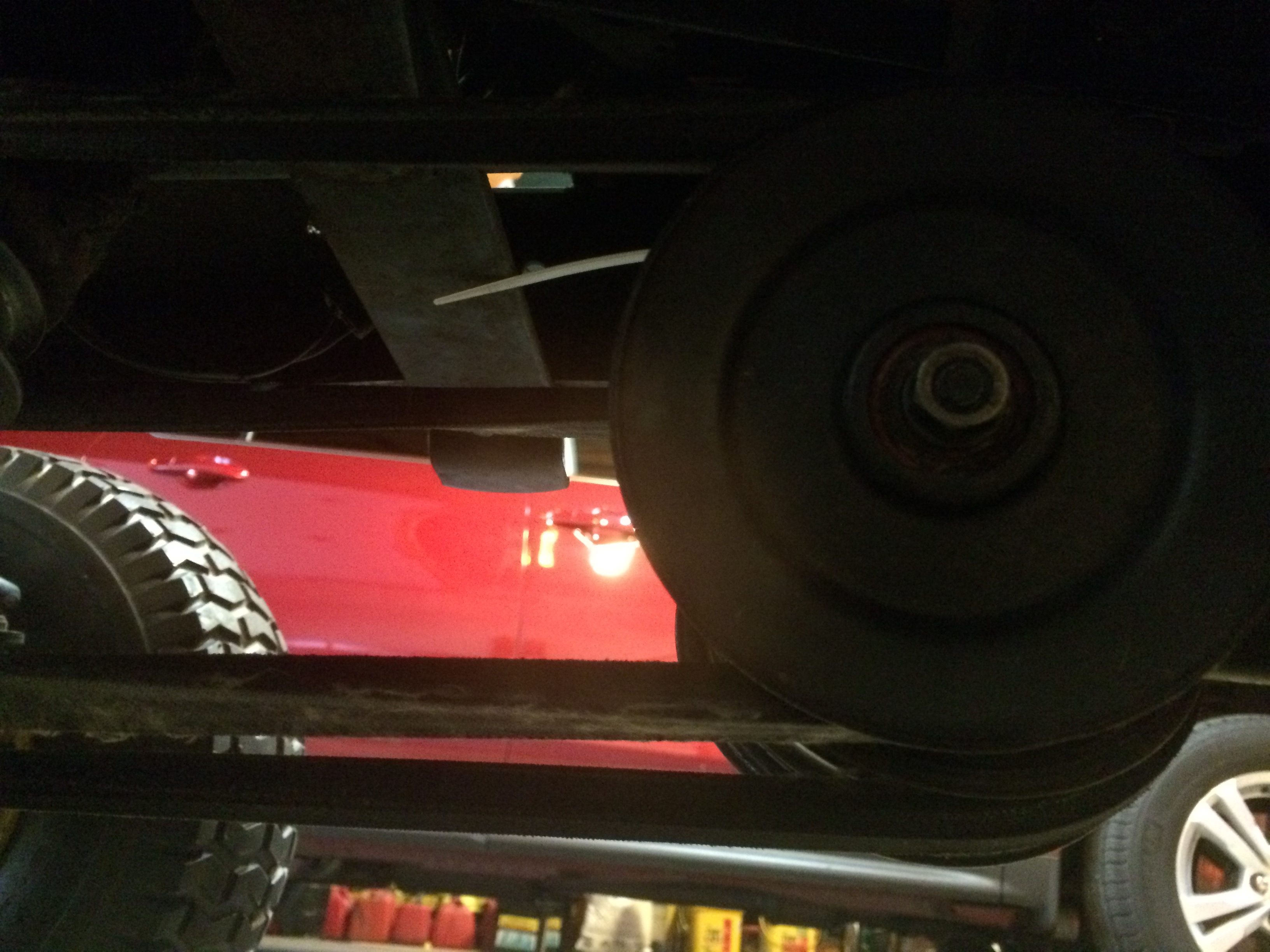

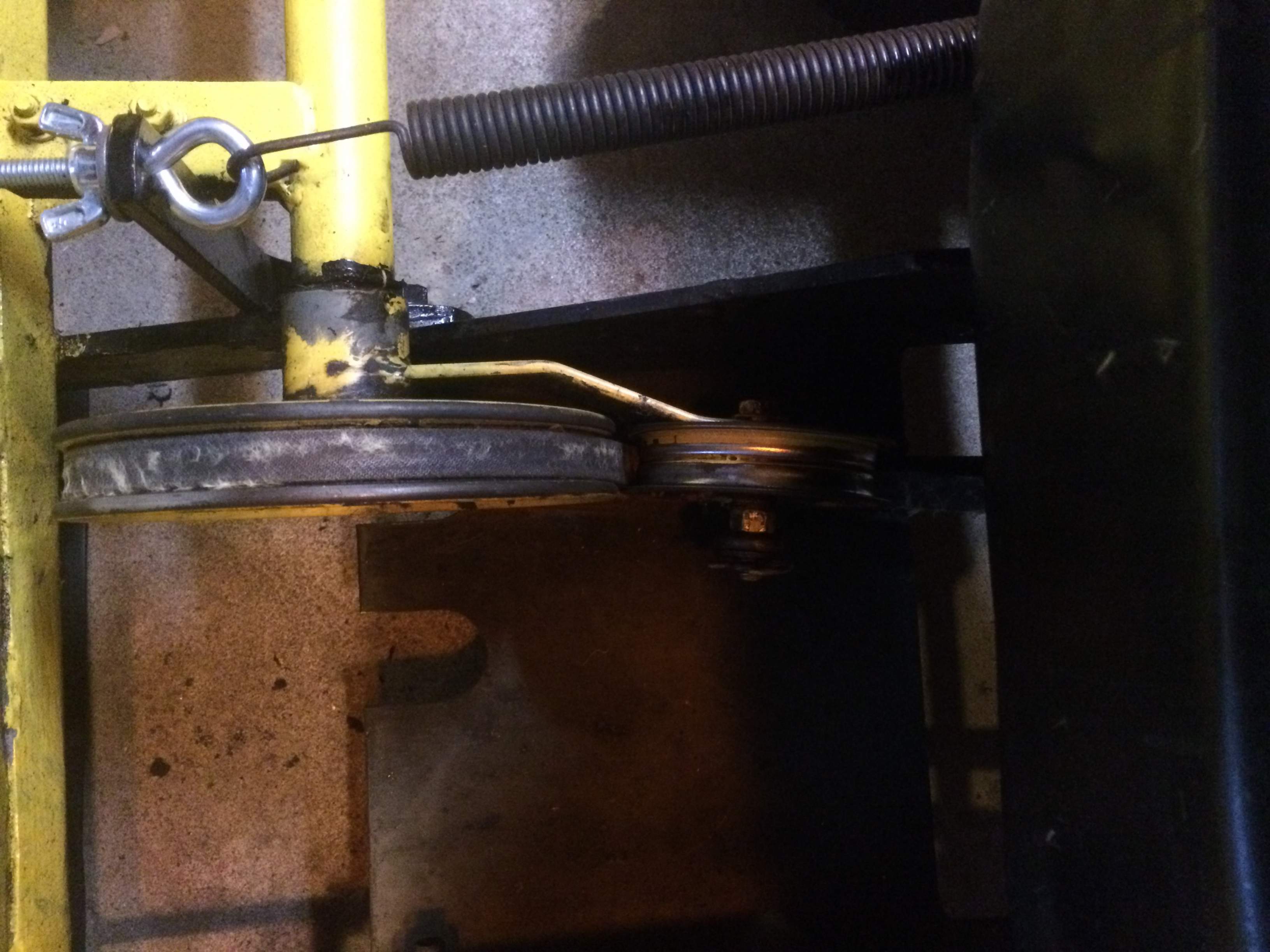

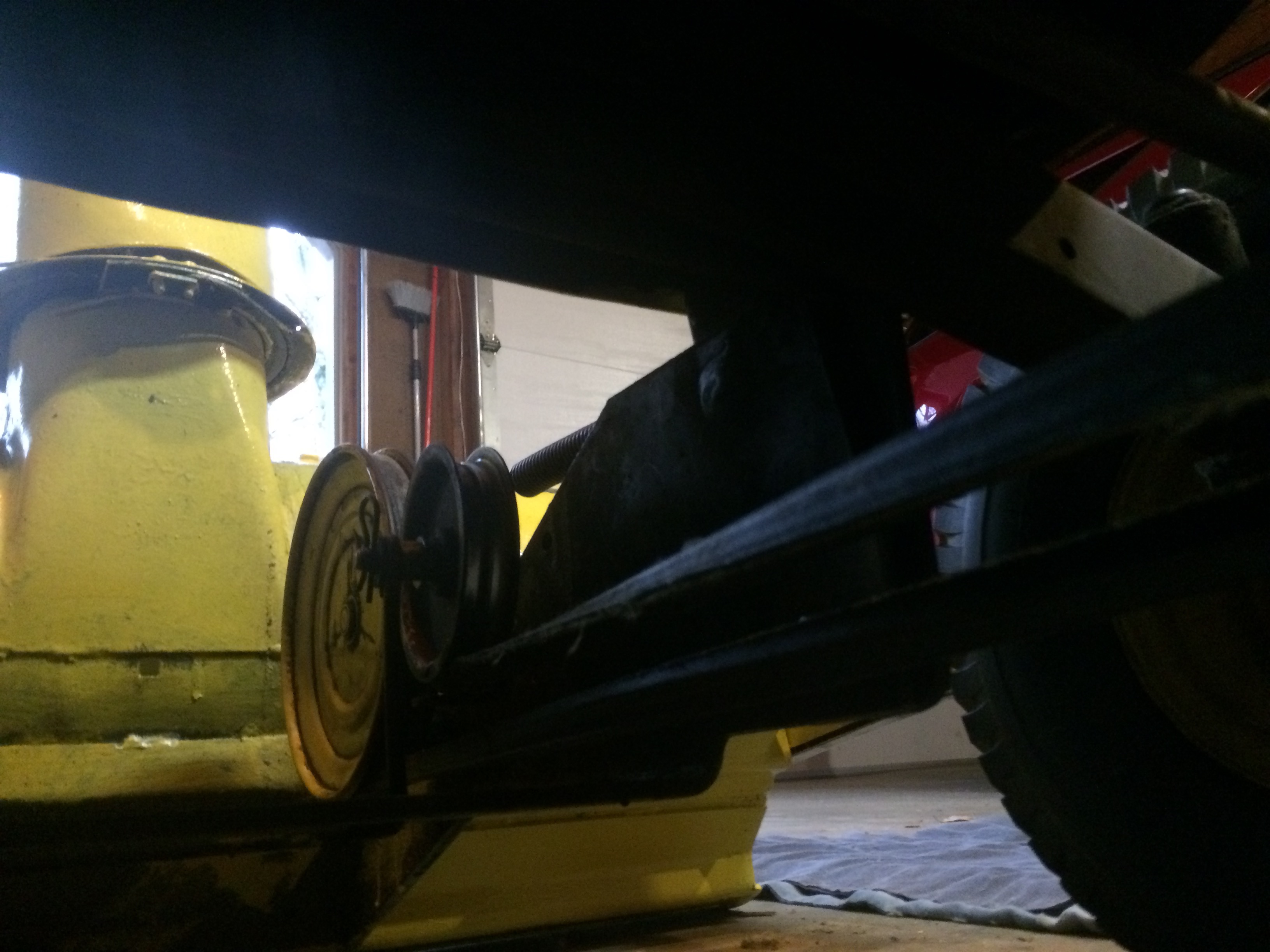

thank you beenthere
i stand corrected, this is a single stage snow thrower.
the diagram is a little misleading re. the belt. there is a drive pulley and tension pulley on the thrower. on the tractor there is a PTO pulley and 2 idler pulleys.
here are a few pictures.
thank you
bruce

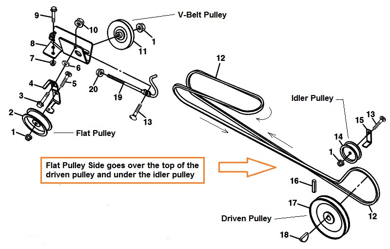

I think the belt is on wrong but I'm a little disoriented by the pictures.
/ 116 and the wrong way snowblower #5
Normal design has power/rotation PULLING on the driven device's input. In other words, the pulling side of a belt should never have an idler between the power source and the driven source. It's always on the take-up side. Note the direction of the belt motion in the diagram above. This shows the rotation of the PTO side (CCW from the bottom) PULLING directly on the driven pulley.
/ 116 and the wrong way snowblower #6
Thank you CCWKen,
this makes sense. He initially had the belt installed that way (correct) and that is when the edge of the belt started to fray. When I installed it (wrong) it appeared to follow in line with the idler. In the first picture notice how the idler is angled towards the left side of the tractor. When installed correctly, this angle creates a bend in the belt if it is routed towards the right (correct) side. In addition, the drive pulley is in alignment with the tensioner pulley when installed wrong.
I don't know the history of this tractor. I don't know how complete or correct the thrower is. I am assuming it is the correct thrower for this tractor.
thank you for your help,
bruce

Those throwers will run backwards nicely if the belt is routed wrong through the mule drive.
