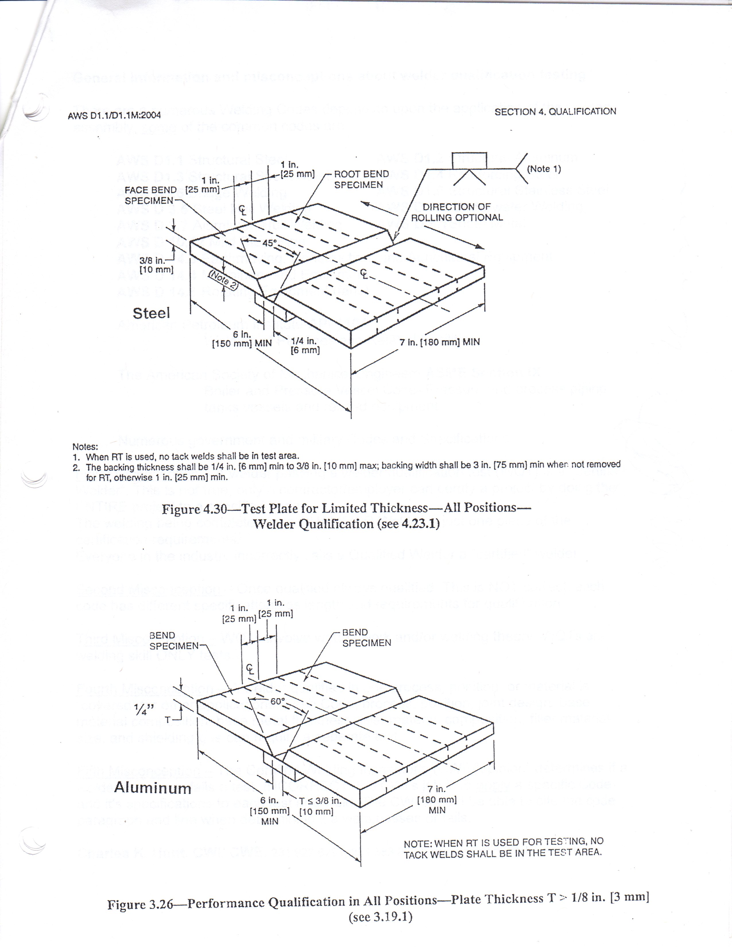

I just went out and tacked up the plates 27.5° (for a 55° included angle) bevel on each plate IRRC. 1/4" root gap I will weld them up in the am. I will weld them 3g uphill to give them the best chance of success. Just tacking these up taxed the welder so this is going to be a slow process.

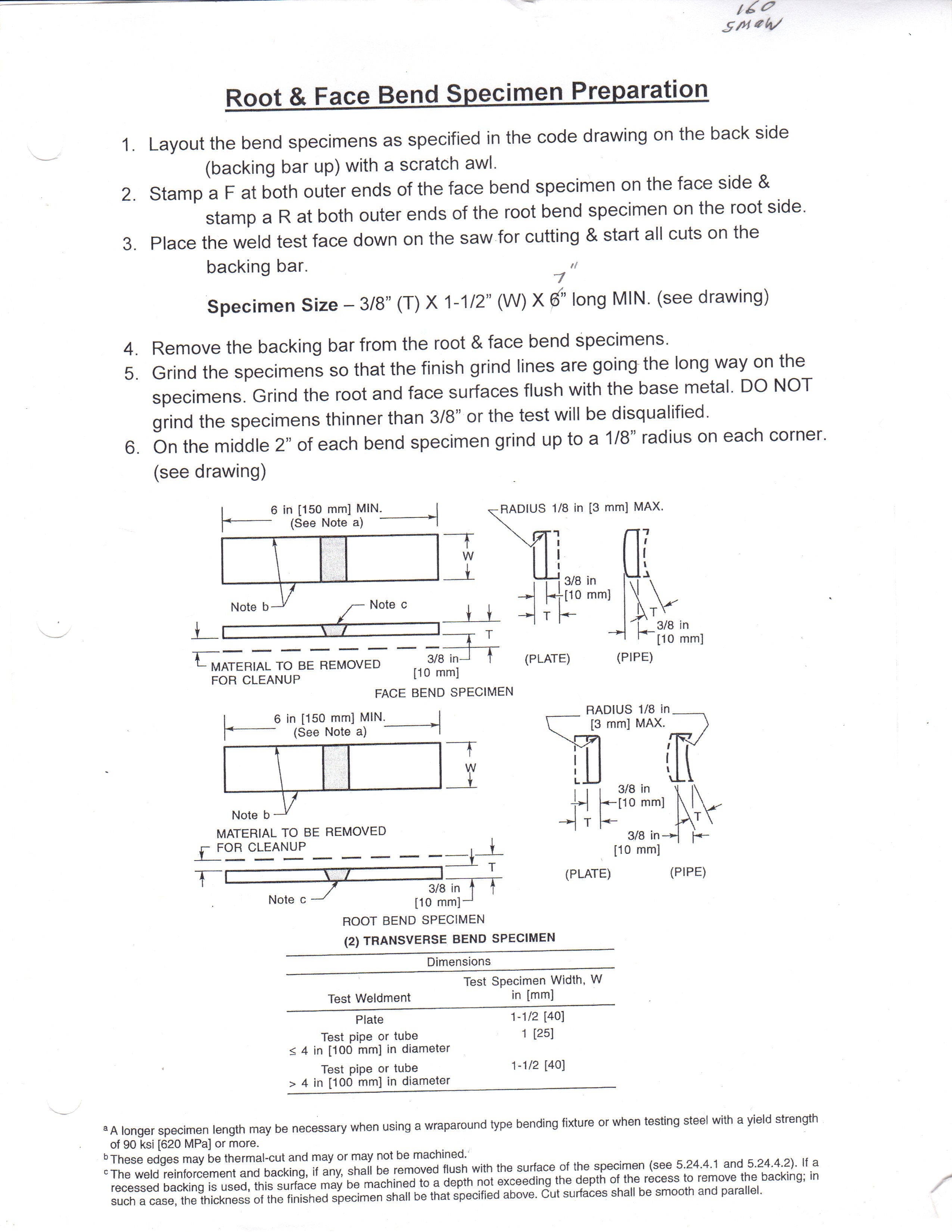

Is there any interest in the D1.1 nonclementure? It is around 5-6 pages. I will scan them and try if anybody wants to read it.
   / 120v MIG weld on a 3/8" thick (bevel 60deg) #34
That is a great idea. Please do. Those who want to learn will read and learn and those that do not won't..
   / 120v MIG weld on a 3/8" thick (bevel 60deg) #36
There is a tad bit more to doing this correctly than just welding it up.
