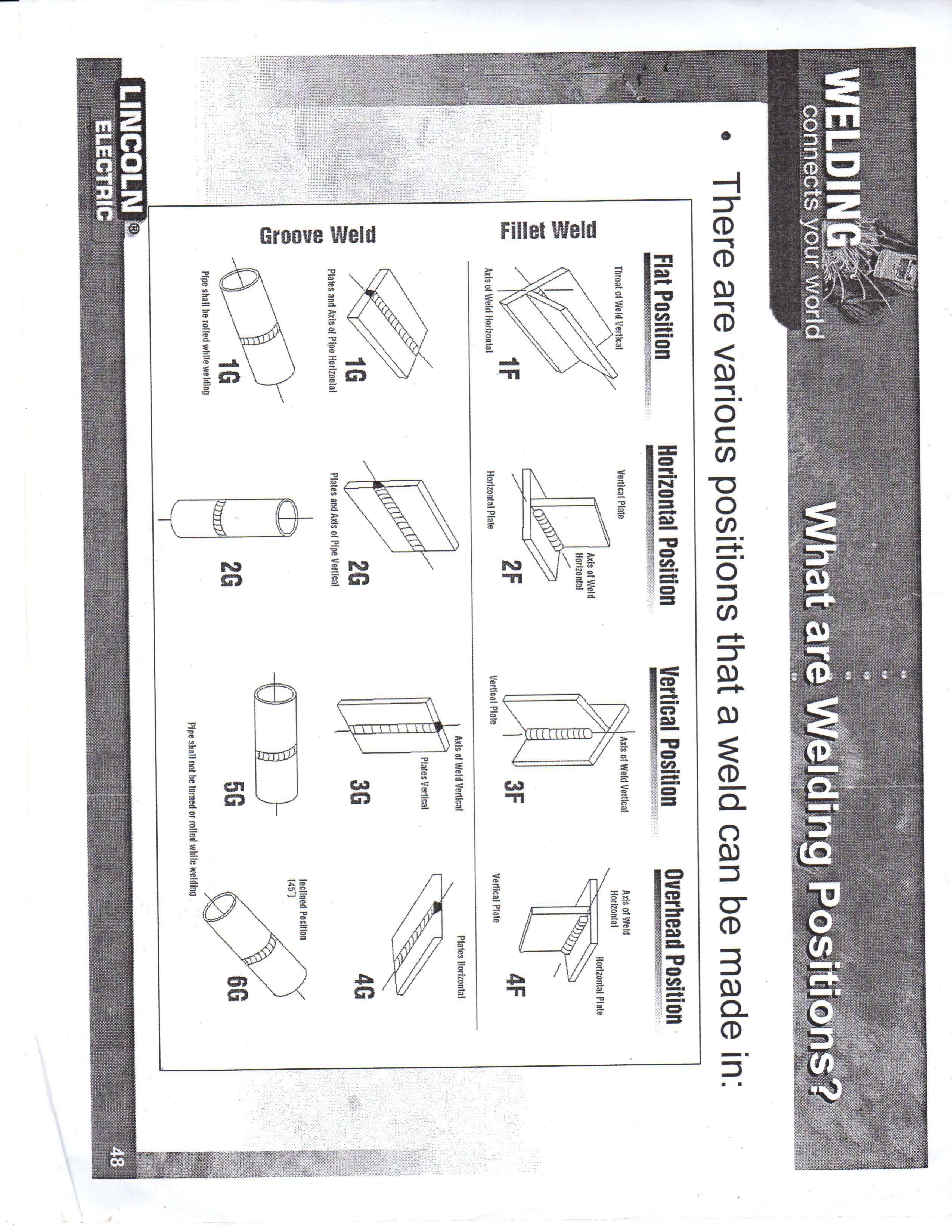

I just went out and tacked up the plates 27.5ー (for a 55ー included angle) bevel on each plate IRRC. 1/4" root gap I will weld them up in the am. I will weld them 3g uphill to give them the best chance of success. Just tacking these up taxed the welder so this is going to be a slow process.
Thx for the details! I welded mine (3 tests) level with 60deg groove (bout the same), but root gaps zero, 1/16" and 3/32".
What does 3g mean?
Understand "slow process" but its relative; nobody (?) will do this in a commercial setting. If it takes 3 minutes longer that's nothing.
