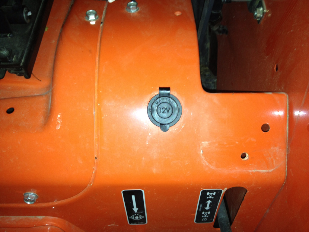

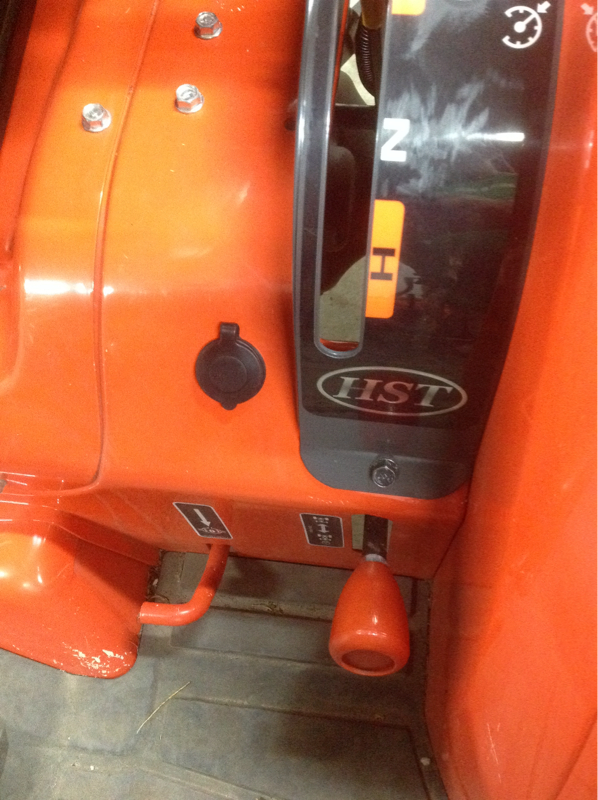

Mounted a fused cigarette lighter type plug on my Kubota. It is fused through a fuse block I installed but this particular circuit is always hot.

My Deere 2720 came with a 12 volt outlet under the seat. I cannot however plug in a standard auto plug and have it stay in the outlet. It looks as if it takes a "special" type of connector that twists and locks into the outlet. My Deere dealer is CLUELESS. I'd love to be able to use this outlet for my sprayer instead of running a line from my battery. Any help appreciated, New member as of this morning.
I just had to go look at mine. I didn't see anything special about it. I tried a couple plug in lights and found that one worked great and the other would blink if I jiggled the wire just a little but.
Have you tried to use any other plug-in to see how it works?

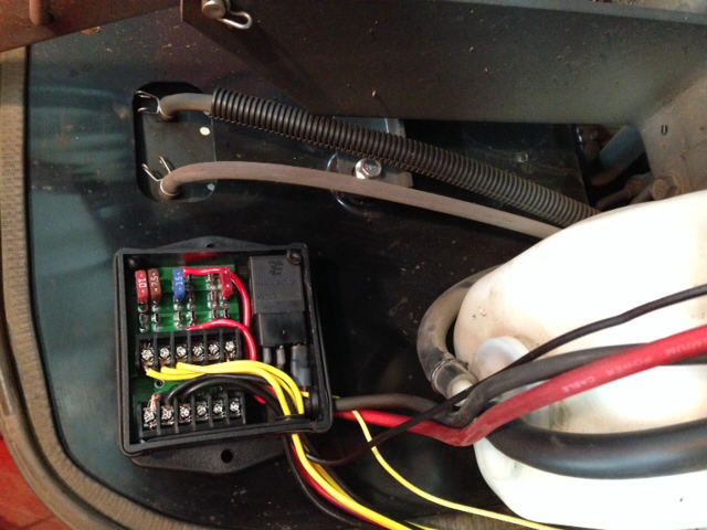

I did mine like wmonroe
I used a separate fuse block for the circuit.
the plug cover says Marinco 12 v Under the cover it says LOCK POINT Turn to UNLOCK. seems to suggest it is not a cig lighter kinda plugin. Never noticed marinco, i'll have to google that
   / 12v Accessory Outlet .... How Best to Do on Tractor? #17
You made me go look AGAIN. Now you have me interested enough to Google Marinco. They do offer a plug that locks into the receptacle. I am like your parts dealers, never heard of such a thing. There is a limited number of places near me to buy one, but Amazon has them for $10.

Several of you just did what I am intending to do- except my outlet will be used for winter storage trickle charging... should make it easy to plug in/ unplug the charger. My old tractor had a battery that was next to the seat and very accessible, but my new L3130's battery is hidden away, so a marine grade outlet is on order. May be overkill, but the battery in the old tractor was 13 years old and going strong when I sold it.
And, Thomas (AKA Kubota Tee) would you tell us where you got your new fuse block? That looks like a very useful addition!
