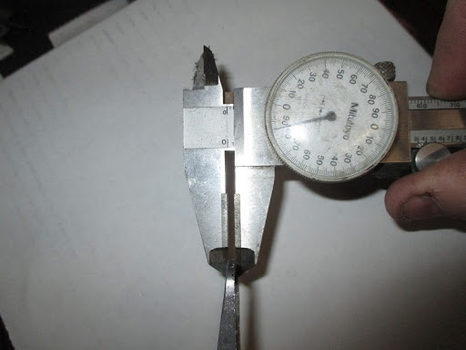

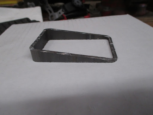

I have used abrasive saws for years in shops that I have worked in. I also have an abrasive chop saw that needs a new brush for the motor. When I had a moderate size project to complete this spring I jumped at the chance to buy the DeWalt D872. I didn't even take the time to fix the old abrasive saw that I already have. Best purchase I have made in years. I have about 300 cuts so far on the blade with great results. As for deflection there is none! I had some 2x3x11ga. tubing and I had to cut a mitered angle on it. So I cut the angle as close to the end as I could just to see how well it would do. See the photos and you can see how the piece came off of the saw. I measured the piece from side to side and there was less than .002" of taper in the part. I bought mine from Enco when they had a 25% off sale for a total of $412 to my door. I have a horizontal band saw as well, and it is gathering dust most of the time.
Clean, cool, repeatable cuts. It is worth every penny that I spent on it.
