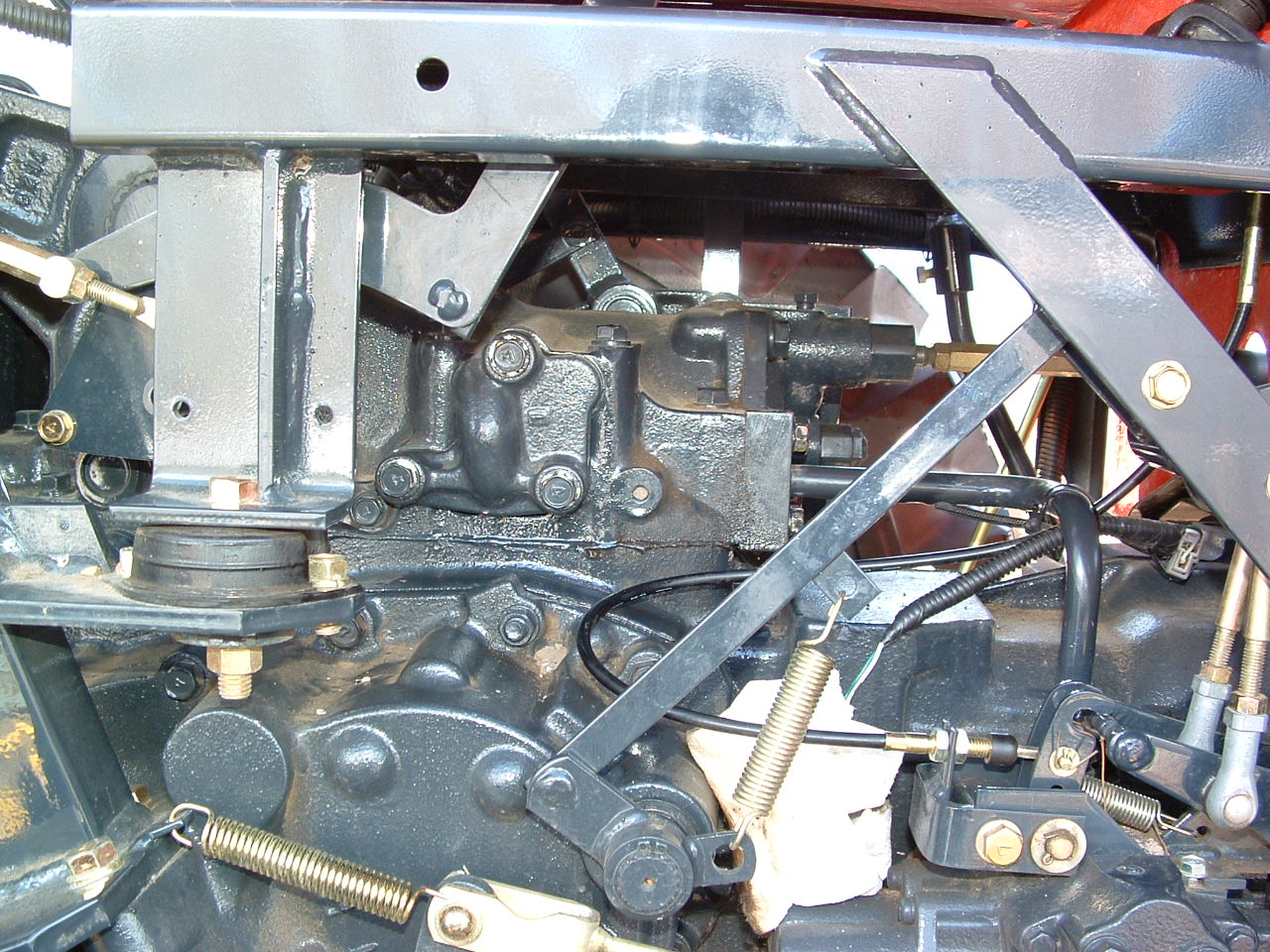

I have been researching the same thing for my 1532.... Here's what I think. If you look on the tranny/rearend housing behind your passenger rear tire you will see a triangular plate attached with three bolts. I believe this is the connection point for the auxiliary hydraulics but... you need the adapter plate. This may not be correct though. we need one of the dealers here to step in and lead us in the right direction and perhaps provide a part# (if i'm right)
I have narrowed it down to this because of my old 1984 Bolens (made by Iseki). I have a manual for the snowblower that also shows you how to hookup the auxiliary hydraulics to use them for the chute controls. I don't think the valves on or tractors are power beyond compatible.
I have asked my salesman and he didn't know, the parts guy can only sell me the dual remote kit and the tech I had come to my house said he thought I was right but had never installed one of the kits (He thought he noticed one of the other mechanics removing the plate in question)
Once you have the adaptor block it simply a matter of running the supply and return to your new valves.

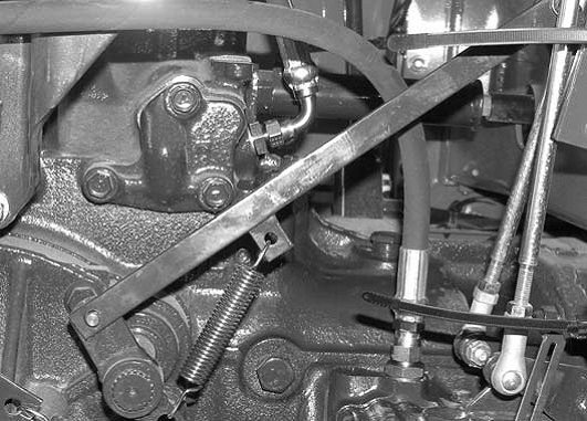

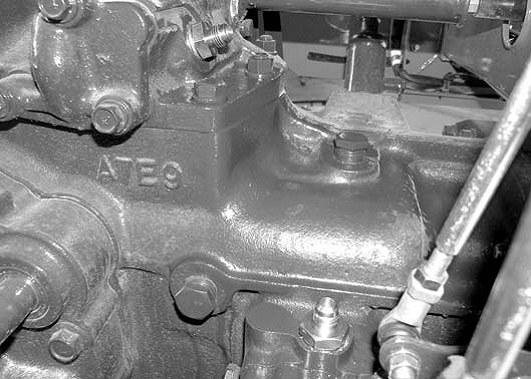

Image 1 is a 1529/32 without the factory valve
Image 2, 3 are a 1547 with a factory valve, that is why I was looking at the hard line that goes from behind the factory valve to the 3pt. You'll notice it also has the plate on the side and that may well be for remotes, but not for power beyond.
I'm going to have to remove that line to see if a fitting can be installed at the 3pt end. However before I install hydraulic lines and set it up I was hoping someone could confirm my hookup. I guess there are not allot of 1500s with the factory valve setup.

It hoos up just like a 1547 you have pictured. the power beyond ports are on the end plate of your loader valve.

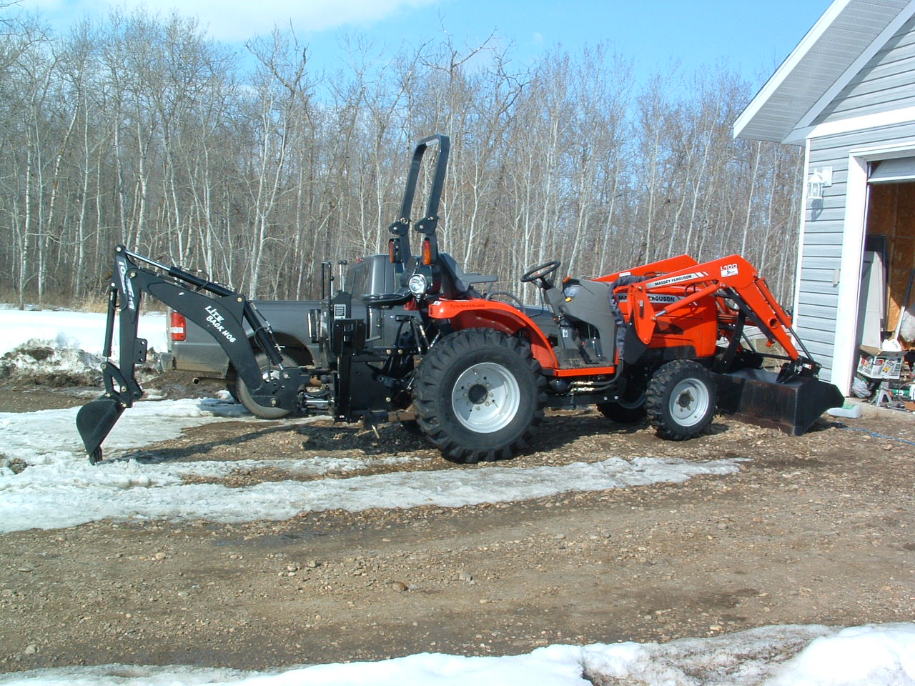

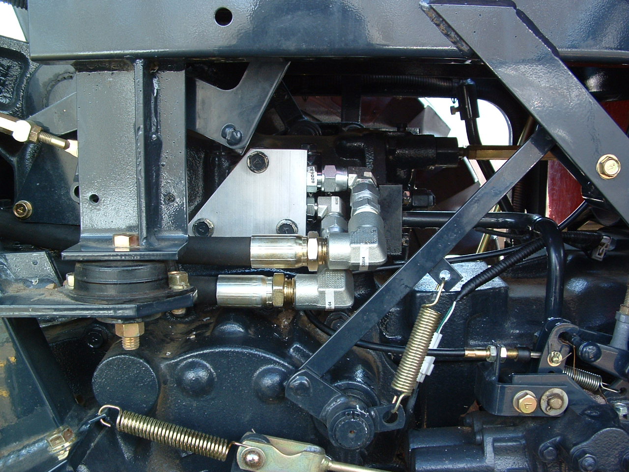

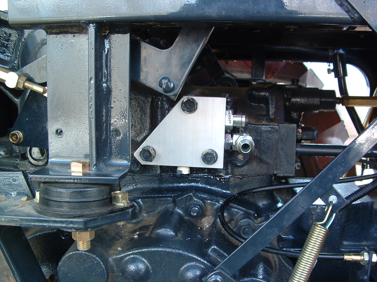

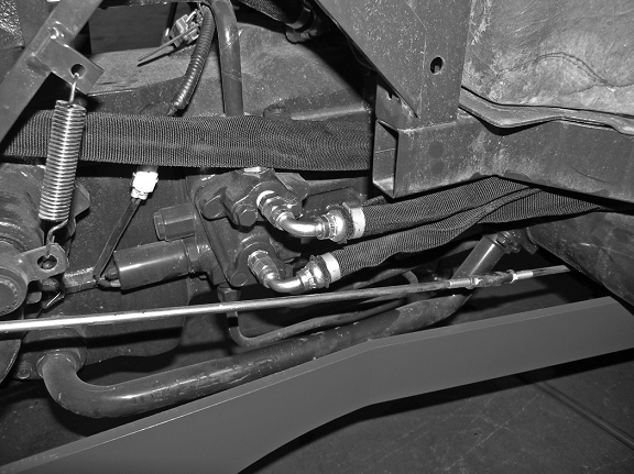

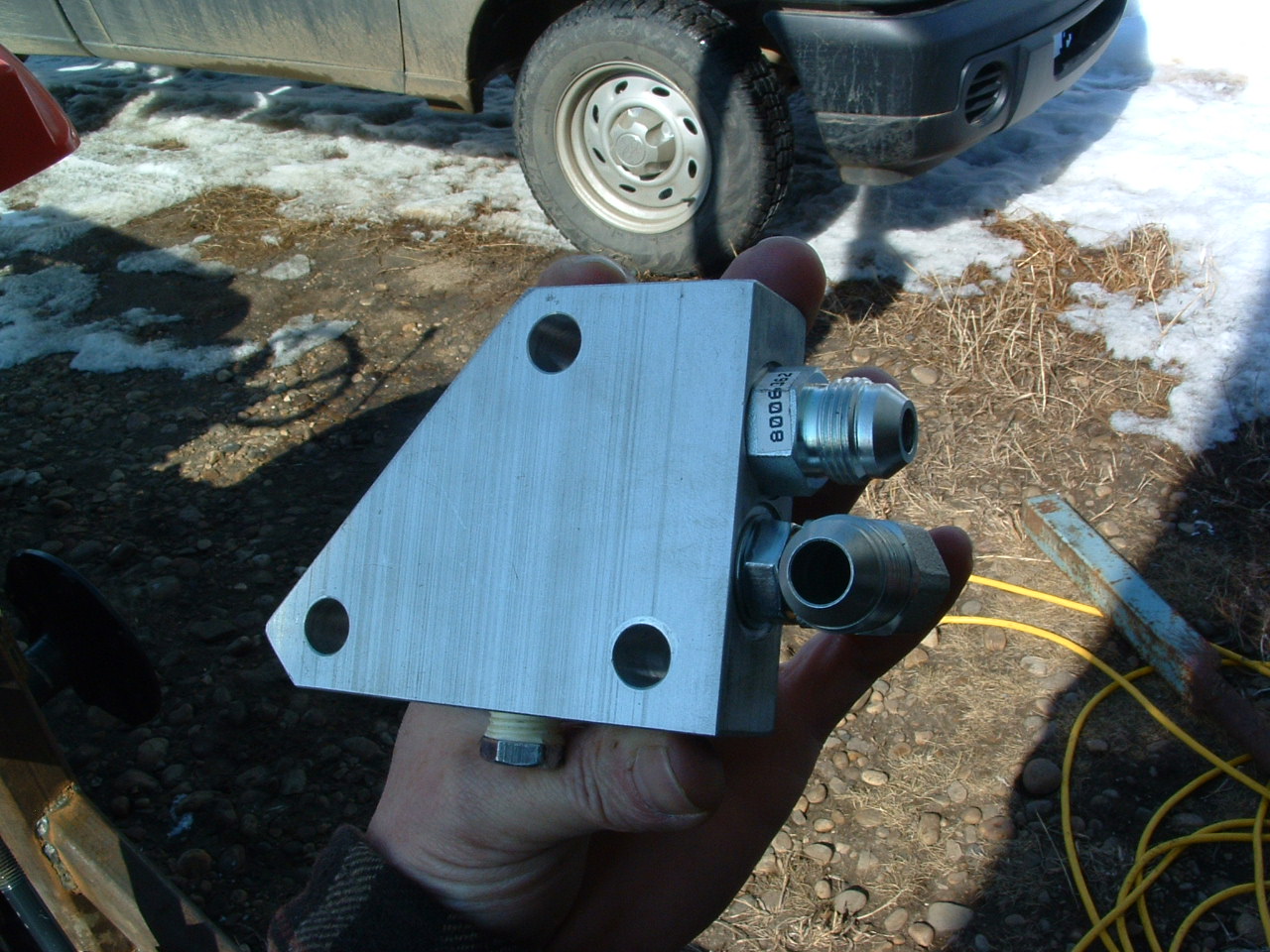

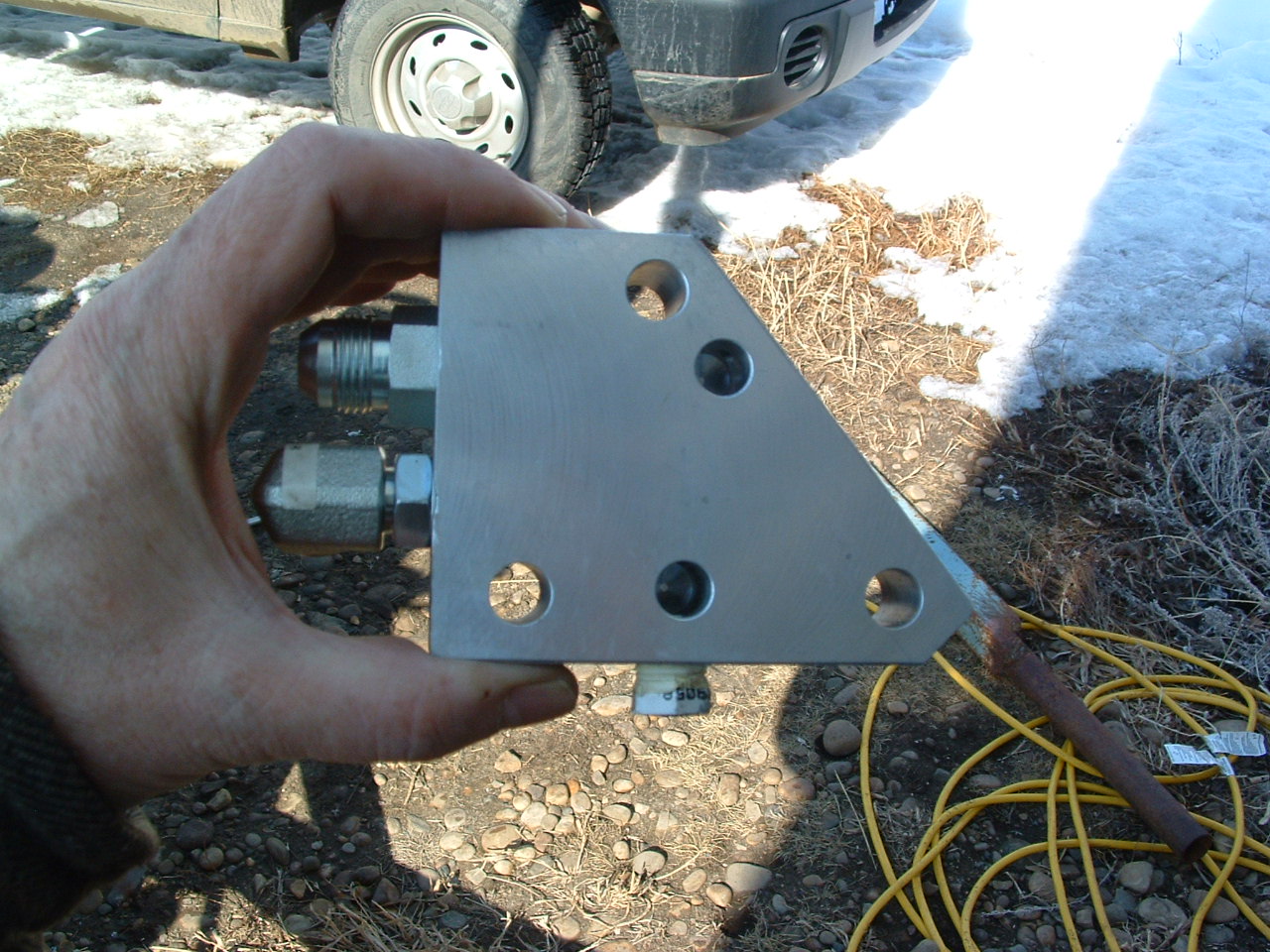

You are correct! I got my power beyond adapter plate, Massey likes to call it a manifold block, and installed it today. Part number for the kit is 4238611 it was $320 CDN. I just got the manifold block part number 1080516M1 it was only $120 CDN. Still kinda pricey but the extra 200 just gets you some 3/8 hose and quick couplers. Here are some pics of the manifold and installation

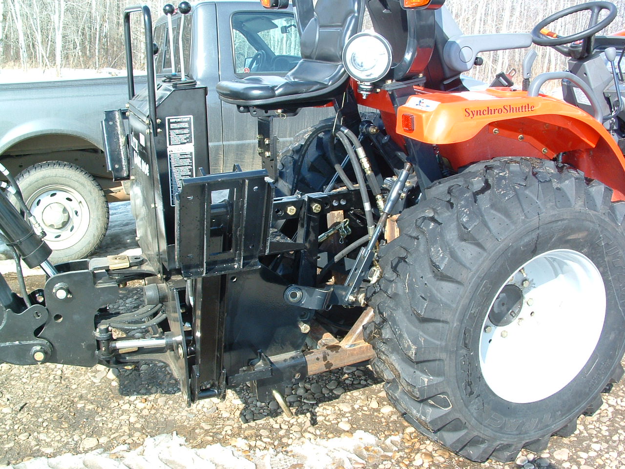

Also a shot of my backhoe on it's first test installation still have some fine tuning to do to the mount.

The part numbers posted will work for both the 1529 and 1532.
PB kit 4238611 comes with 3/8" hoses, quick connects, mounting plate and all required adapters and plugs.
1080516M1 is just the manifold block, you will also need a 1/4 pipe thread plug, quick connects to match your backhoe and 2 adapters from #6 ORB (o-ring boss) to what ever fittings you need for your hoses and of course the hoses.
You have 2 options for the return line from your backhoe
1. you could run a zero pressure return line to the plug on the R/H side of your differential, you would then not be able to move your 3 pt when the backhoe is connected
2. you can run the return line into the upper port of the manifold block. This would leave you 3 pt functional, but be carful you don't want to lift anything heavy or you may damage your backhoe valve.
I went with option 2 that way I can still move the 3pt arms out of the way when installing the backhoe.
Whatever choice you make the pressure and return lines from the manifold block must be connected to each other when the backhoe is removed. This provides hydraulic fluid flow required in an open center system. Also make sure the tractor is turned off when you disconnect and connect the lines.
