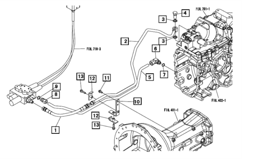

Doughknob: This tractor came with a backhoe attached. When the backhoe is removed there are 3 lines left disconnected. Two of these lines have to be connected together for the 3 point to work, it is like a power beyond connection. The third line has a different connector so it can not be connected incorrectly.
CH4 and Kan: there is a knob under the seat. This is similar to what you are describing. I have seen others say this could be the problem as well as there is a youtube video of this being the problem. I have turned it back and forth several times with the tractor running and off but no response. I think that either the hoses are connected wrong (came with the wrong configuration of connectors) or the control knob has a valve that is not working.

Tinhack: thanks, the 3 point hitch can be lifted by hand and just falls right back down, no resistance, full up and down, the arms just stay in the down position all the time right now
I found some hydraulic diagrams on Mahindra website and will try to follow these next time I have a chance to look at the tractor. I also found a site that says how to check the speed valve (draft control knob)

The knob is rate of drop, that's not what is wrong. The tank and PB lines are not right, the fitting must be wrong. Is the engine dropping rpm when you try and use the 3pt.and are any hoses moving at start up?

The engine RPM seem to drop when I unhook the 2 that are currently able to be connected. There is fluid present when they are unhooked and the engine is running. Sorry, but I don't remember if both have fluid whe in press the center pin or not. The one remaining hose has a smaller male connector. I did not check to see if fluid will come out of this hose with the engine running. I get no response with trying to raise or lower the 3 point. I have not watched the hoses when the engine is started. Thanks for the reply.

OK, so i got a few minutes to look at the tractor yesterday and chase the hoses. The hose in this diagram labeled 2 is a steel line that goes to a rubber line that stays disconnected when the backhoe is off of the tractor. Is this correct? the other two hoses going to the tractor that are connected togher go to the block pictured in the diagram. This is where the draft knob is located so I was thinking this needs hydraulic fluid/pressure? Any help would be appreciated. I won't be able to go back to look at the tractor until later this week.

Thanks K5lwq. I have tried the control knob and nothing. I will post pics after this weekend. The tractor is 1.5 hour away and I only get there once a week. In the diagram above the #2 line is going to the valve block but right now on my tractor it is not connected to anything. This line #2 is just in front of the 3 point area connected by a banjo nut (#4 in the diagram) which is just behind and left of the draft control knob. In the diagram, it goes to the block for the hydraulic valves. I'm thinking this has to supply hydraulic fluid to the 3 point. The 2 other lines for the back hoe are connected and these make a loop to go back to the valve block. There are 2 male connections and one female, The male connections are 2 different sizes so they shouldn't be able to be hooked up wrong.
