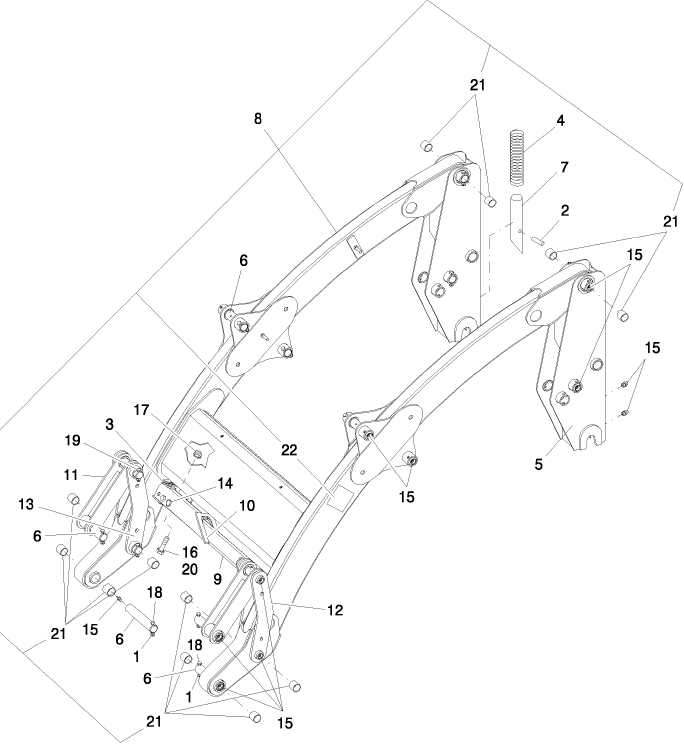

I'm curious how these parts would actually work. Unless you press fit them into the loader frame they could possibly spin (since the greased part of the pin would be only touching the inside part of #21).

I'm in the same boat. I measured the bore on the main bucket pin and I got 1.3". The Pin seems to be 1.25" so I have .05" of play (almost 1/16" feels like more than it sounds like). Did you notice in the diagram that it says for some part number and later? My 16LA does not have replaceable bushings so I'm wondering how this would work. Do I bore it out to take the bushing? That seems dicey for me (at home) as you need precise alignment with the other loader bore (so that the bucket rotates around a common axis). When I was at the dealer the other day I priced these parts and I think they were ~$2.70 each.

Rick, my loader is YL350697 and the parts list says this bushing is on YL365872 and after. That makes me believe my loader will have to be bored for the bushings to fit. That's probably true for Peter's loader too.

Good questions. On the picture I measured the leftmost lower bucket bore. I must admit I took just a few measurements (for example I didn't get max and mins and did not measure vertically). Last weekend I actually took apart the entire 4 link area and cleaned my ten years of accumulated grease and dirt. It certainly did not look like the bores are replaceable (although if they are pressed in it might be hard to tell).
The other option of course is to have a new over-sized pins made. Out of curiosity what is the optimal fit (how tight should it be)?
If I had my choice I would re-engineer how these pins work. I'd like a mechanism which actually traps the grease between the bore and pin say an "O" ring fitted to both pin ends (just inside the bore). Since the old grease couldn't be pumped out of the bore (past the "O" rings, I'd create a relief port (much like the grease intake) that permits old grease to exit ultimately from the center of the pin (opposite the intake side). I'd fit this exit port with a screw that would trap the grease. When you grease the tractor you'd remove the screw to permit the old grease to be pumped away. Otherwise the screw would be in and trapping the grease until the next change.

The bucket mount pin bores are not the primary wear point. The pin is trapped by the cross bolt and does not rotate in, or wear significantly on, the pin bores mounted to the bucket. Also true of the loader boom mounts bolted to the midpoint of the tractor.
You can do as you wish, but for my money you are overthinking this by a huge factor. Loader pins and bushings are not meant to be a close machined fit, and creating close tolerances in these areas has a highly unattractive cost/benefit ratio. Frequent applications of modest amounts of whatever grease is readily available is all that is required to keep everything working properly for years or thousands of hours.
I guess I have to disagree Rick. I know I have used my pre-bushings loader hard, but I also greased it alot. The bore holes in the loader arms for the bucket do wear. Once they start to wear, they hold grease ever more poorly -which accelerates the wear. My pins look like new! It makes no sense whatsoever to have harder pins than non-renewable bores, that is an absolute bassackwards design flaw.
