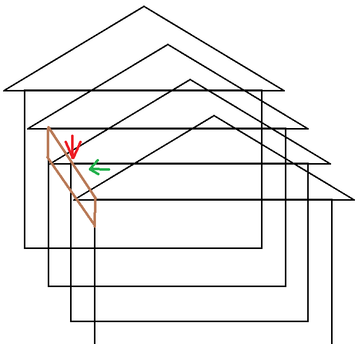

keep in mind, it is not all "down ward" force you are looking at. but also side ways force as well.

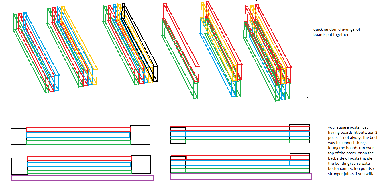

random beam drawings.

For built up beams (2x, and plywood etc...) a quality (polyurethane etc.) construction adhesive applied solidly with a roller to all internal surfaces will help decrease deflection...
Since this beam is not going to have any lateral (side) loads a strict (engineered) nailing pattern is not critical...

Boogen....the sideways force should be minimal since it will be trusses and not rafters.
I have a made-up beam in my head at the moment. Let me sketch it out and will post.
Just don't think a pair (or even 3) 2x12's side x side with plywood is gonna be enough. I don't think even a pair of 14-16",lvl's will be sufficient.
The beam I propose I think will be stronger.
