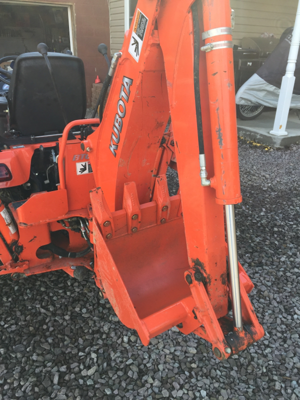

I destroyed my 10 bucket on my 23 I had to totally rebuild it here it's so rocky here I've found a small bucket digs better I get a rock or root in every bite

Nice work. Now you just need to fab up some kind of quick change system so you can swap buckets real fast. A member by the name 4shorts made one for his BX25 and put a video on youtube. Seems he doesn't post here all that much anymore, but you might check out his youtube video for more ideas. Again, nice work.
Ya I know Paul I've bin watching his videos for a couple of years. He didn't like it when someone copied his quick coupler as I seen all the drama from the posts on this site about it. It only took me around 5 minutes to change my buckets. Take out the single bolt for each pin an the pins pull out an put the other bucket on. I asked Paul why he took most of the pictures down on this site an he said that something was going on with his photo bucket account.

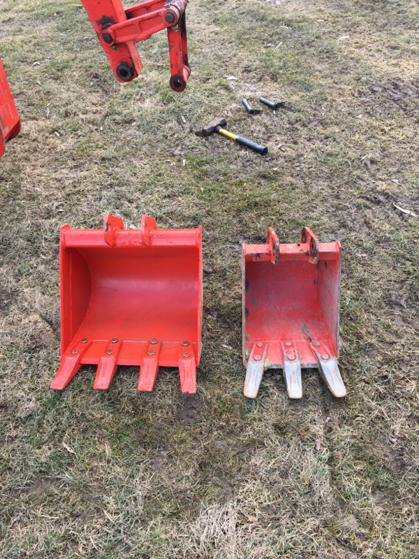

Ya we have some rocky soil around that's why I went with the 100,000 yield steel for the sides/ scrapers an the Hardox for the main cutting edge. I'm going to build a 8" bucket out of the same steel in the spring. I'd rather over build it then have to repair it all the time.

I realized quick how important it is to inspect your bucket daily.one stress crack one minute and your tearing it open like a beer tab the next

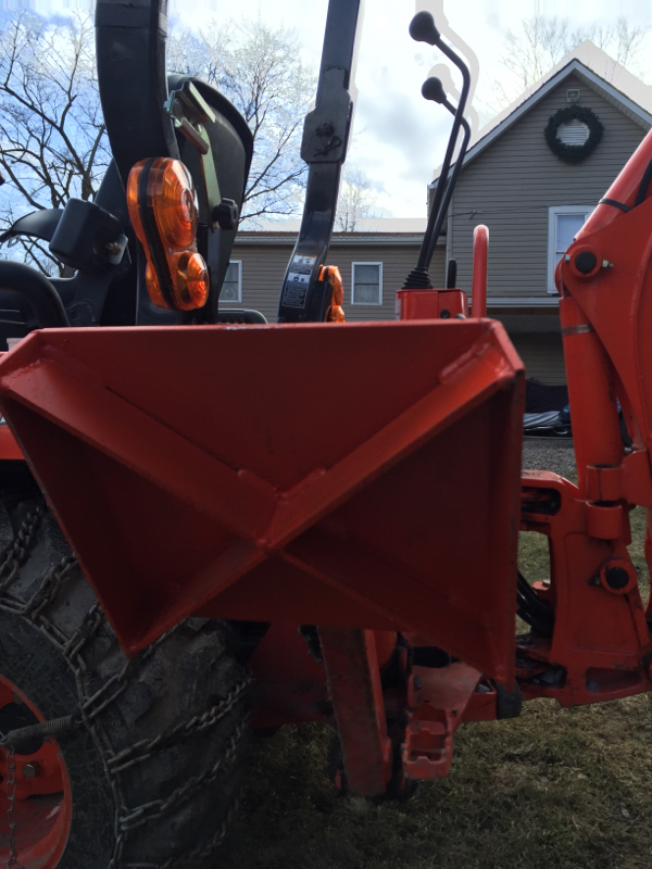

Nice build on the bucket. Clever using the original bucket as a form to make the new one.

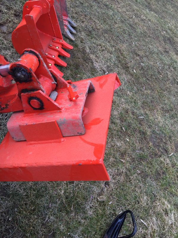

image-171509007.jpg image-934769932.jpg image-4194637620.jpgweather got good enough to put it back on an do some digging. The bigger stabilizer pads work great and are removable with one t bolt. image-2140072089.jpg
