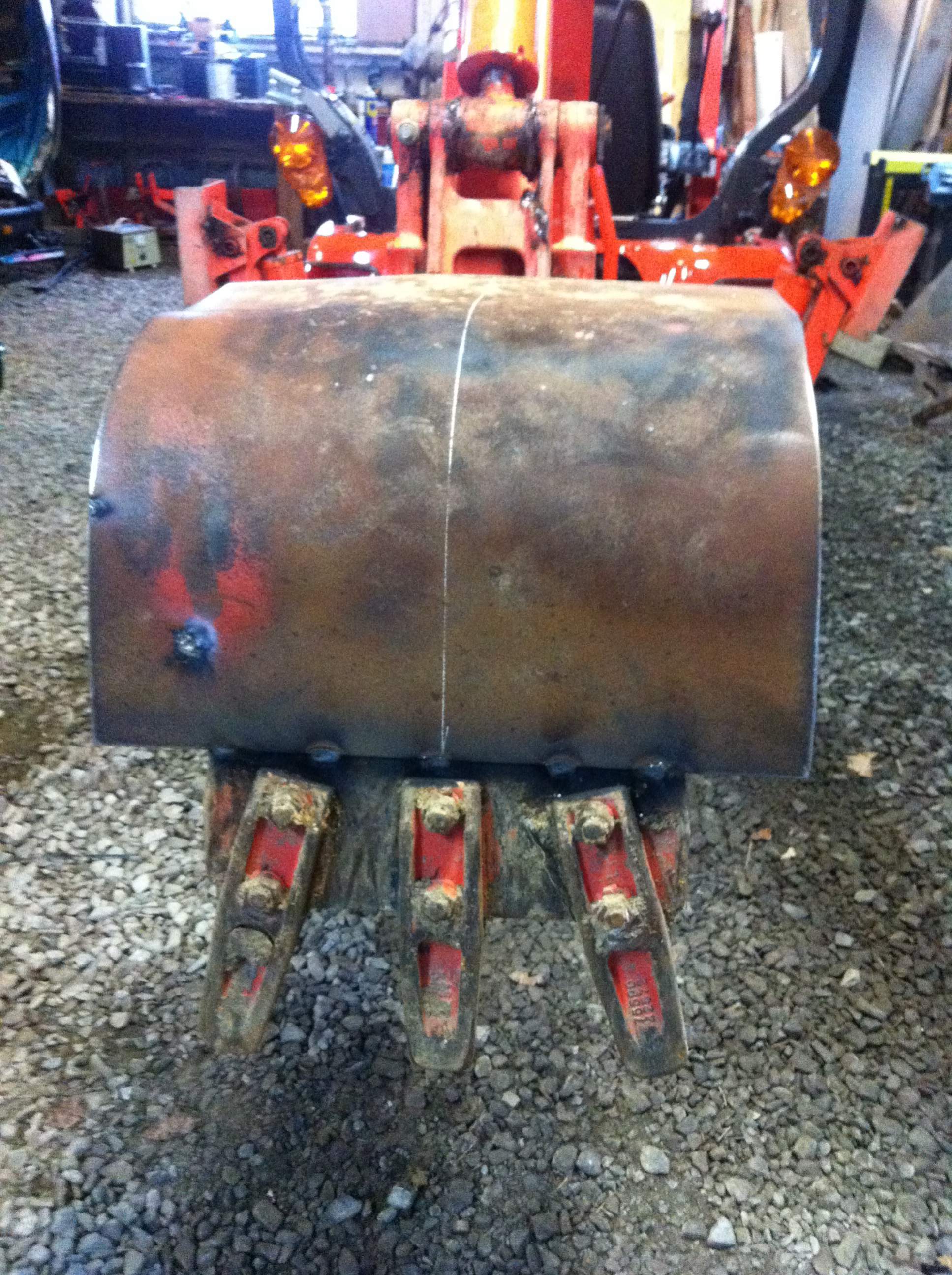

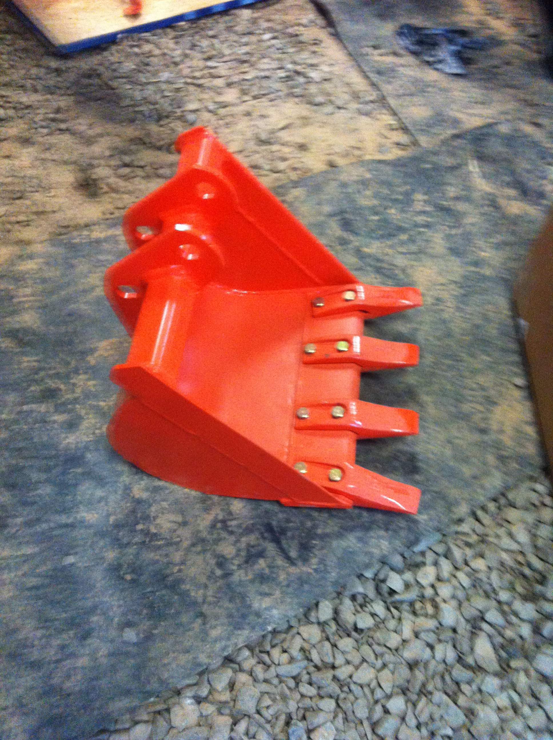

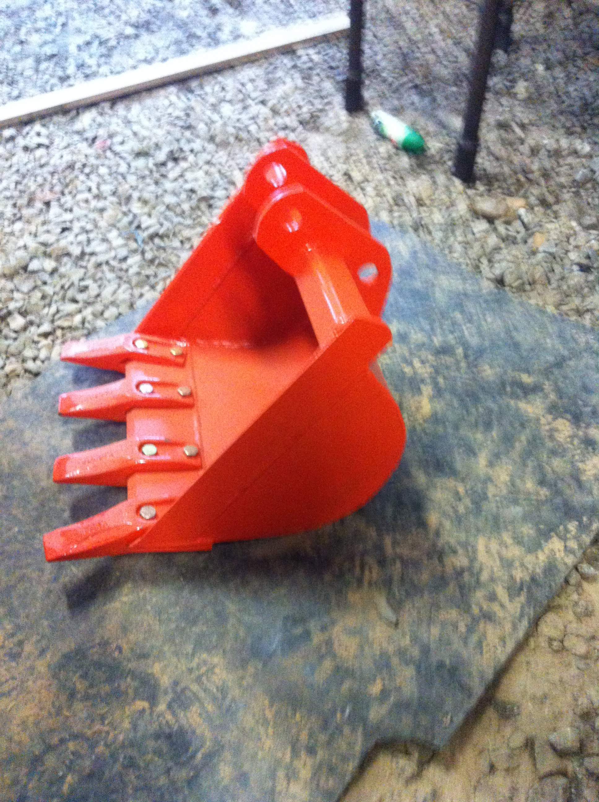

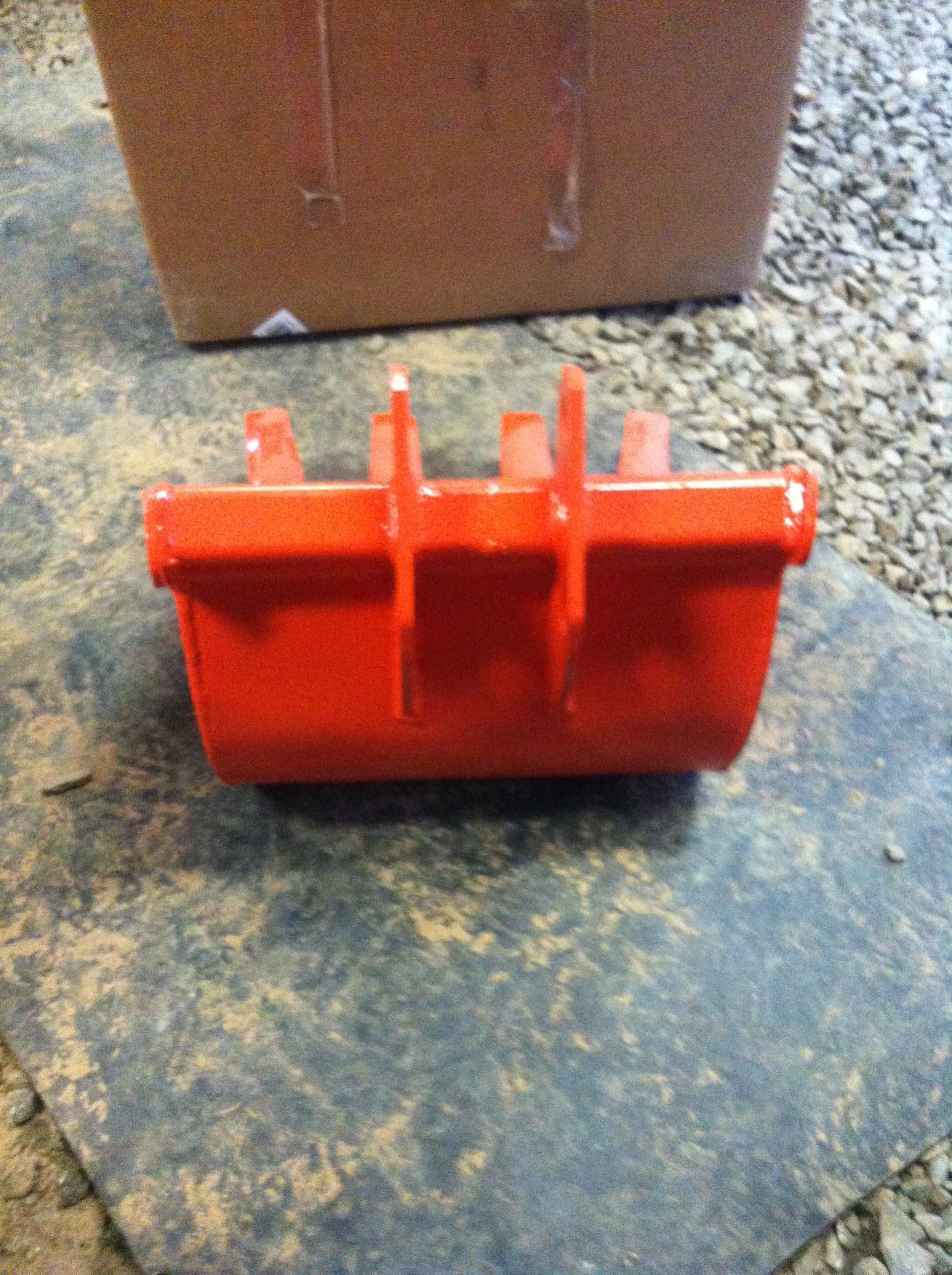

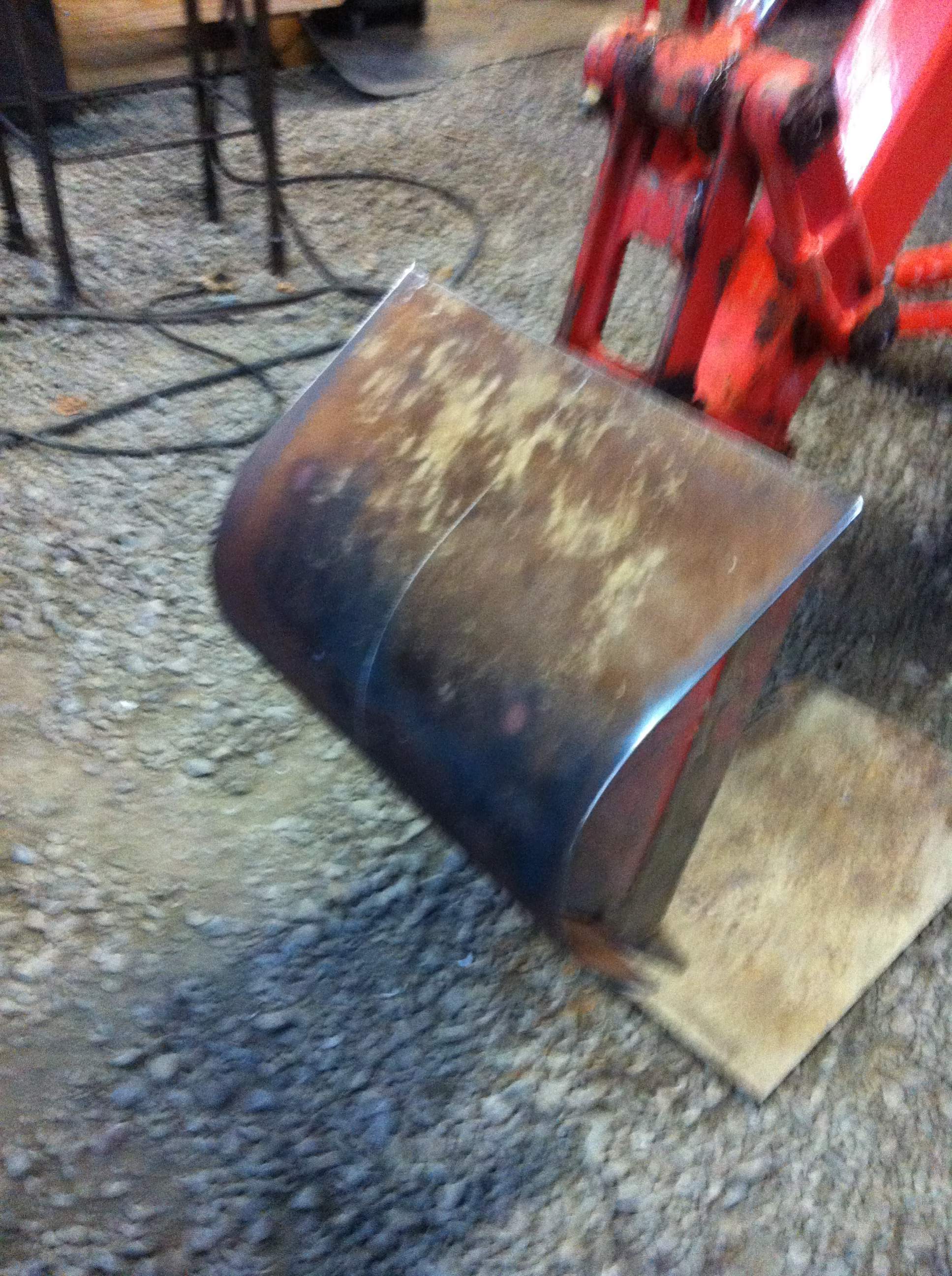

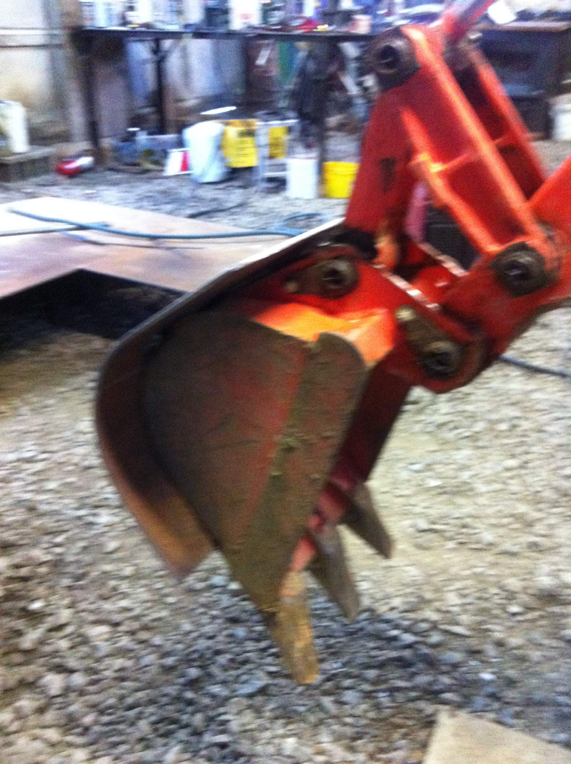

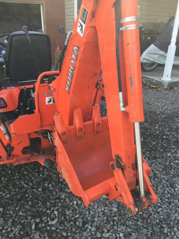

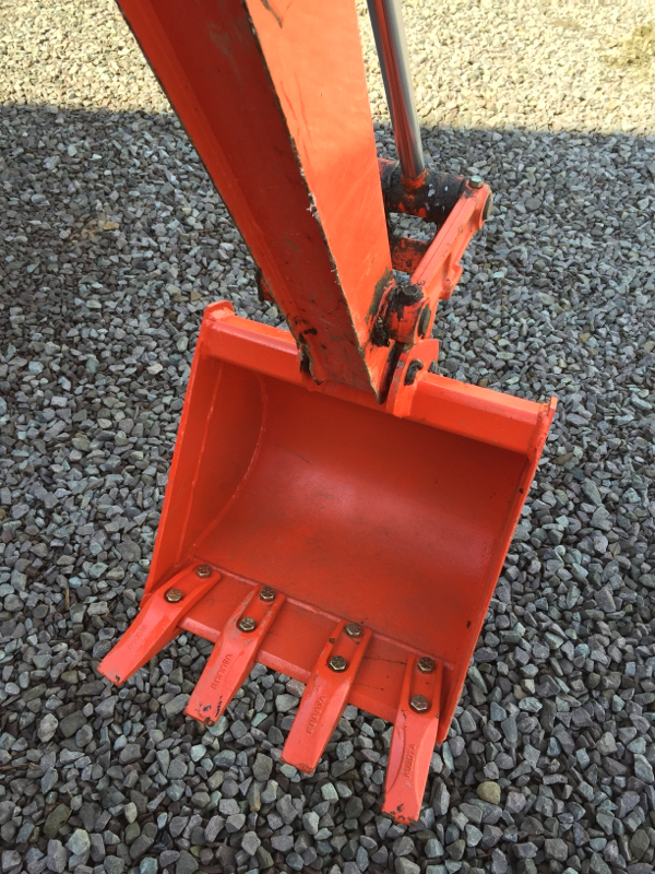

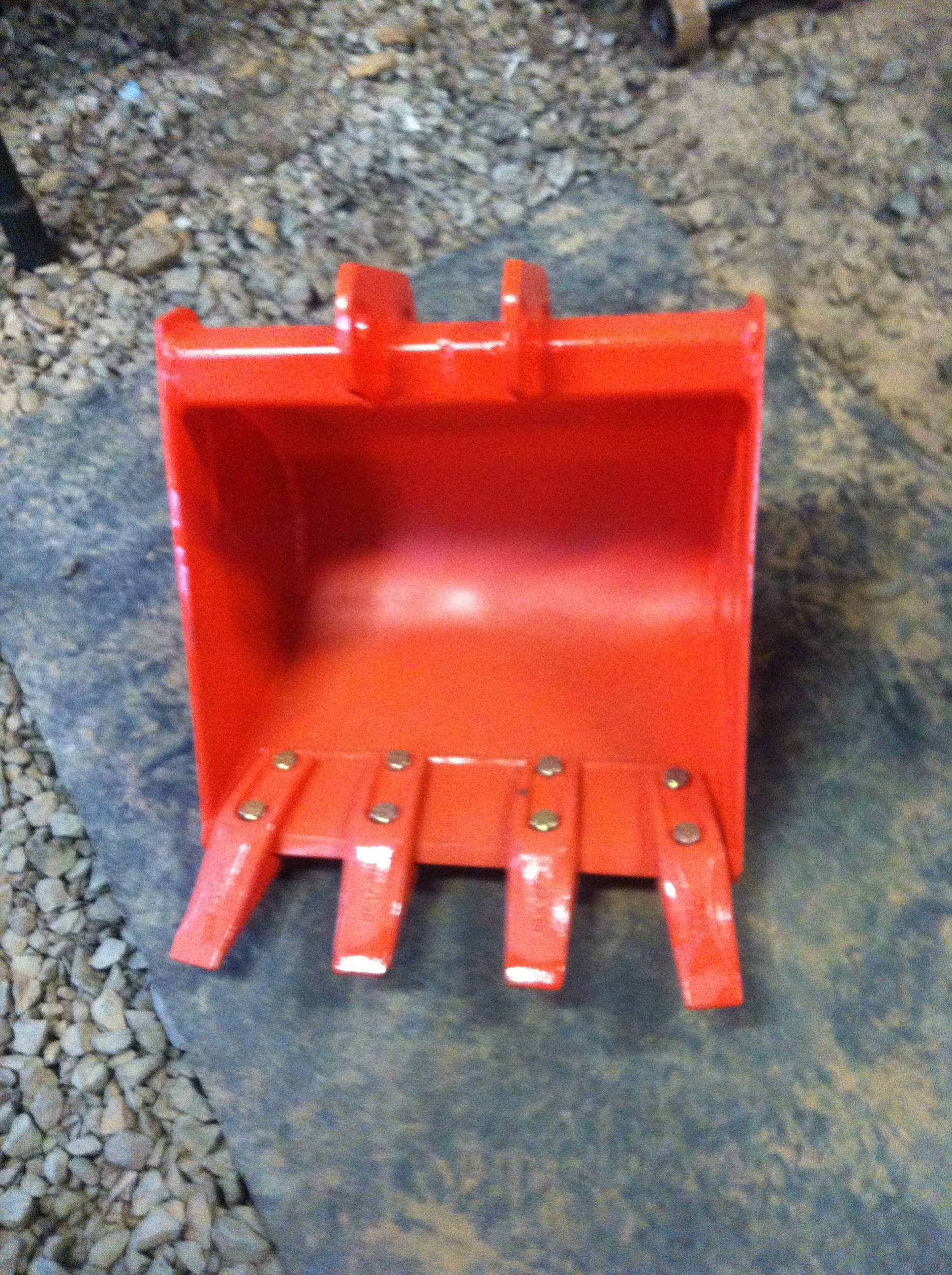

Well figured I would post this bucket I built for my BX25 I did about 3 weeks ago. I was tired of it taking forever to dig bigger holes. Only have few pics as I got to involved into the project. Sides are 1/4" high-tense steel along with the side cutting edges an the cutting edge that the teeth are bolted to is Hard-ox 450. Wasn't to bad to build I just tacked the back plate to my 12" bucket an heated an curled the bucket to get the radius. The bad part was the teeth were $34 each:eek:

It actually works pretty good. Don't have a lot of hard rocky soil. Only used it once so we shall see this summer.

Thanks. I dug out for a retaining wall in behind my pool fence an I couldn't really tell a difference from that one to the 12"

They aren't that bad to make just time consuming. What sucks is the back of the buckets are smaller then the top/bottom is. I found out after I had it curved an had to cut another back once I figured that out to get the width I wanted. I'm actually going to build a 8" bucket for that same reason this spring.

Ya I know Paul I've bin watching his videos for a couple of years. He didn't like it when someone copied his quick coupler as I seen all the drama from the posts on this site about it. It only took me around 5 minutes to change my buckets. Take out the single bolt for each pin an the pins pull out an put the other bucket on. I asked Paul why he took most of the pictures down on this site an he said that something was going on with his photo bucket account.

Ya we have some rocky soil around that's why I went with the 100,000 yield steel for the sides/ scrapers an the Hardox for the main cutting edge. I'm going to build a 8" bucket out of the same steel in the spring. I'd rather over build it then have to repair it all the time.

image-171509007.jpg image-934769932.jpg image-4194637620.jpgweather got good enough to put it back on an do some digging. The bigger stabilizer pads work great and are removable with one t bolt. image-2140072089.jpg
