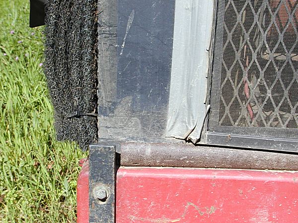

I tried several experiments with moving the surface of the filter BACK AWAY from the fan intake and found that to be an important factor in getting longer mowing times between cleanings. With the effective face of the screen moved farther away from the fan intake, the air flow at the screen is more dispersed with a lower velocity and it collects much less chaff. I settled on the nonwoven filter stuff rather than the screen - it works much better at filtering the finer chaff and doesn't get it's shorts in a bunch when I back into a tree. Try it. I bought a roll of that black nonwoven stuff used for asphault shingle ridge vent and zip tied 4 layers of it over the back of the engine house. That sets the surface about 2-1/2 inches back which is enough to practically eliminate the chaff circle. I also have the sides of the engine house covered with insect screening and I've added weatherstripping to seal the bottom edge of the engine house to the tub.
I tend to disagree with the idea of adding a bigger cooler (yeah, I had that idea once too). My experience tells me the existing cooler works fine IF IT'S CLEAN!! Keep the chaff out and all is well. My Rube Goldberg filters and screens work well enough that I've quit trying to improve on them.

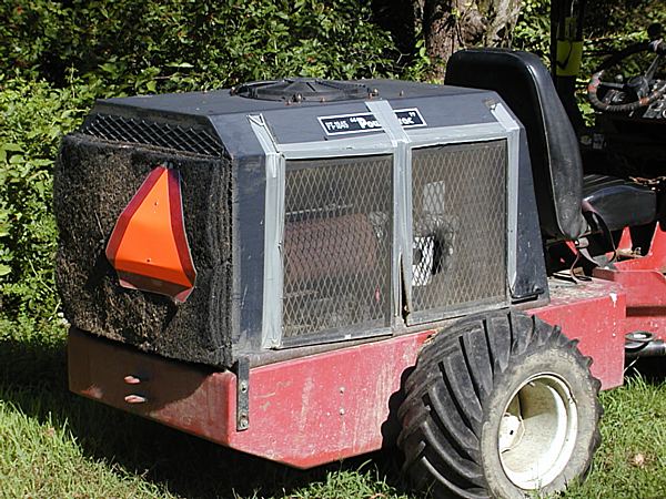

Sedgewood,
Got any pics? I'd love to see the filter set up.
   / 1850 (maybe 1845 too) - Replacement oil cooler #20
AltavistaLawn said:
Sedgewood,
Yeah, here's a couple I took this morning of a dirty tractor. As I've said, it's nothing fancy, but it works pretty well. Except for the taping on of the screening :)
There's a little more detail on my website at http://www.coxontool.com/index.php/PowerTrac/Cooling
Sedgewood
