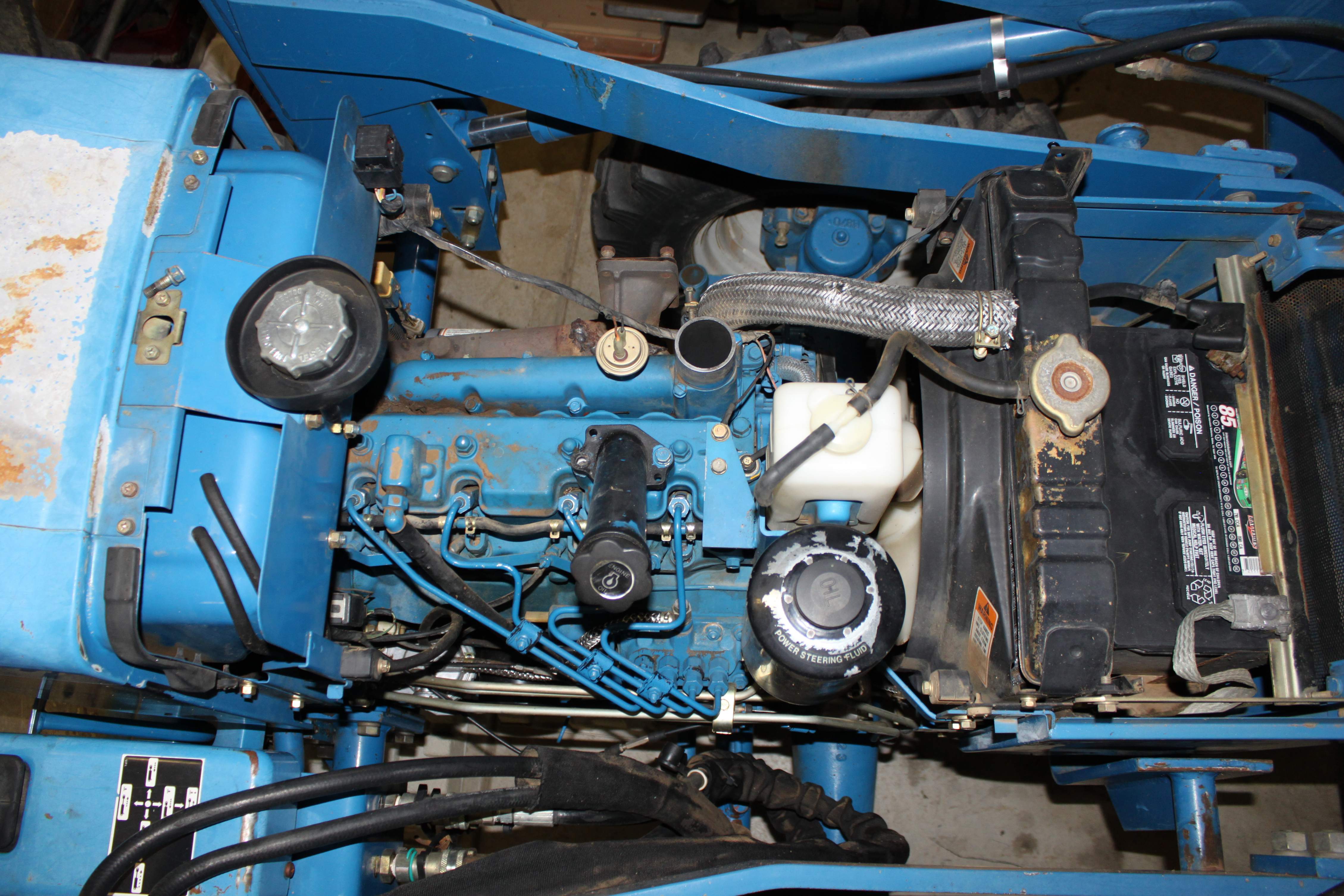

OK Group - Appreciate everyone's input on this stubborn issue but the tractor has been pressure washed and is in the garage to begin work on removing the head and seeing what it looks like inside. I will post pictures of the process, in part so we can refer back to put it back together but also to glean the collective from the group as we (myself and my tractor partner Michael). As of this AM, oil is drained, Coolant is drained and the intake manifold and exhaust stack are removed.
One of the things we'd also like to accomplish, since we are regarding this as an over winter project is to R&R the clutch and diagnose a 4WD issue. The front shaft is already removed and the clutch issue may be an adjustment issue which we'd like to go thru first before cracking the tractor in half. Ambitious we are indeed.
We have all the shop manuals and a clean garage to work in, a decent tool chest and compressor but have never rebuilt a diesel. Doesn't scare us as if you follow a logical path and outsource what needs to be, we should be fine. Where do we find the best place(s) to get parts for this Shibaura engine?

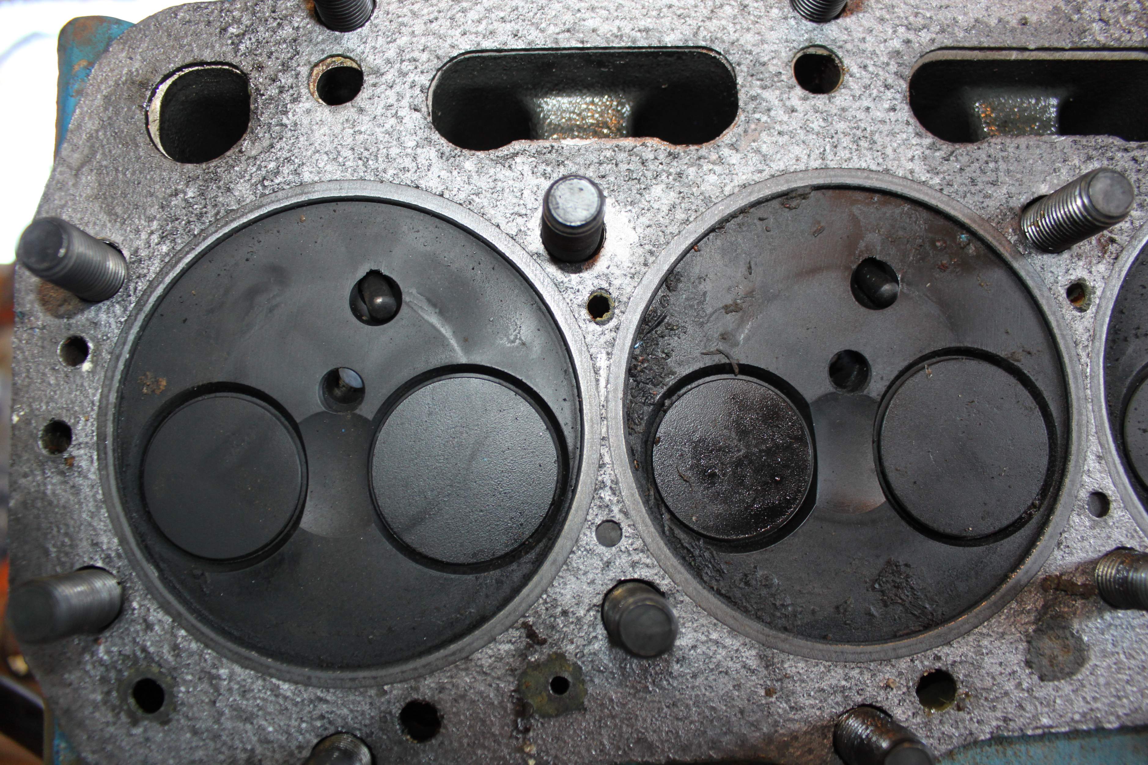

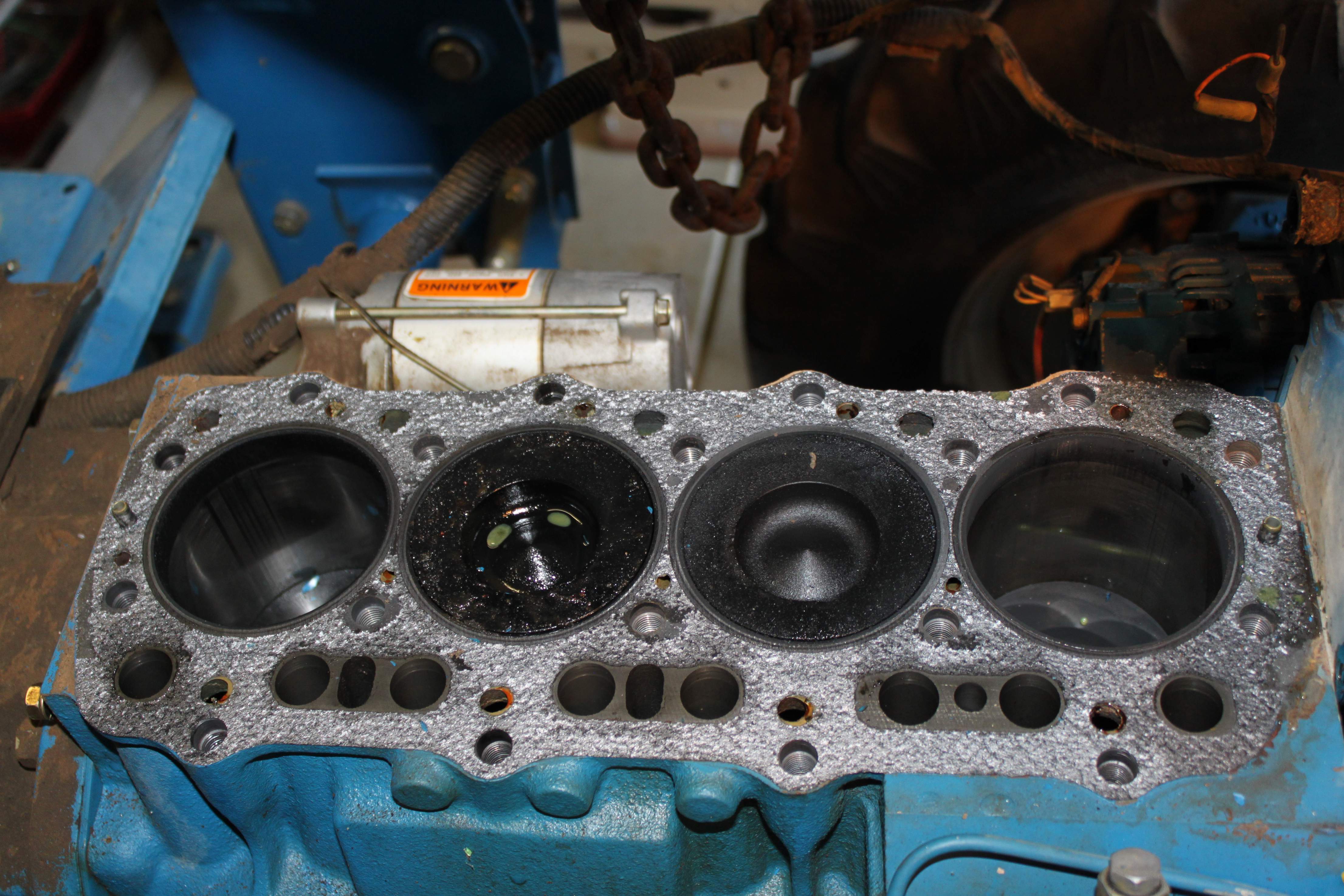

Head Removal - 1920 Cranks - Won't Fire

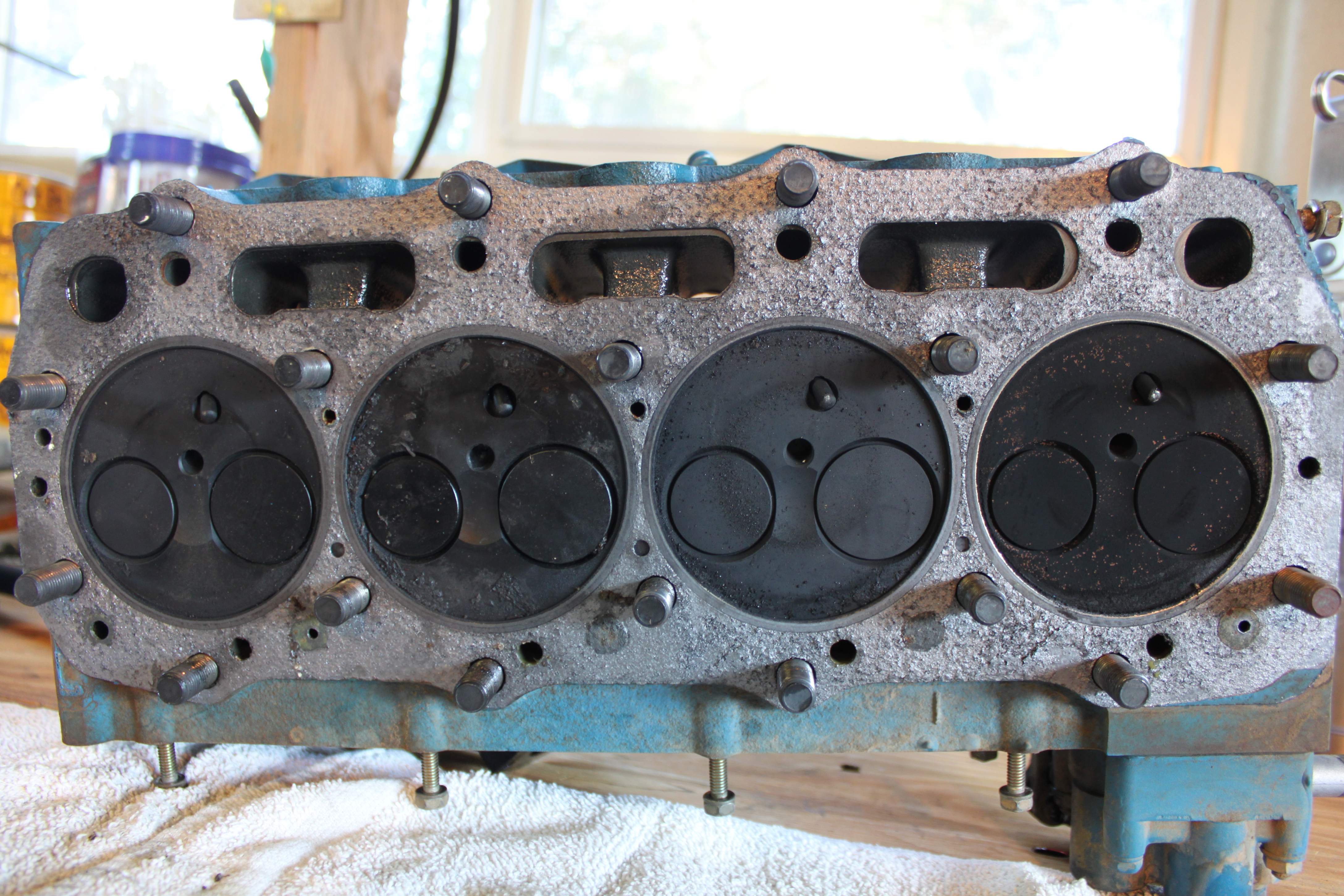

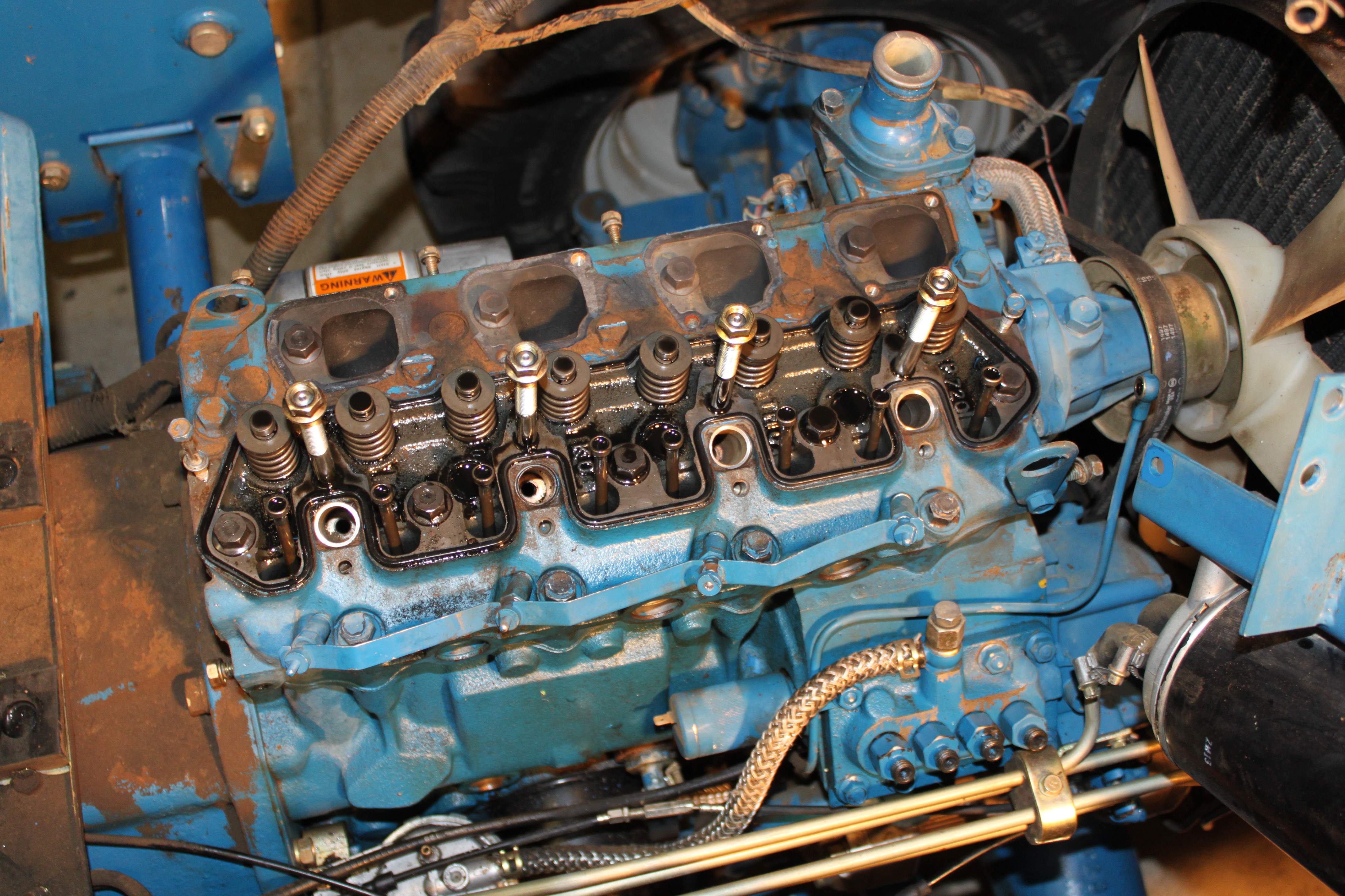

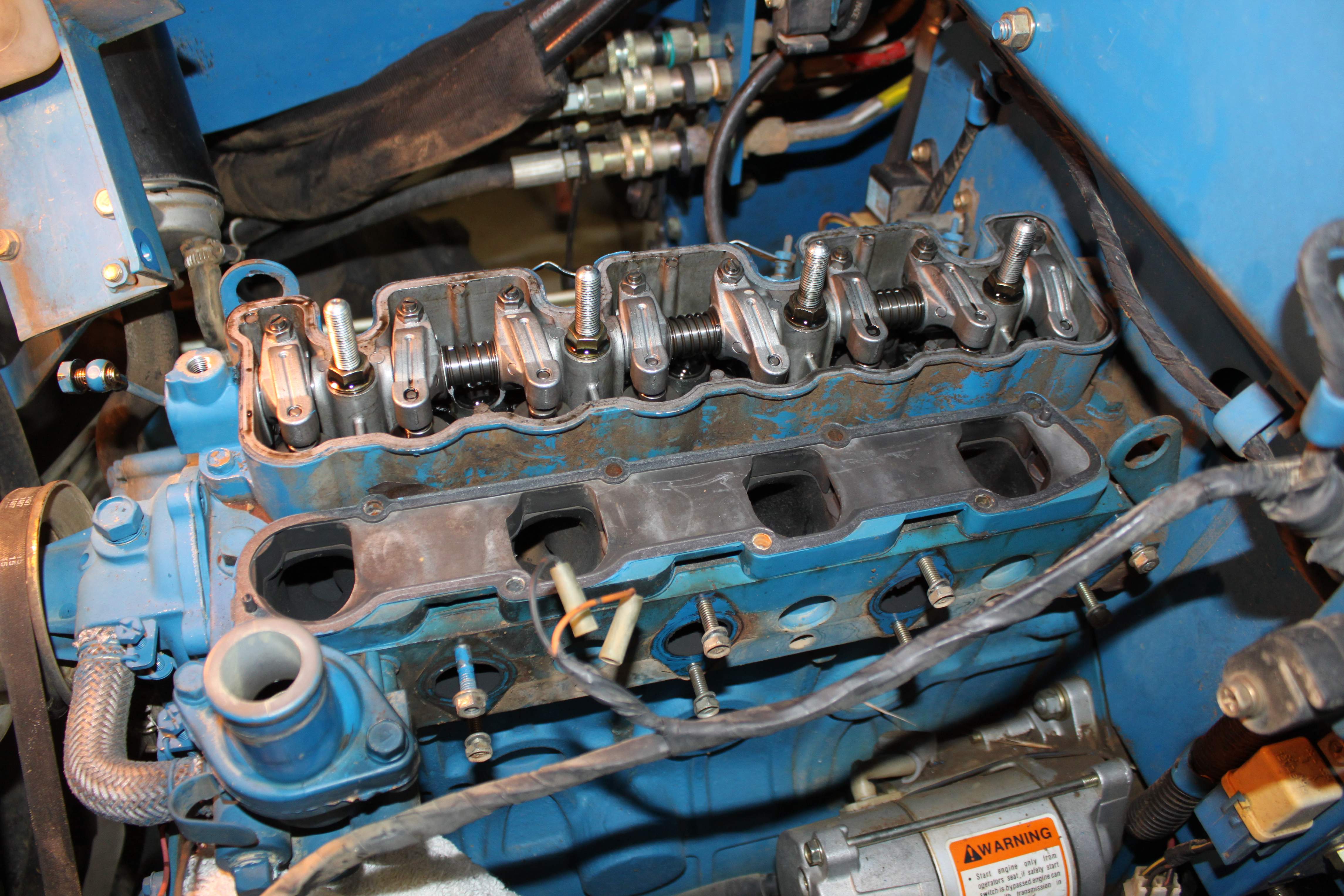

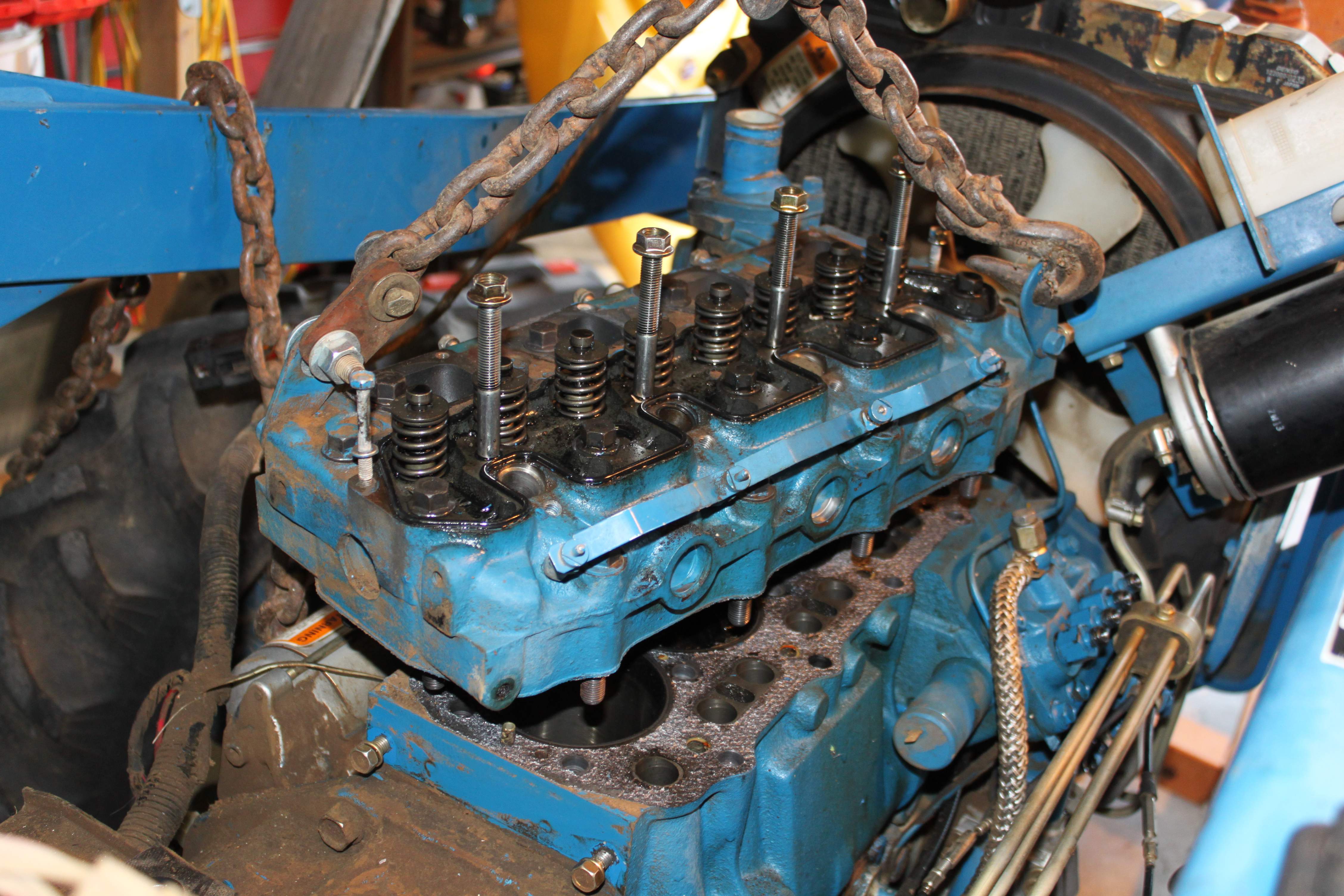

Over the course of the week I started the process outlined in the manual to remove the head. These pictures document that process. We had expected to find a blown piston, bent valve or something obvious given the state of the tractor when it ran. Curiously, there was no sign of obvious catastrophic failure. Here are my notes from the dismantling:
1. Injector #3 - The injector well appeared dirty as if the seal had failed and was not clean like the other 3.
2. The injectors themselves as indicated in the pictured are very dirty, oily in some instances.
3. There was no obvious sign of piston damage, although I did notice the inner and outer piston pairs hit TDC simultaneously making me wonder if it was just a timing issue and somehow the timing got off that was causing all the mayhem.
4. The underside of the head - Valve seats look good as do the valves. The pictures show the various build up (or not) of carbon and what not on the valve seats and compression area.

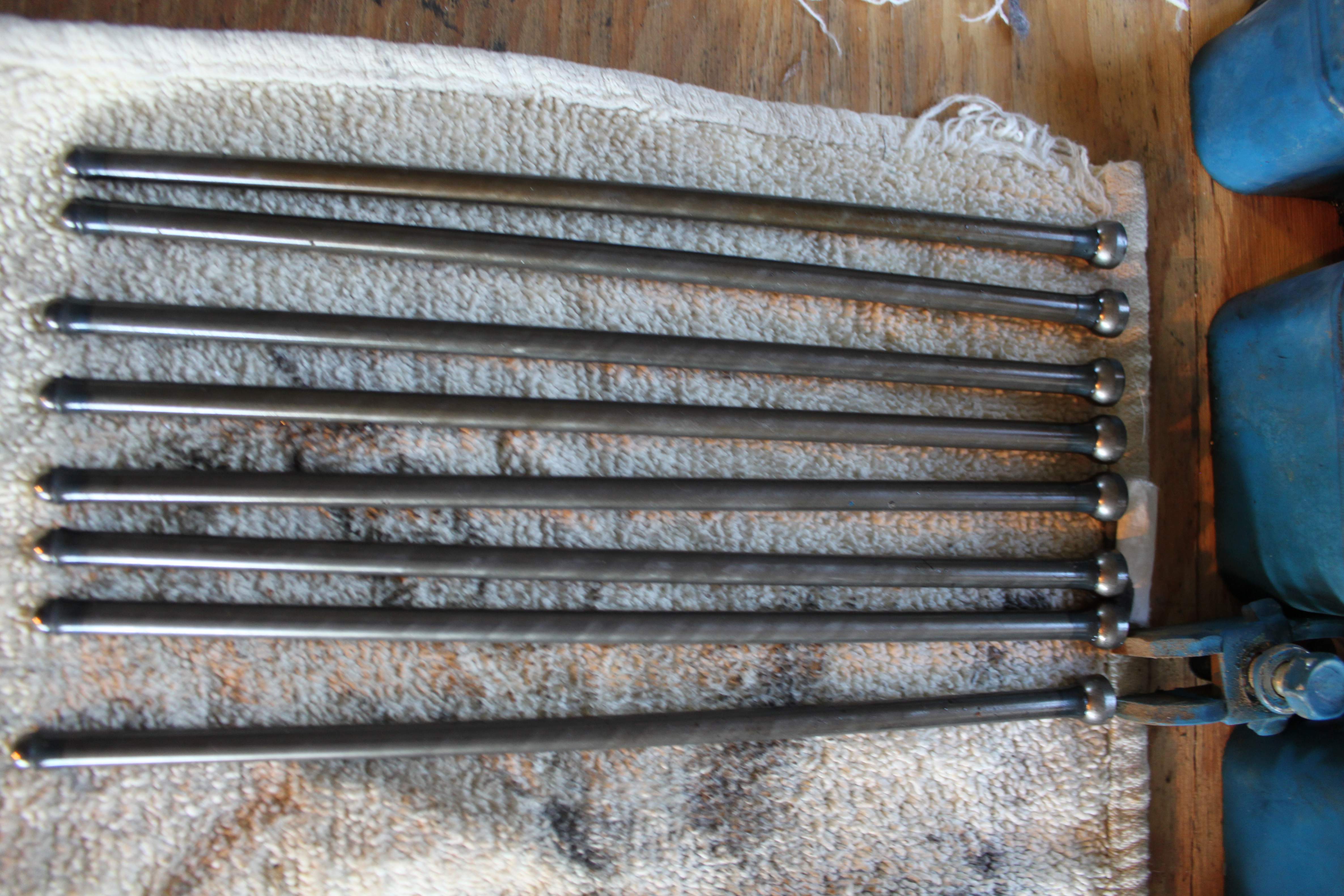

5. Push rods do not exhibit any outward signs of failure and appear straight.

Some additional notes after reviewing the pictures. Look from Left to Right, piston #2, the cylinders walls felt more scored than the others. Not gouged though. The shot for the corresponding piston #2 on the head had the most oil residue build up and what appears to be fouling of some kind. Piston #4 had the most carbon build up.
   / 1920 Cranks - Won't Fire #56
#3 cylinder is in bad shape. It appears that the rings are broke and put the groves in the cylinder walls. You will have to take the block to a machine shop to be bored. You will have to bore all 4 cylinders and replace 4 pistons.Here is a link to a place that handles Shibura parts. I have never used them I just ran across the link and saved it Industrial Engines And Parts, JT Services Inc. Perkins Diesel Engines, Isuzu Engines, GM Industrial, Wisconsin and Continental Diesel Engine Parts, Caterpillar, kWiet Power

There does appear to be more significant cylinder wall scoring on two than initial inspection showed. Dropping the oil pan to look for metal fragments and get access to the rods to remove the pistons. Couple of questions. Could we not just replace one piston ? Does it have to be all four? Could we not just re sleeve the cylinders?

Ok. Axle pulled and pan dropped. Definitely fragments from a shattered ring in the pan. Will have to pull the pistons and see if one or more is the issue, but as others have indicated, better to R&R all the rings while your in there. I'm hoping I can get away with just the rings. How do I tell if I need to re sleeve the cylinder(s)? The pistons look fine. Can I possibly hone them?

Your engine does not have sleeves. You would have to have the block bored to install a dry sleeve and then bore the sleeve to size. If it were me, I would get some one to measure the cylinder bores with a cylinder bore gauge. This will tell you how much wear you have and if the cylinders are out of round. Then decide what route to take.
