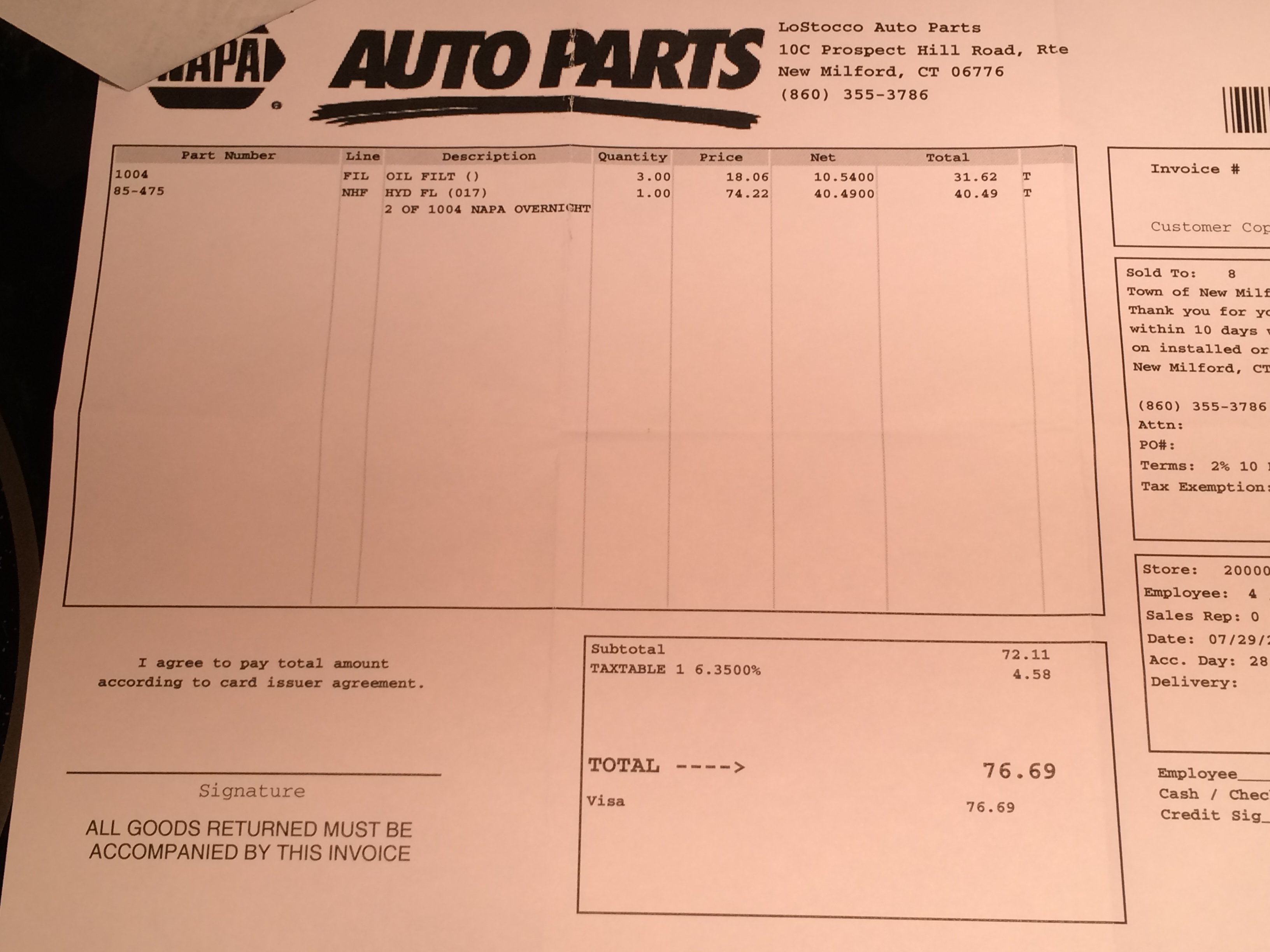

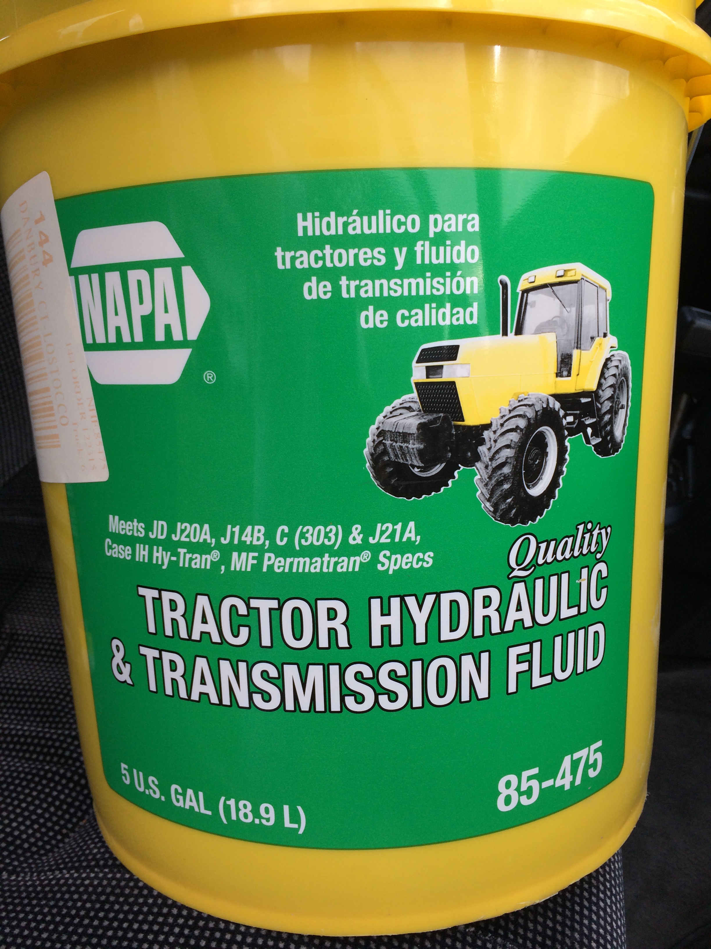

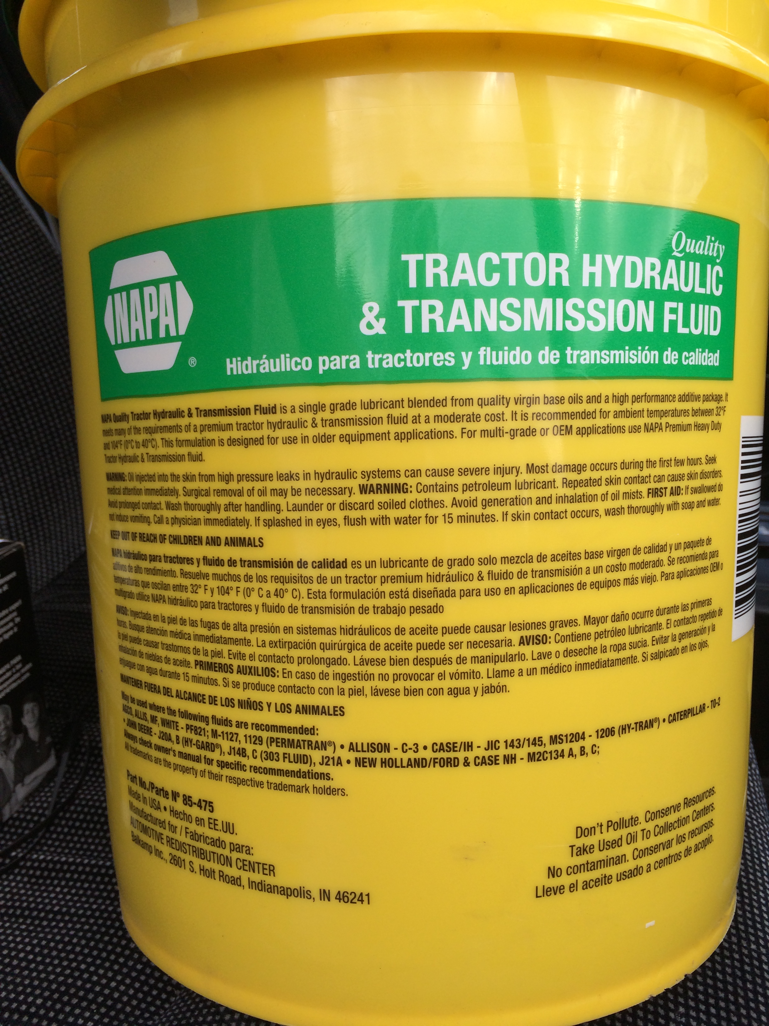

Stopped up at NAPA earlier today, they had one 1004 filter on the shelf and this fluid. Bought 'em both and ordered two more filters for tomorrow morning. Plan is to head up to the tractor tomorrow late morning but with the heat up here in the 90's the past week A/C service calls are coming in so I might not be able to get up there for a while. Sucks, Wifey and me just really want to finish off our place here, put it on the market now that apparently the administration says the housing market's at an all-time high (right, not around here fellas), sell out of CT and get the heck back down to TN.
Here's the NAPA stuff in case anyone's wondering. Could've shopped around but man I just don't have the patience right now lol... Filter was 10.54 ea and the 5gal jug of juice was 40.49
   / 1958 641 w/3 speed transmission and Sherman over/under unit #47
You did alright. With patience I can buy 303 Hydraulic Fluid for $30 per 5 gallon.
