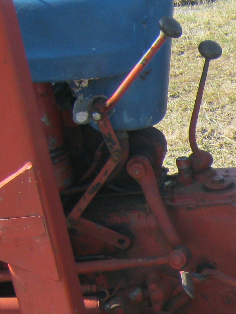

I don't think the transmission is stuck. It shifts through all the gears, and when I had it jacked up, the rear wheels moved faster when I was in a higher gear. It's still strange to me that the wheels want to turn in the wrong direction...

I didn't think anything of it at the time, but when I was testing it today, I seem to remember that the PTO shaft turned counterclockwise. Now tonight I've seen a few discussions that indicate the PTO shaft should turn clockwise. True?

DID YOU TEST THE PTO WITH THE TIRES ON THE GROUND AND THE TRACTOR IN GEAR???
I think you may have an Auxiliary Reverser Trasmission. It is a seperate trasmission that could be later added on. It would be located in your bellhousing with its own shift lever coming out the side. A reverser trasmission WOULD reverse the PTO direction when in reverse.
Just to be clear, if you have a reverser aux. trans., and it is in reverse, you would go forward if your main trasmission was in reverse (but the pto would still spin backwards)
   / 1961 Ford 4030 - Clutch Problem? #37
yep.. pics and bellhousing numbers are needed.
ps.. many of those aux trannies have a neutral position too!
   / 1961 Ford 4030 - Clutch Problem? #38
I was thinking that too SG. The aux. tranny could be inbetween gears too. That would be a whole lot better for the OP than any of the alternatives.

I think you're right - I have attached a photo. Is this the reverser?
